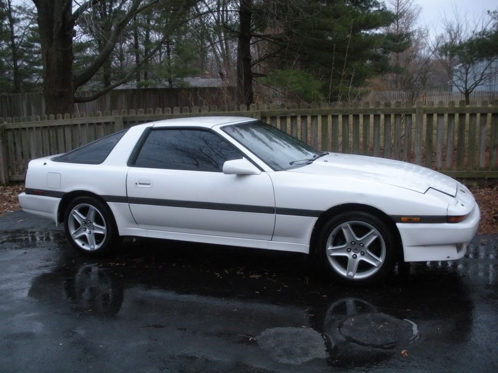

mk3concepts;1256619 said:
how would 17x9 +35 in the front and 17x10 +12 look???? with 245/40/17 in the front and 265/40/17 in the rear
A little stupid I think. You cannot lower the car much. I have 17x10 and +14 with 255 on the rear:
I'm at stock ride height.
