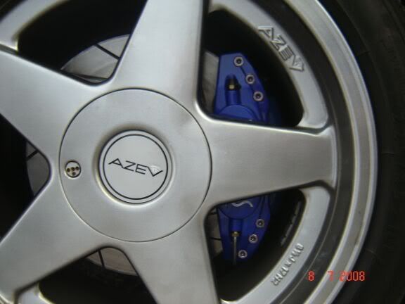

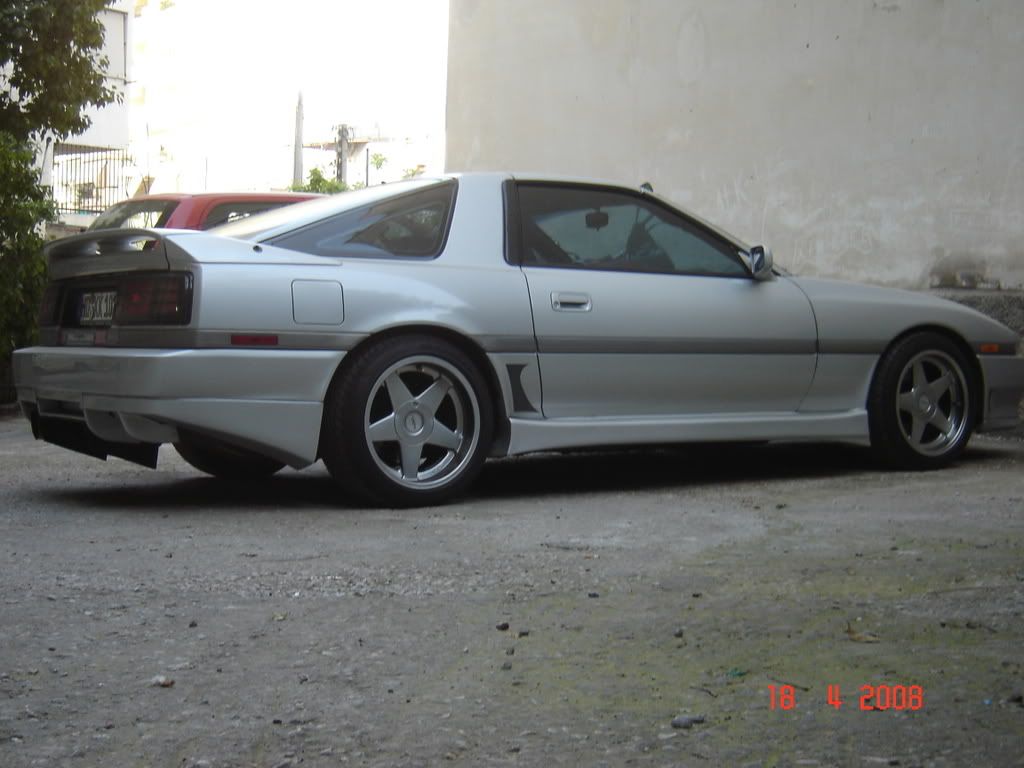

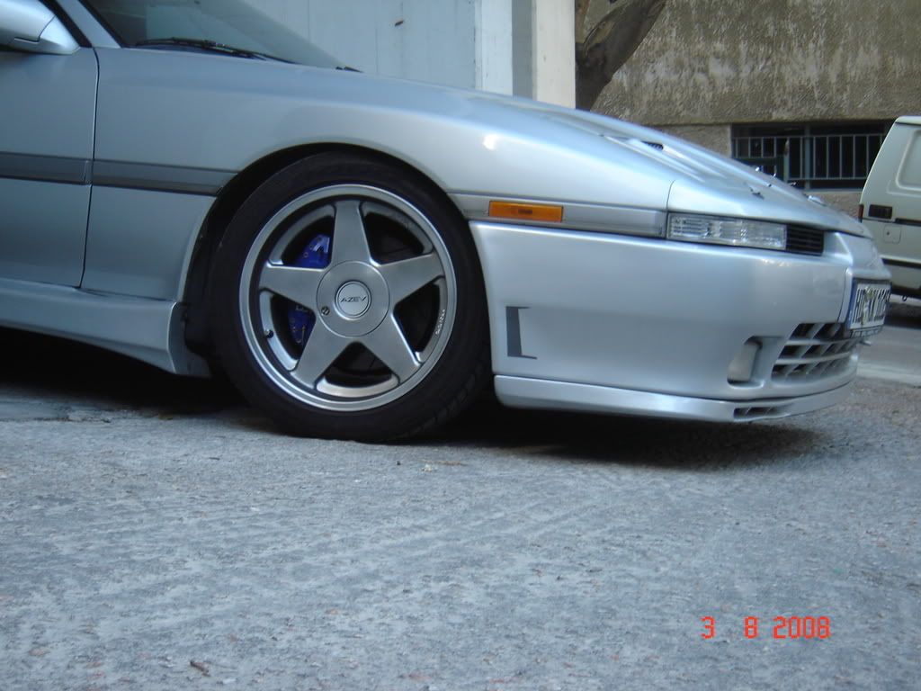

My Supra has Azev (from Germany) wheels for now :
Front 8.5' x 17' with 225-45/17' tire, Rear 10' x 17' with 255-40/17' tire.
Picture of my car:

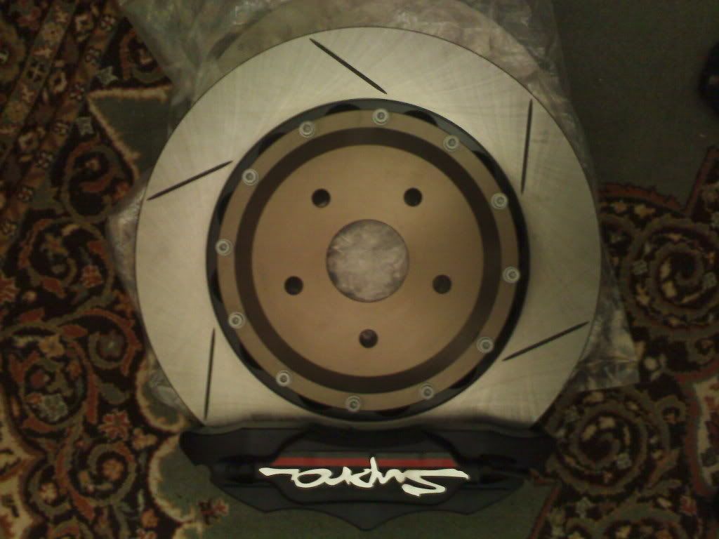

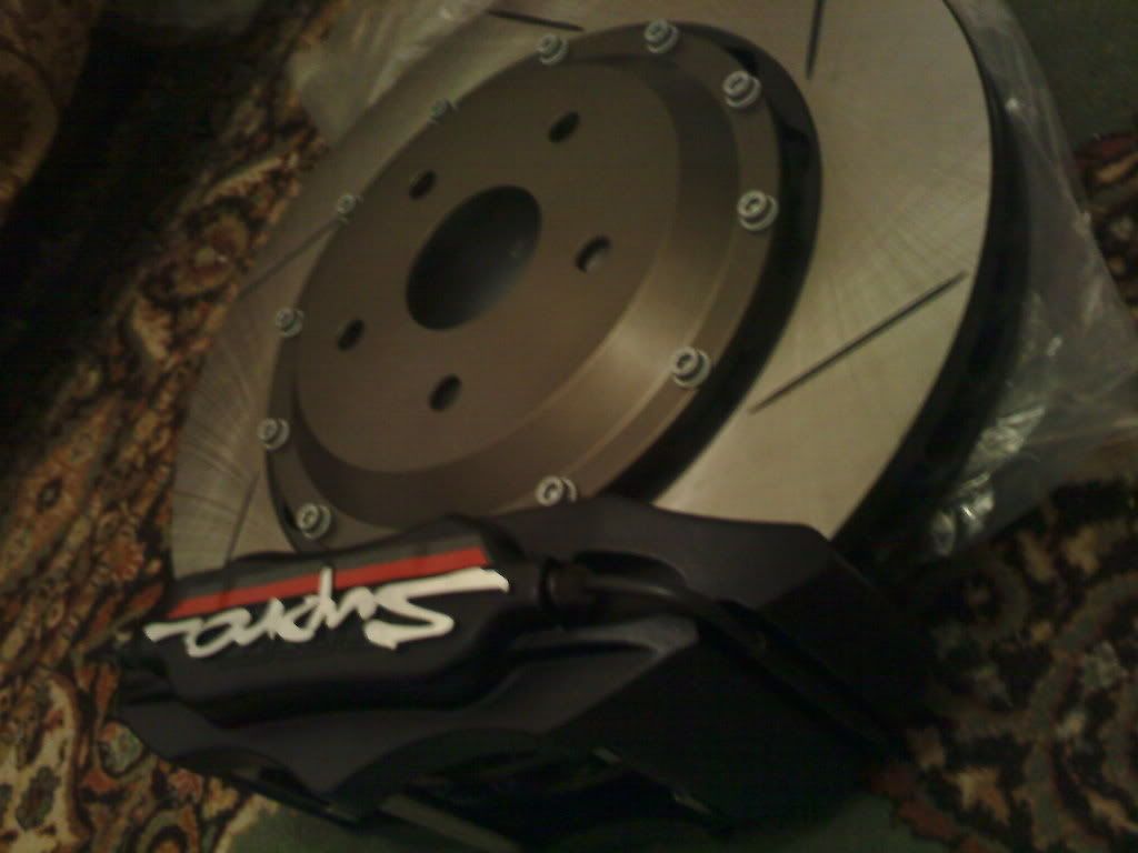

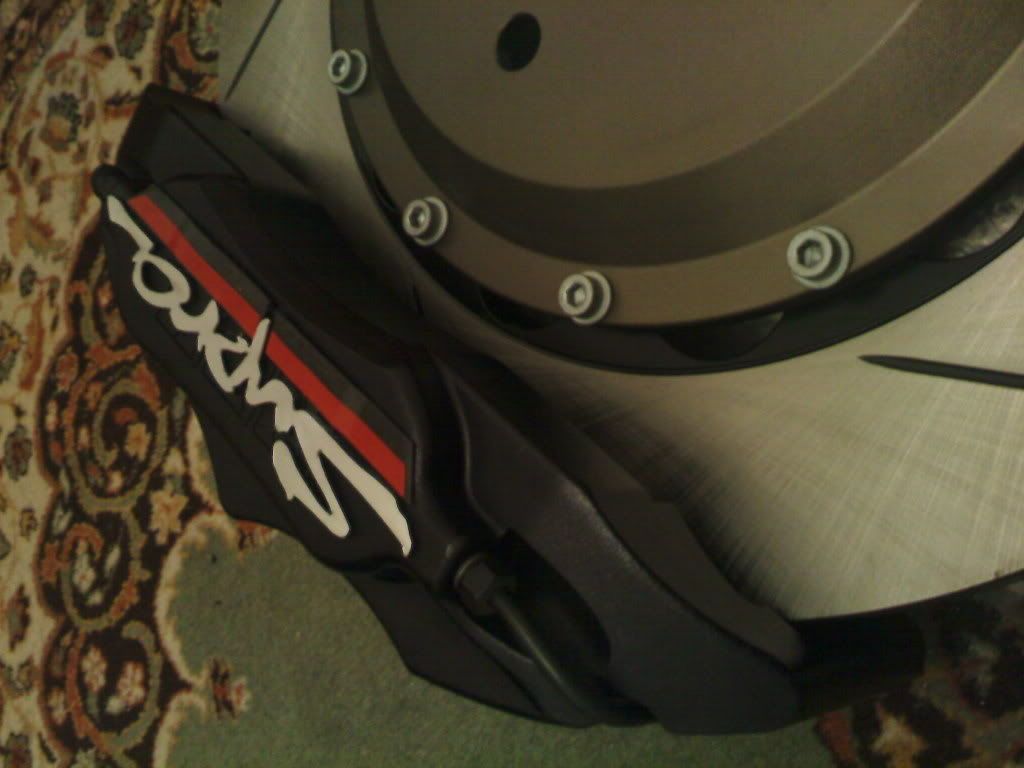

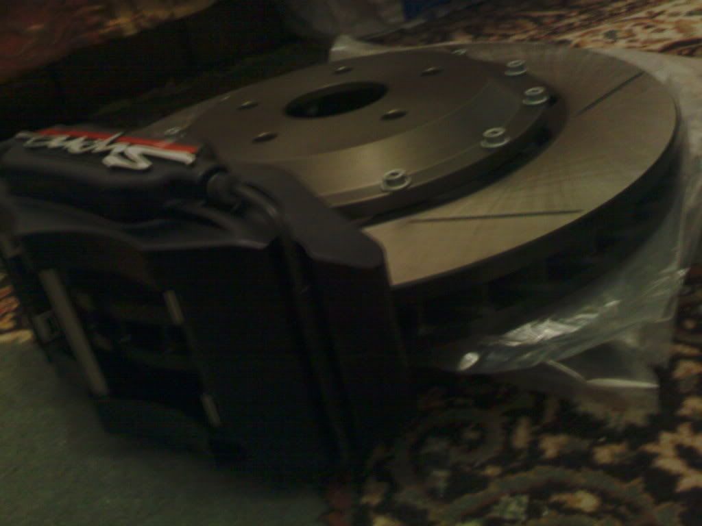

I do want to go 19' cause I sold the front brakes (oem 302mm brembo rotor with Endless 4 pot caliper)
cause I got myself a very rare new front BIG brake kit from Japan...and which I have under my bed for
almost a year...hard to find rims that I like and clear the big 6 pot 355mm (14") brakes...which were originaly made for a competition/race spec mk4,but ordered for a mk3 :
