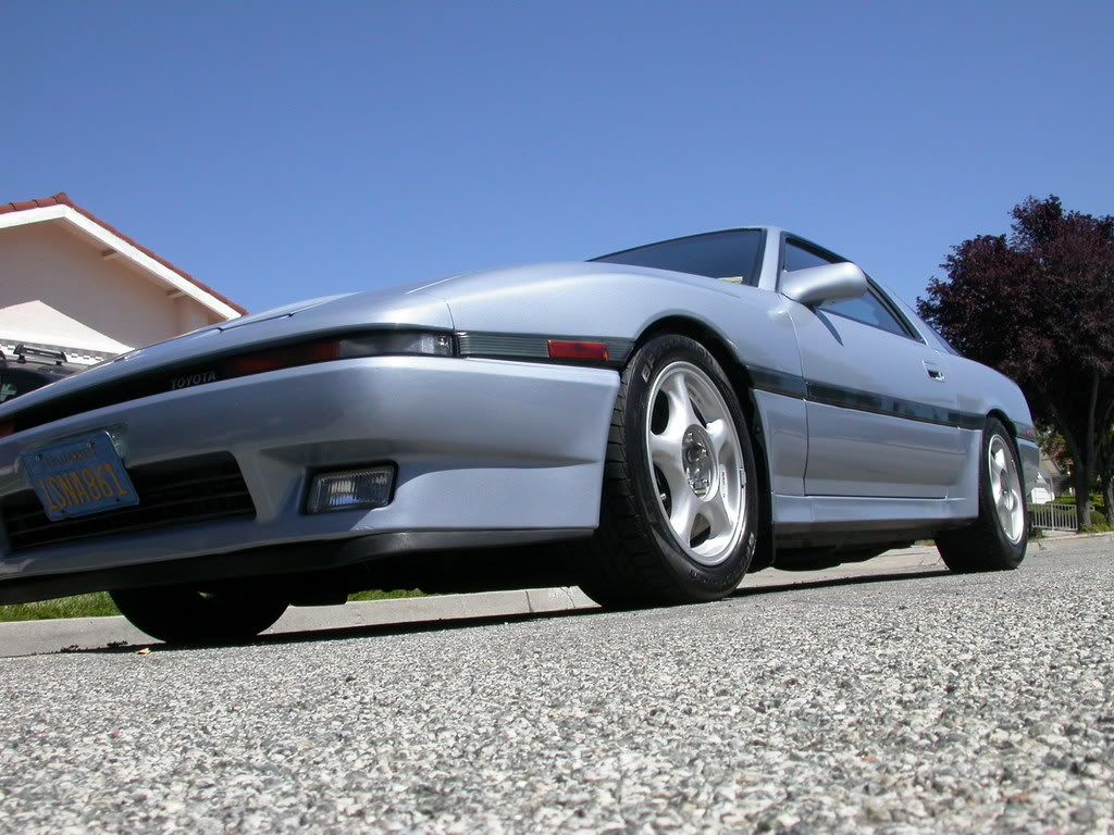

BorHor;807572 said:
MK4 NA's with spacers
16x8 +22
16x9.5 +35
Hey I was wondering what size spacers you put on with these 16X8 +50 offset. I'd also like to know if there is any rubbing.
BorHor
2JZ-GZE
Jan 10, 2006
6,181
San Jose, CA
Yeah you are right. I will have to edit that later. As for spacers I had project kic spacers 15mm in back and 20mm in front with an extra 8mm sandwich spacer in the front because I didn't think it was flush enough. As for rubbing, I do not remember truthfully but I think i might have rolled my fenders.
