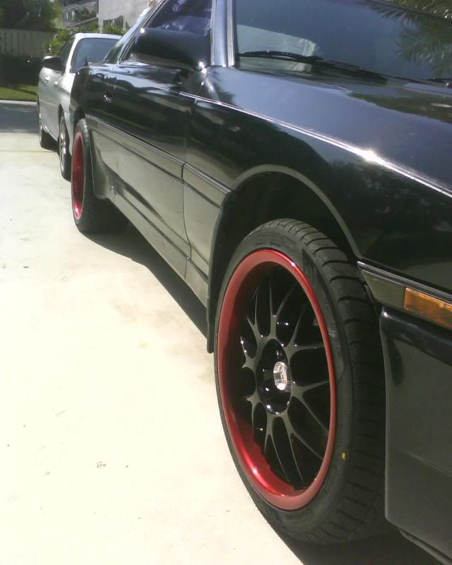

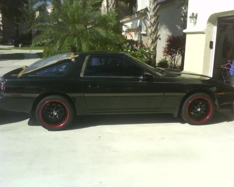

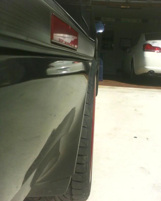

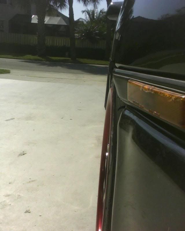

New wheels I just got. 18x8.5 in the front with a 245/35 on it and 18x9.5 in the rear with 275/35 on it. Haven't spent any money on suspension yet because my money is going towards another part of the car first. So I still have a 4x4 Supra. Sorry about the cell phone pics, my girlfriend stole my camera.
Rear wheel
Front wheel
Better picture of 4x4 action
