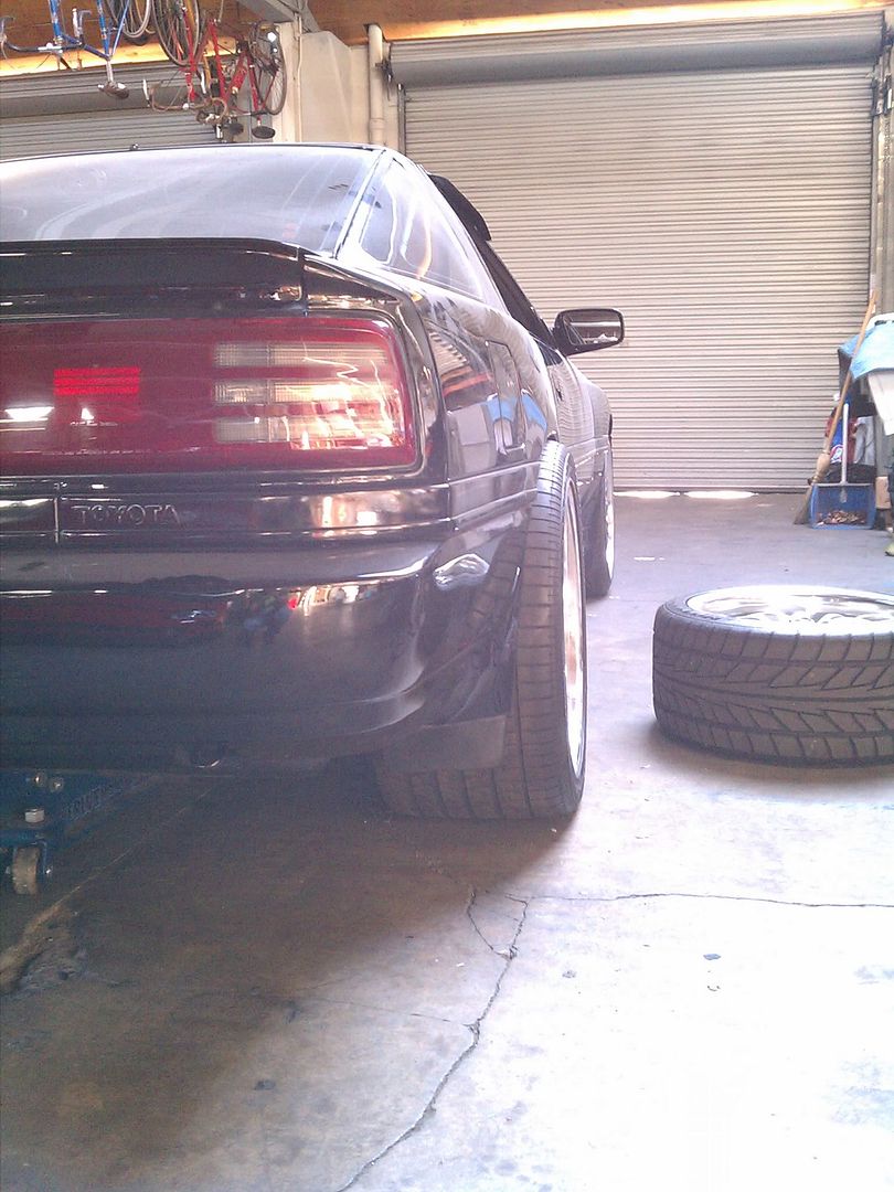

BigKO;1717802 said:
what would it take to make these fit? 18x9.5 +12 and 18x10.5 +15 i know a definite roll, but would a pull be required? And what size tires? Just curious because some wheels I want only come in this size lol. Can also consider 18x9.5 +12 all the way around. Thanks
BorHor;1722824 said:
What tire sizes were you thinking of running? That is pretty close to my RPF1 set up I had before and I ran 245/40/18 all around. Fronts were rolled flat maybe slightly pulled. Rears were rolled flat, If you pull the rear fenders you can fit a larger tire.
My bad about the late response havent been keeping up on here, but I was hoping to run a 245 up front and hopefully a 265 out back, but doesnt sound like that would work. How labor intensive is pulling the fenders? Does it require a repaint? Also, I suppose it wouldnt be the end of the world to run a 245 out back. Just trying to find a balance of "that look" and performance. How much camber were you running with the similar RPF1 setup?
EDIT: Would the 9.5 + 15 all the way around instead of staggered allow me to run the larger tire out back without pulling? If so I will probably go with that.

Becasue the offsets are on the 10.5 and 9.5 are same the tire it self is going to sit almost the same position but you will gain a bit of clearance though with the 9.5. As for pulling, if you are careful you can pull the fenders with out a repaint. A slight pull will give you enough room to run a 265. I don't remember exactly how much camber I was running since it has been years but I believe it was about 2.5*.

Here is a 325 lol
good to know, thanks for the info. Will the wheels be "sticking out" or will it be fairly flush? What do you do to pull/roll the fenders? Do you just use a roller and continue rolling until it is pulled out like or what? Sorry this is going to be a DIY thing and I dont want to fack up my car LOL
BorHor
2JZ-GZE
Jan 10, 2006
6,181
San Jose, CA
The front will be flush. Rear might stick depending on how much you pull. And yeah to pull you pretty much use the fender rolling to pull the fenders out. If you are afraid to do it there are probably plenty of people in your area that can help you out or you can even pay someone that knows what they are doing.
