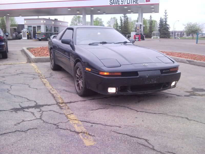

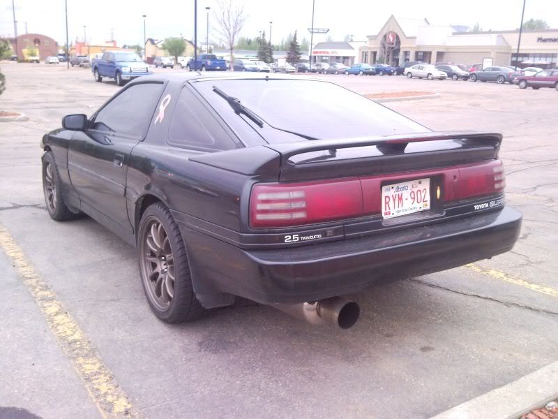

265/35 all around on a 18x9.5 +38 no spacer
IMO perfect flush fitment with the fender, no rolling, no pulling, doesn't rub on hard corner bumps. just needs to be lowered to get rid of that fender gap.
Were you in calgary a little while ago? I swear i saw you driving in marda loop, Cant be that many other Emerald Green JZA70s in Alberta. In case it wasnt you our cars are twins by the way, Emerald green JZA70s with bronze wheels haha
