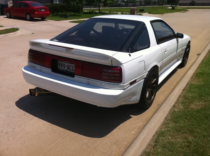

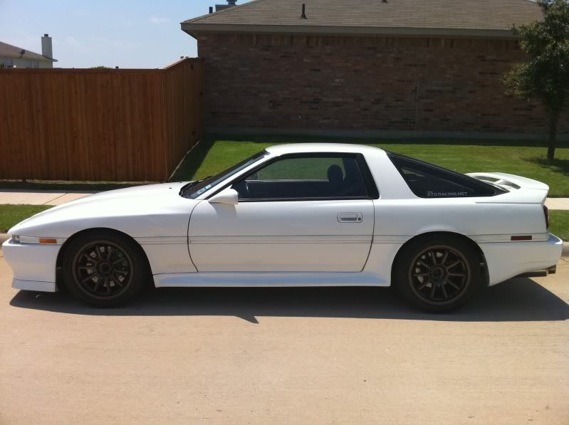

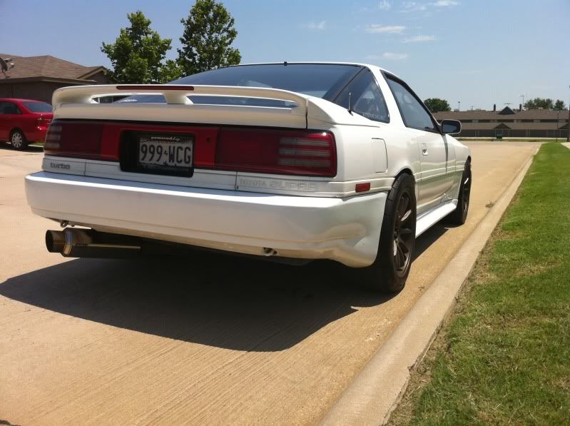

what will end up fitting/looking better out of these 3 options?
1) have rear wheels split and welded 2-2.5 inches wider making them 17x11 or 17x11.5 don't know what offset it will make them. but its only $150 per wheel + shipping.
2) order replica 17x10.5 svt rims with a 27 offset
3) order replica FR500 17X10.5 same 27 offset but with deep dish lip. sexy, yet inexpensive.
this is the look im after...
stock tt mkiv rims with 2inches added to them. 17x11.5in end of story

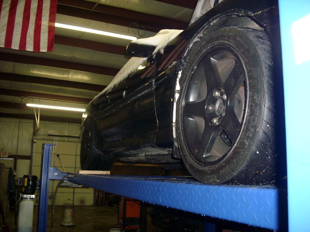

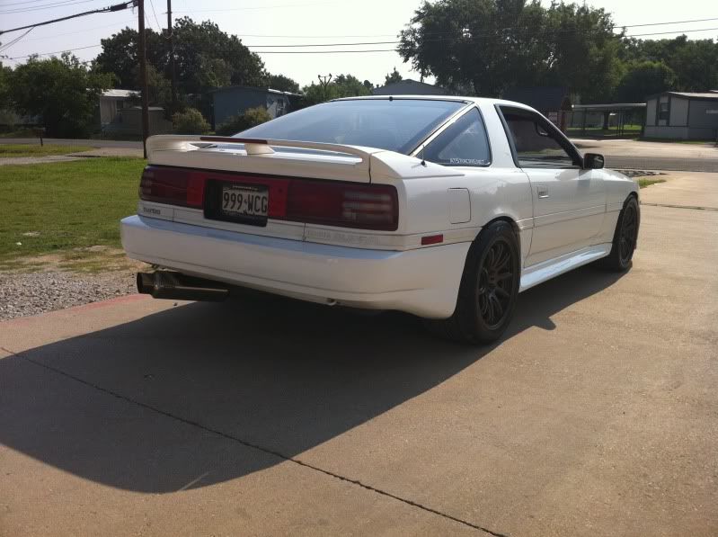

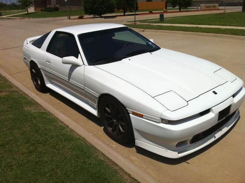

pics of current setup:
03 cobra svt rims71x9 Back Spacing: 6.02" (153mm) Offset: +26mm (1.02").

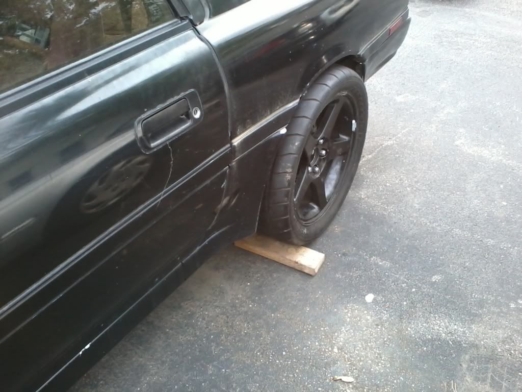

on 275
winter sucks^

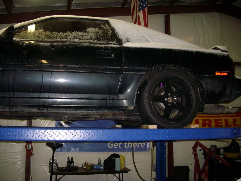

on 315
stance is off due to motor being pulled...

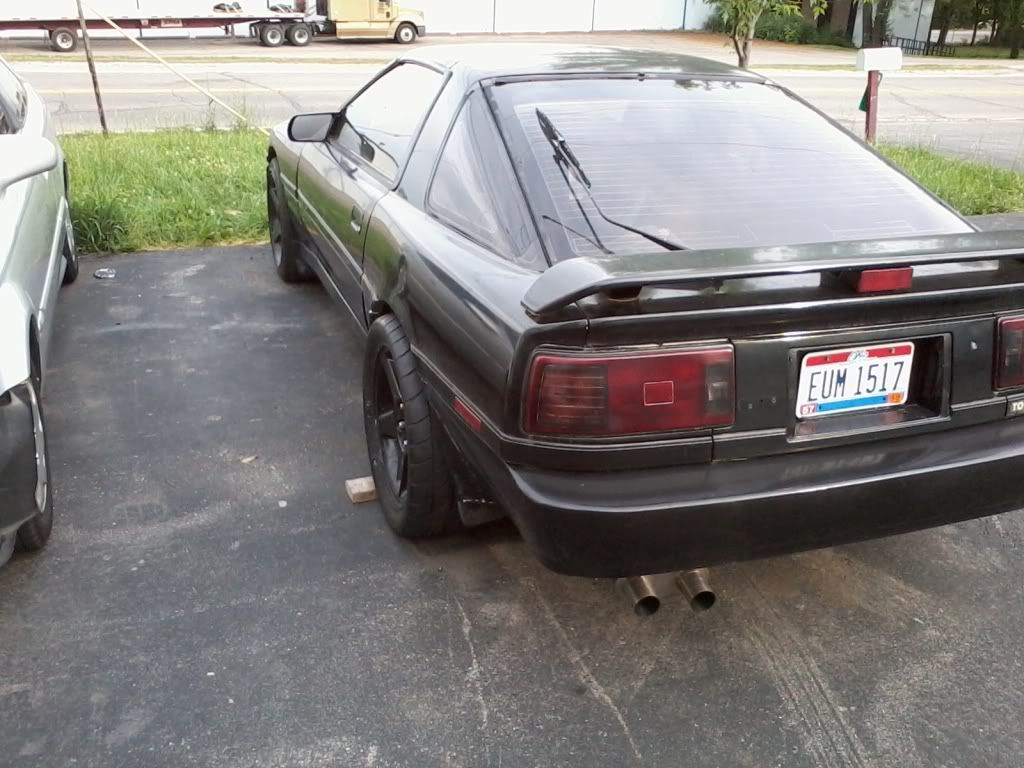

those 315's stick out too far. is there any room on the inside for a better offset wheel? i'm looking at the fr500 wheels, but i really don't think a 315 will fit under mk3 fenders. somebody please prove me wrong. lol

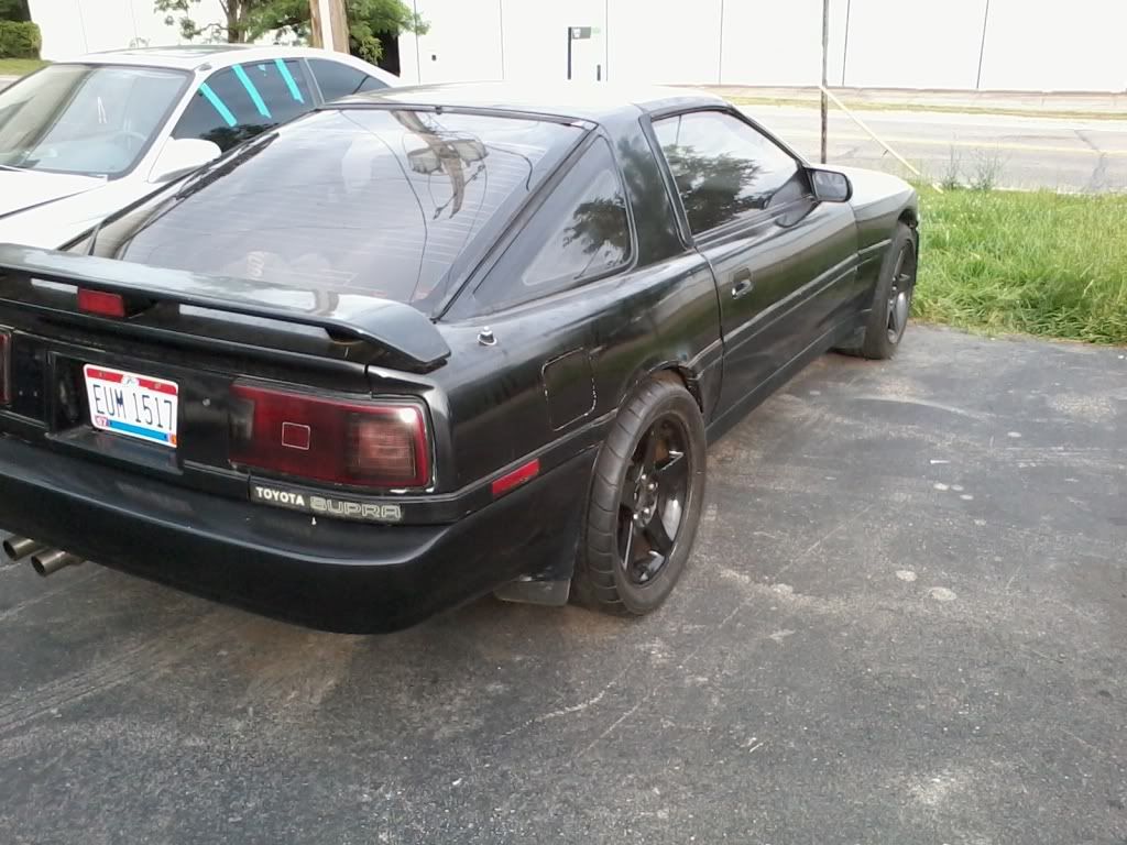

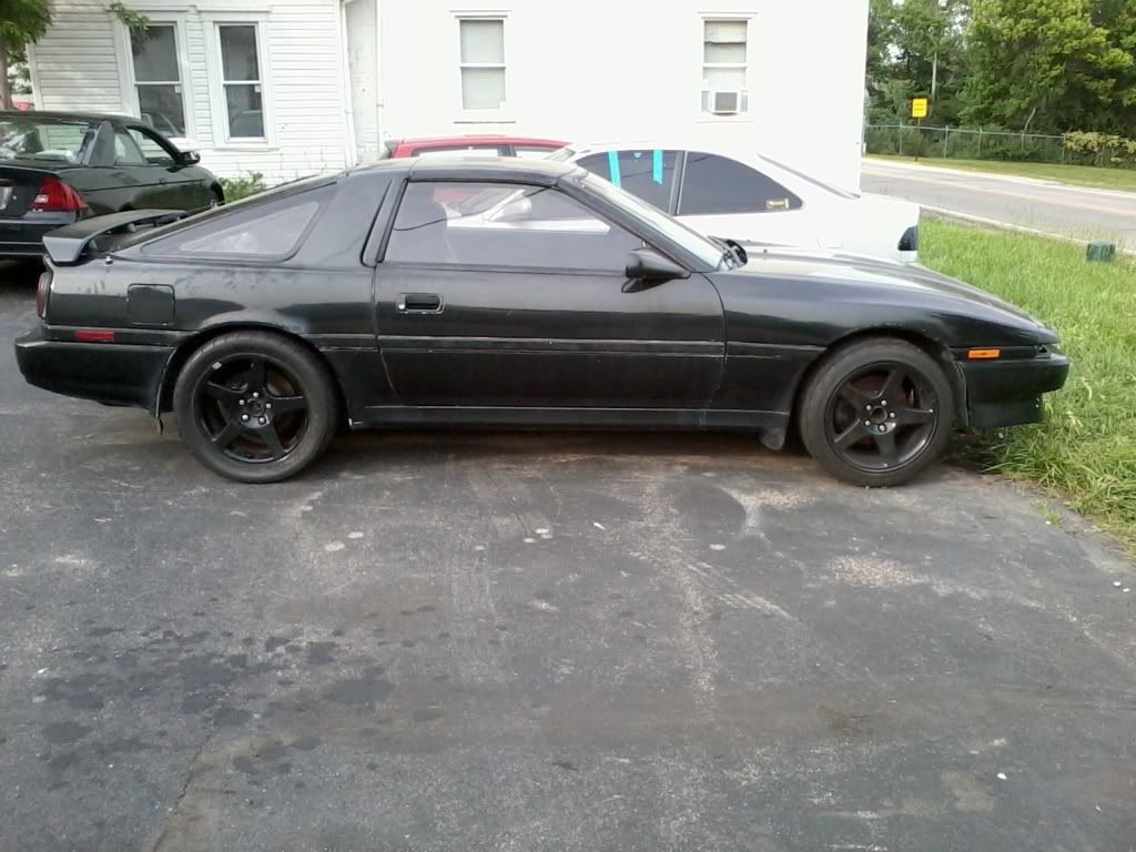

Zach90Turbo;8309591 said:
11.5 will be tough to fit. I rolled my fenders flat and am almost touching the trailing arm, shock and fender at 11 inches wide. My wheels were 9.5 and were widened to 11, I moved them flush with adapter spacers. Dunno the original offset or spacer width, just experimented. Here are some pics with 315/35/17's, speedo is not that far off.
gsxr141
Oct 24, 2010
1,158
10
rochester
love that car. i was going to run slicks and skinnies, but i think i want a setup like his. i just want to get the widest tire i can under there.
thanks for the pic.

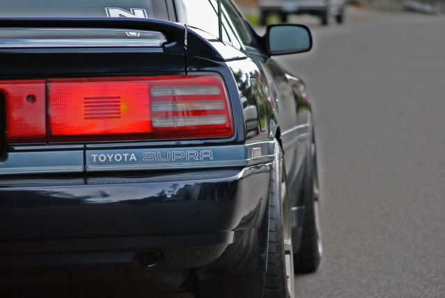

What tire sizes were you thinking of running? That is pretty close to my RPF1 set up I had before and I ran 245/40/18 all around. Fronts were rolled flat maybe slightly pulled. Rears were rolled flat, If you pull the rear fenders you can fit a larger tire.
