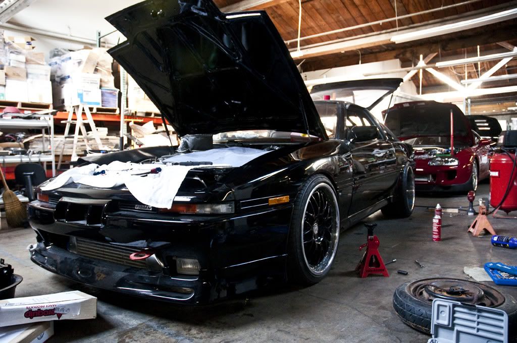

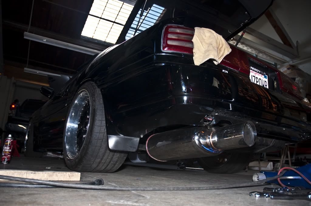

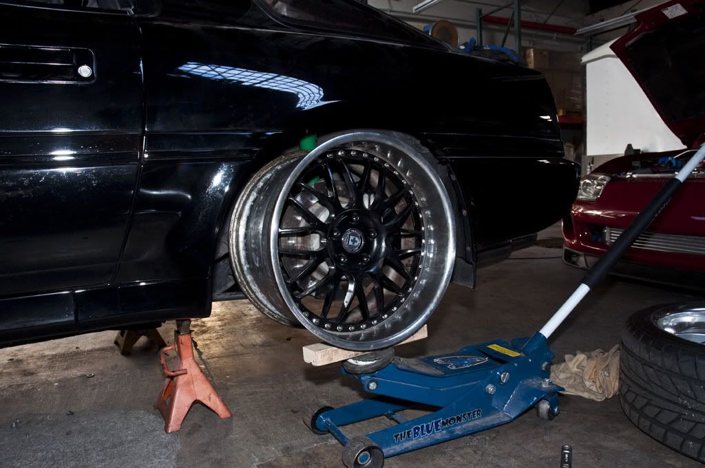

Finally had a chance to calculate out the wheel these are estimates though. What I got was 19x11.5 +33. Going to be trying out a 295/30/19 tomorrow and get that sucker to clear!
Soooooo Close!

BorHor, awesome! You bought the RHD? Can't wait to see more pics! How close are those rears to the trailing arm lol?

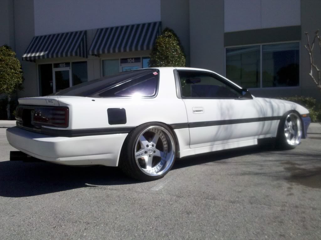

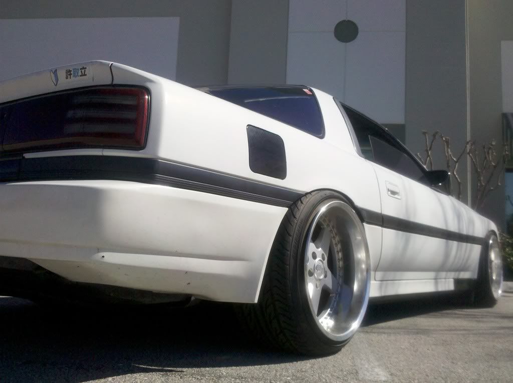

Awe gotcha! Yea maybe its due to the high cost of living in cali lol! 100 seems fair especially when you factor in the tools needed, time , and knowledge in doing it. I have seen some higher end shops that deal with high end cars charge around 500 a set which to me is nuts! lol
Anyways look at some of these wheel setups! Lookin hella flush over here! Or i like to say herra frush lol
