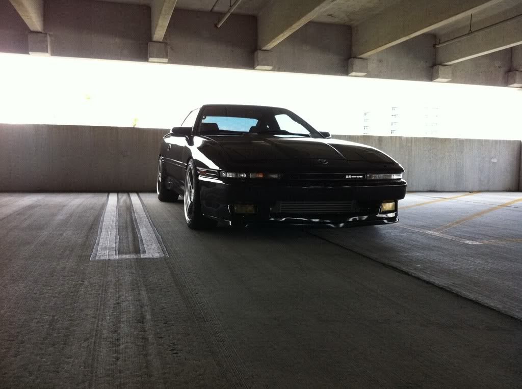

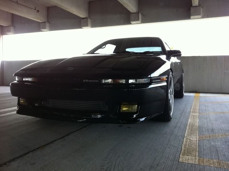

Dylan JZ;1677011 said:
I'm 18x9.5+18, and it's completely flush with less then a finger gap.. Maybe I'm missing something though.
Dylan,
In all fairness and respect, you and I have varying definitions of "flush." My "flush" is that the wheel and the fender are on the same vertical plane.
In the picture below, your rear wheel and the fender are not on the same vertical plane.
This is my idea of "flush." (At least practically close to it.) The wheel and the fender are on the same vertical plane.

Dylan JZ;1677039 said:
Lol they were +38 back then.. Spacers dropped them to +18, they are literally flush now (by your standards).
Hehehe. Let's see some updated pics!

Dylan JZ;1677156 said:
yeah, I said I'd take a few more when you told me to dry the car next time, haha.
The issue or my excuse is that the 245/40/18 on that 9.5 looks pretty lame even though the drop is decent. I'm thinking a 255 wouldn't be enough of a difference, so maybe 265? And the front 8.5s could use a 235 versus the current 225.

Dylan JZ;1677721 said:
I actually didn't even consider that.. good idea man! I got some pics btw, I'll put them up later.
EDIT:
IMG]http://i3.photobucket.com/albums/y91/TheMorningDove/5fe2f69f.jpg[/IMG]
IMG]http://i3.photobucket.com/albums/y91/TheMorningDove/b132d459.jpg[/IMG]
-didn't have the D90 with me :(
Looks flush!
