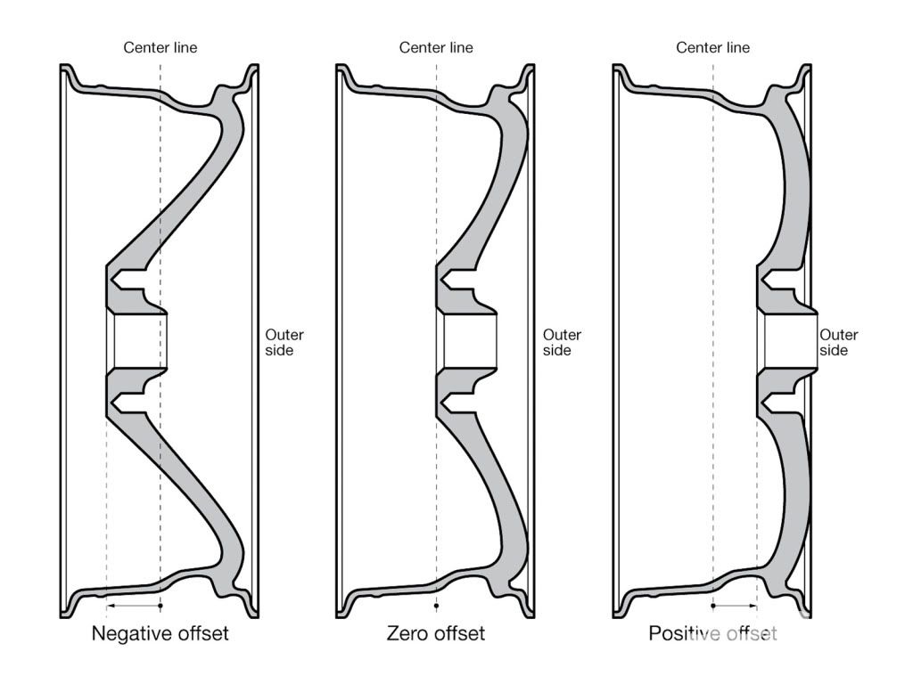

LOL. Kevin and you got me confused. Generally speaking, given that you have several wheels with the same width, the lower number (offset) the more the wheel will stick out. The higher the number, the more the wheel will go inside the wheel well).
Why don't you considering studying this below.
What is offset?
The offset of a wheel is the distance from its hub mounting surface to the centerline of the wheel. The offset can be one of three types.
Zero offset
The hub mounting surface is even with the centerline of the wheel.
Positive offset
The hub mounting surface is toward the front, or face, of the wheel.
Negative offset
The hub mounting surface is toward the back, or brake side, of the wheel's centerline. "Deep dish" wheels are generally a negative offset.
