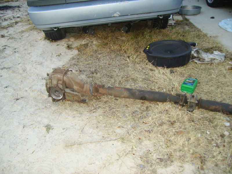

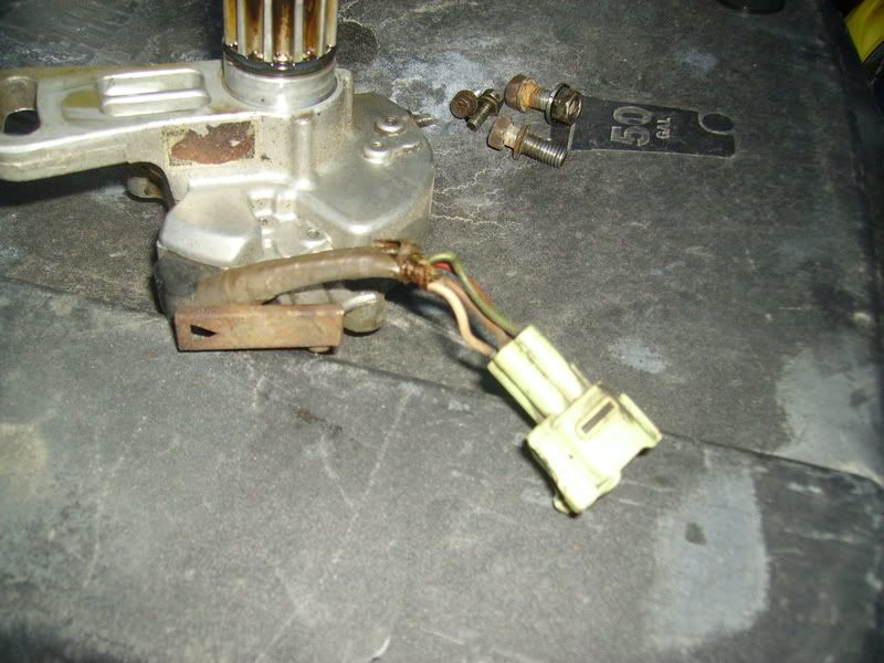

So I took that opportunity to work on the car. So much to do and didn't know where to start. I began with swapping the cps and repairing some severely frayed wiring. I cut the distributor plug off my ge harness and replaced the one on my gte harness. Then I took the cover off the cps, snapped a photo to see where it was sitting and pulled it, put the other in, plugged it in and it started right up.. Bad news is is that it still has a stumbling miss but it doesn't die when I move the cps wires around. So decided to tackle something else for a while....the differential.

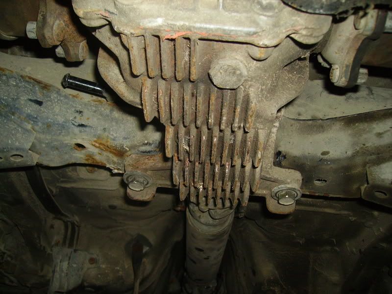

Thank God I had a impact to get those six nuts off the shafts. I got the 4.30 out and my 86.5 now officially has a 3.91 LSD!!!! It was more difficult getting the drive shaft back up and connected. My arms are so damn weak and tired from laying on my back pushing the shaft up so I could bolt it up. I can barely lift my glass of water now. My hands were so greasy so didn't get but only a few pics for today. So now all I really need to do underneath the car is put some kind of exhaust on it. I sprayed a shitload of penetrant on my na cat to remove it from the na downpipe and was able to get it off. It is longer than the turbo cat I found out, so I can put my na exhaust back on for TEMPORARY use. Then I can take it for a short TEST DRIVE....fuck yeah!!!!!
Old 4.30 now OFF the car
My son actually took this picture while I was bolting up the shaft. It's the LSD ON the car.
Old cps. My camera sux when trying to get real up close pics. I was trying to get the bad wiring to show up.
