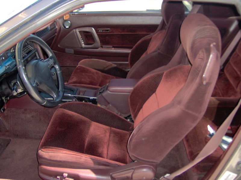

gtsfirefighter said:
The only thing different than what I was expecting was that the leather is not as soft as I had hoped for. So I have some Macquires leather conditioner that I will be applying frequently to hopefully soften them up some. I want to say thanks to reaperman for taking the time and effort to ship these heavy things to me.
So what do you think? Any suggestions on how to soften up the leather? I mean it's not like they are rock hard but I would like it a little more supple. I know I can't achieve Lexus quality. :icon_bigg
Ken just read a thread by a pro and this is what he used results were very good on dry leather. I use saddle soap myself buy always looking for better methods. :naughty:
"Leather cleaned with Woolite diluted 4:1 and scrubbed. Dressed with Lexol Conditioner x2 and Four Star Ultimate Leather Conditioner x2"

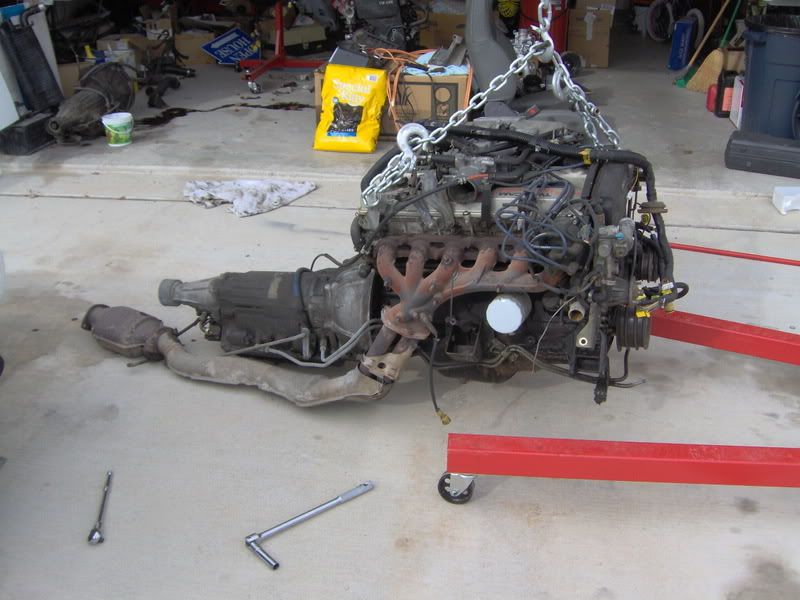

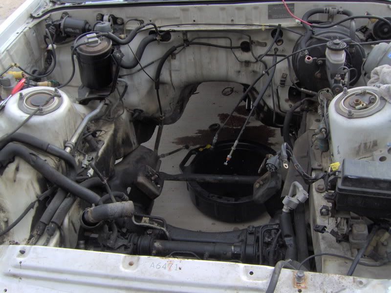

Well I made some actual progress today. Instead of f-ing around with the speakers I finally got the motor ready to pull. All it needs now is a chain on the hooks and some lift. I put the ass end up on jack stands, removed the tranny mount, speedo cable, and last ground wire. I also disconnected the exhaust but I had to do it on the backside of the CAT. I have to wonder if that's not the original exhaust. The bolts just broke off. Also diconnected the carrier bearing.
I was smart this time and drained the transmission so now I won't have a bloody mess all over the driveway like when I pulled the motor from the blue one. Surprisingly, the fluid was very clear and clean looking. I have to work tomorrow so maybe Tuesday I can at least have this one pulled.:x:

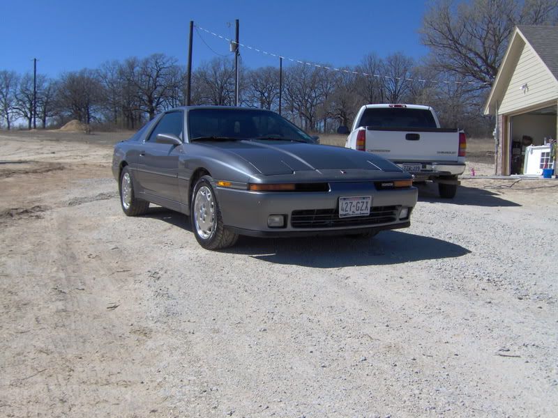

So what's the paint code on the Supra in the front page (Copper like color (Or I'm color blind))
You're color blind my young friend :biglaugh: It was grey. I don't know the paint code. Here are some more pictures of that beautiful NA. God what was I thinking selling that car???? Scott, you can STFU! Don't want any I told you so's!!!!:icon_razz

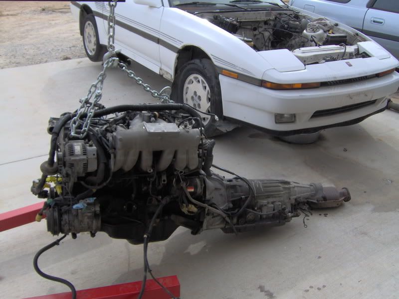

Ok, first off I'm going to have to rant:rant: WARNING-Foul language ahead.
If you tell somebody you are going to go over to their house and help them do something and you later decide not to or something comes up, for God's sake have the fucking decency to pick up the damn phone and call them to let them know. My douchebag friend (same friend in post 46) that I work with on shift told me yesterday and this morning when we got off work, he'd come over to help me pull the motor from my car. He was going to be down my way giving another friend of ours some tropical fish. Well after waiting hours I called the other friend to see if he had heard from Douchebag, and to my (not)surprise, Douchebag is over there. Mo-fo never bothered to call.
Anyway, with a little bit of help from my wife, and I do mean little bit (she hates my car), I got that SOB out of there.

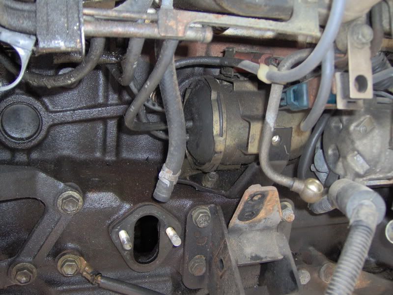

I found something interesting that I haven't seen before. It's not a fuel filter. I've never seen a vacuum canister there before.
Ok, for multiple reasons, I am very pressed for time to get the other motor in so I am not going to mess around with trying to clean up the engine bay right now. I'll just have to do later on sometime. Right now I just don't give a damn.
