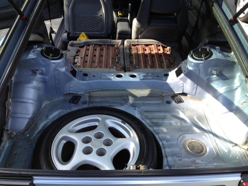

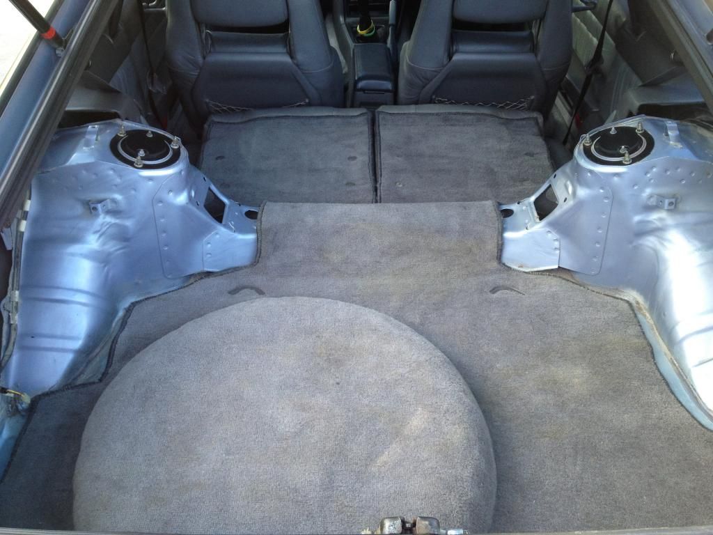

Full size spare and 89+ rear carpet in

Ewww... Nissan parts. :p
Nice carpet though, from what I understand, that was only available in the JZA70. Picked up one myself a few years back. Really opens up the rear for cargo, although you lose the stock board/carpet padding sound deadening.

Very nice, I have wondered if my 91 MK3 comes with a full size spare.
They all do sir. One can even fit a bald 275/40/17 in there if need be, although it's snug. Used to do that to put more weight on the rears during winter.

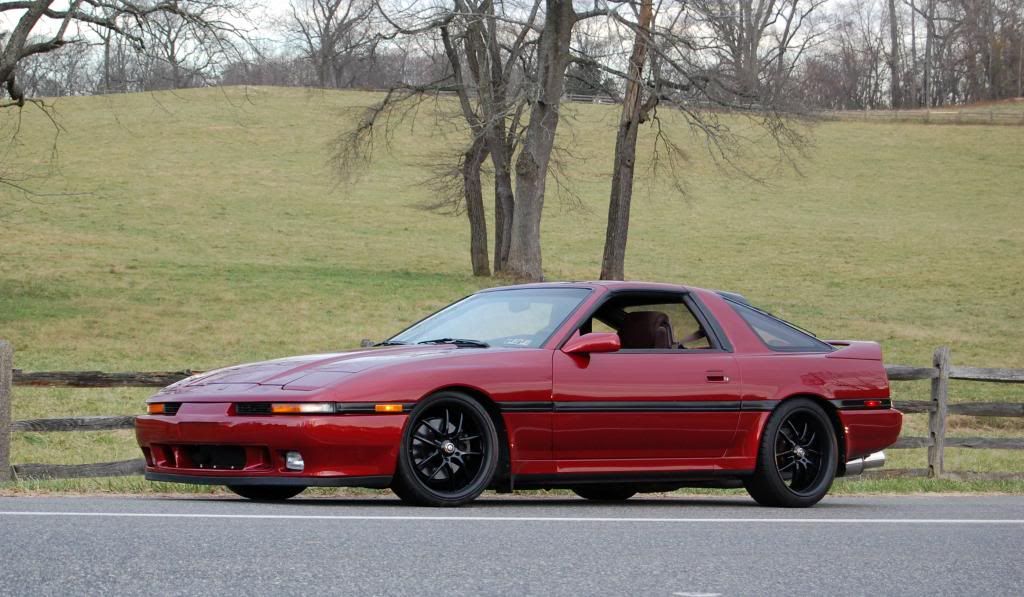

Took a picture
Nice looking car man! Is your roof a darker burgundy? Or are my eyes deceiving me?

The factory full size spare is actually a 205/55R16, which is the same rolling diameter as the 225/50R16 tire. (I used to use the 205/55R16 as winter tires, since the narrower profile works better in the snow.)
My '89 came with a board in the rear lifting the floor about 2.5" off the steel, and laying flat over the spare. If you put a real full size spare (225/50R16) in there, the false floor wouldn't sit all the way down correctly.
