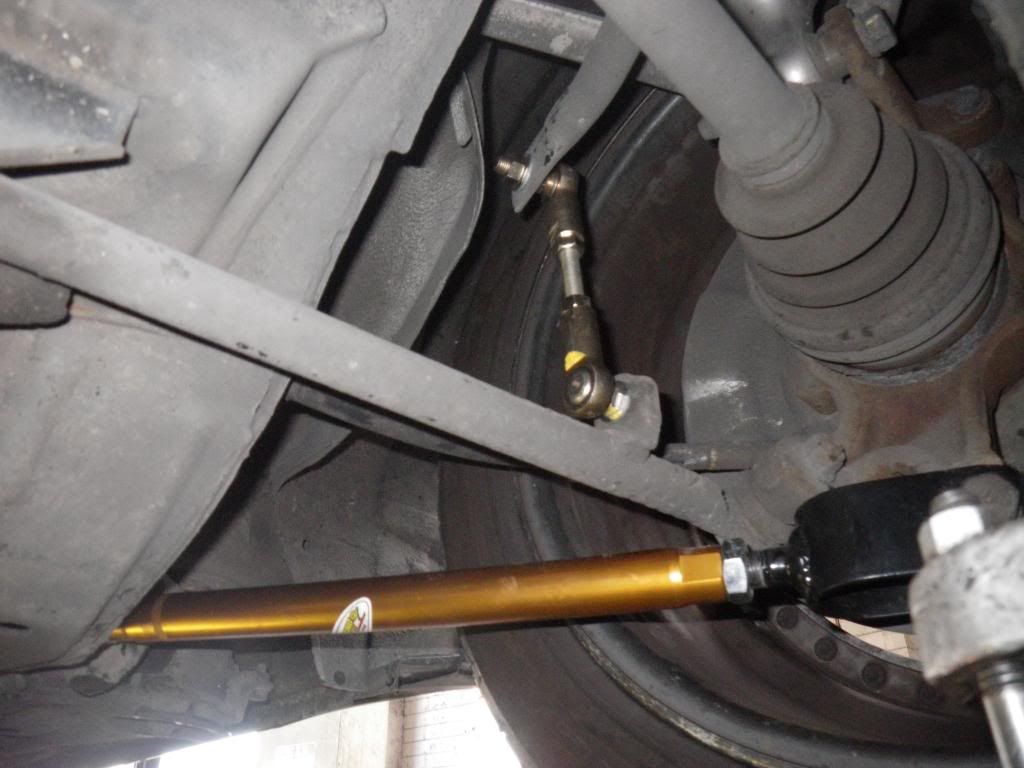

Back onto topic: Today I installed my new adjustable trailing arms, and sway bar end links!! :D Then got a proper alignment. (Turns out my tape-measure alignment the first go-round wasn't too far off though!!!!!
