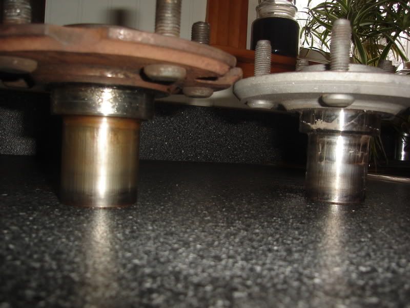

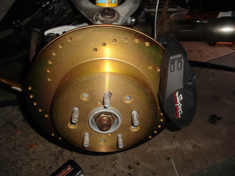

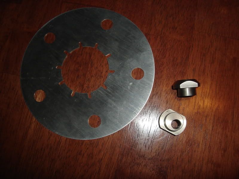

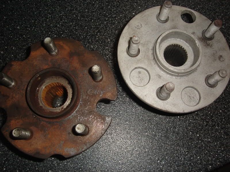

yes and no.you would need to drill out the mkIII hub to accept the caliper bolt's.then you need to shim the mkIV rotor out to center it between the pad's.the mkIV rotor's arent hub centric either.i ended up pressing the mkIV hub's into my mkIII hub carrier's,which solved this problem.
a pic of mine
jake's kit for the rear
rusty mkIII hub and mkIV hub
