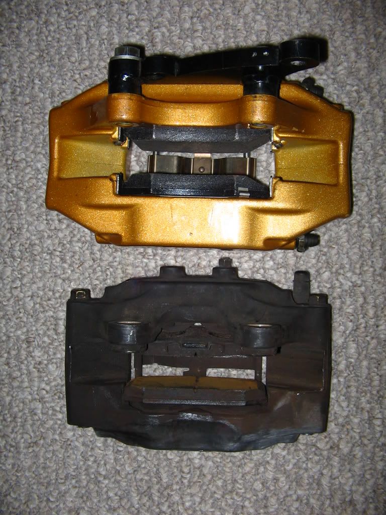

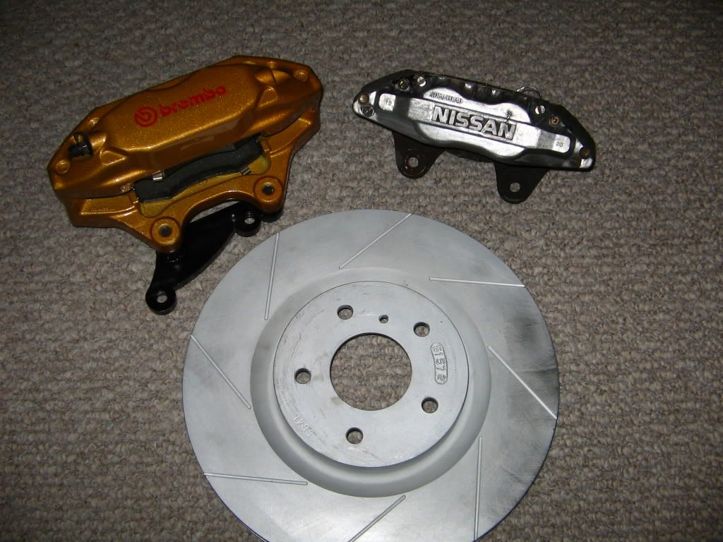

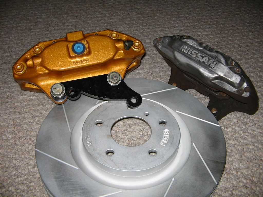

I'm gonna' bump this, and throw in a new twist to boot!:naughty: Just on a whim, I took one of my Night pager brackets down to a local shop, that always has cool stuff. Mind you, it's mostly Nissan stuff, but the owner does have immense respect for the JZ powered Supra's as well. He has had a pair of Sentra Spec V Brembo 4-pots sitting on a shelf for almost a year now. Well, I talked him into letting me take one home, to see if the NP brackets would bolt up, and to take some measurements. They do bolt up, but there are some offset differences, and I still don't know whether or not I can make them fit under my Volk GR-AV rims w/o a rediculous spacer! They also are narrower than the Z32 calipers (inside) because the Sentra uses a 22mm rotor, whereas the 350Z rotor is 30mm. Some metal backing material can probably be taken off of the pads, because it is quite thick. If I can make these work safely, I will run through everything necessary for the end result.
Here are a few photo's (sorry, my good camera batteries were dead!)...
The other benefit of having the Brembo calipers, is that they completely cover the usable rotor surface, unlike the Z32 calipers.:icon_bigg

Hmm. The 350Z Brembo calipers may even work, and they would fit the thicker rotor. They don't come cheap though. $3500 dealer price each, or generally about $500 each used if you can find them.

No, the 350Z Brembo's will not work with the Night Pager brackets. However, the GTR 33 Brembo's supposedly do. Sadly, the Sentra Brembo's don't work, nor did my Nissan Z32 calipers!:icon_mad:
I am giving up on this exercise of futility,:aigo: and buying the Revolution kit, that uses the 13" rotors, and 4-pot Wilwood forged Dyna-lites.
