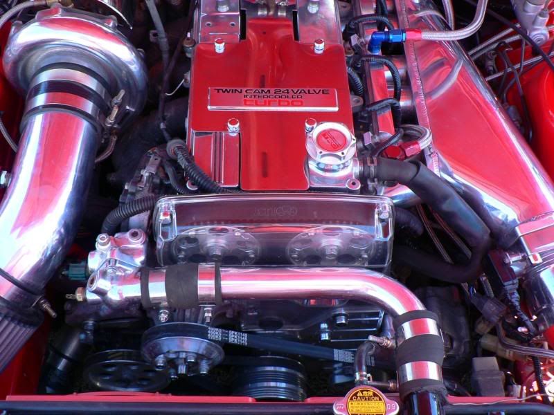

Ok, I got my coils with wires for $50.00 shipped.....
When I sit the coils on the 2-3 and 6 Plug, I dont hear that click sound as a Regular wire would. Does these coils just sit on top of the plug and not click on or should I hear that clicking sound.
Thanks as this is all I need to know to feel secure about the setup.

The coil pack its self does not CLICK on. it has a spring that contacts the spark plug. However the other wires off the coil packs should click on even if it is faint click.
supraguy31
May 10, 2005
626
Pembroke, NC
Got it and thanks. I just went outside and secured mine down to the Head. Turn the Key and she fired right up and purring like a Kitten. I guess I can say that Im the First COP Ignition in a MKII 7MGTE Supra.
