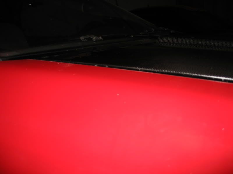

Yeah, If the holes was the only problem it woulda been no biggie, but when you stand in front of the car and look down and see the washer reservoir, b.o.v., and the bolts that hold the fender on......that's piss poor!
Buckshot...... not painting the CF, but I will repaint the stocker when I do the car.
This is what I sent in e-mail after talking on the phone and he requested pictures:
To VIS Racing / Carbon Innovation:
I will try to explain in detail here first.......when i first received the hood, I bolted it up and it would only close halfway down, luckily i was closing very slowly. There were no holes for the incursion pins on the hood latch. I cautiously made holes so the hood could shut....that went ok no problem....i figured if that was all the problem, i could live with it. Now the hood shuts all the way and latches, but the fitment is very poor. It has gaps of 3/8" on both sides between hood and fender as well as 3/8"all along the front. (Factory hood is 3/16) when you stand in front of the car and look at it, you can see the washer bottle, bov, all the bolts that bolt the fender on , etc. .....so it looks real gaudy. It also has a height problem.....on the front and rear ends of the hood it sits real close to flush with the front fender, maybe 1mm lower, but it bulges up in the center, sitting 1/4"higher than the fender. The stock hood fits fine, car has never had accident damage, etc. I'm a tech at a Toyota dealer, so i'm crafty enough to make adjustments as needed, but there is really nothing I can do with this. I know you guys just started making these for our style Supra recently and we are all glad, hopefully, it was just one bad one, but no holes by the latch is gonna get some hoods busted by dummies trying to put these on. It seems it just didn't cure properly or something the way it is bowed like that. Also the edges are rough and sanded, not rolled and smooth. The hood does have a VIS sticker, but no ISO badge if that means anything to you. The pics attached should show everything for you clearly.
Please contact me at (815) $#@-*&^% with any questions as soon as you can.
Thanks much
Ken
The seller just called me and said VIS will call me on Monday, but from what he can see in the pictures "IT DOESN'T LOOK TOO BAD.....ESPECIALLY FOR A CAR OVER 10 YEARS OLD, MAYBE THE HEADLIGHTS GOT MOVED FORWARD FROM THE BUMPER COVER BEING REPLACED....CAN YOU ADJUST THE LATCH??....THERES A GAP BETWEEN HEADLAMP AND BUMPER TOO", YAAAAA........assclown, did you read the part in the e-mail where I work on Toyotas for a living. If VIS has that attitude, it's not gonna be pretty......I doubt they are going to be that stupid though.

When you replaced the bumper cover, you must have made the hood bigger at the same time.:nono: You should measure the CF and the stocker, and see how far they are off.:icon_conf

The stocker is 3/8" wider, and 3/16 longer......ohhh, and its not bowed in the middle;)

are you using the hood shocks? they could be causing the buldge in the middle.

^^^^^I thought you might be on to something there Matt.....I went out and unbolted the shocks, it made the bulge better, but still not right, maybe if I put heat lamps over it for an hour or so and lay my fat ass across the hood:biglaugh: I sent Duane my #, he said he has some ideas:1zhelp: Gotta love that guy, not even his product and he's willing to help!!!
