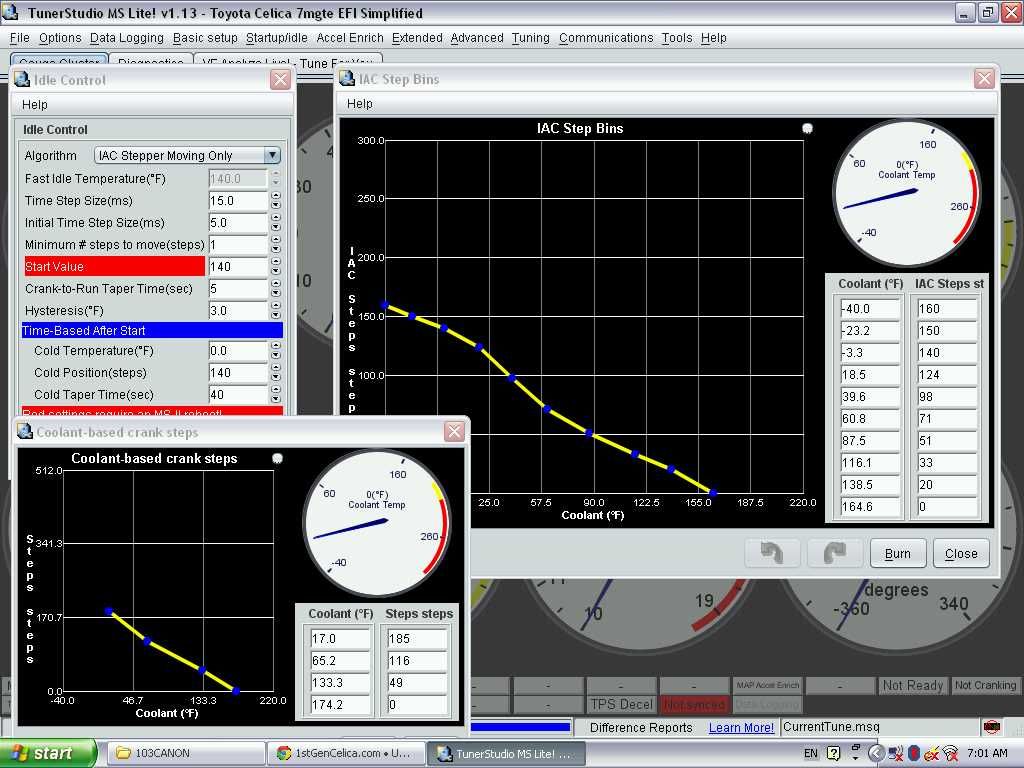

I got it to work great, just use my rough setting from the previous pics I posted on the last page in tunerstudio.

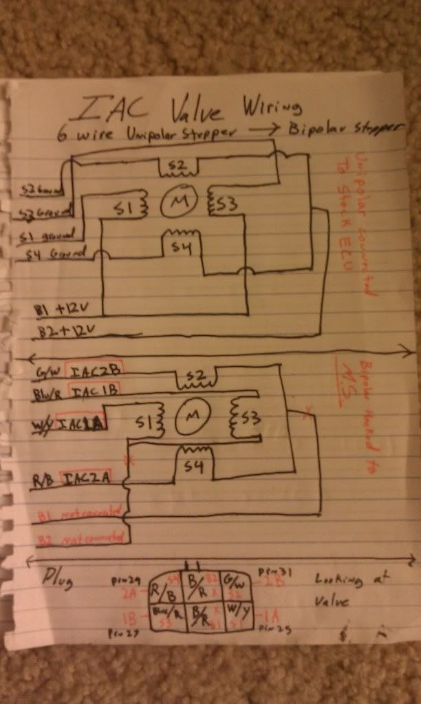

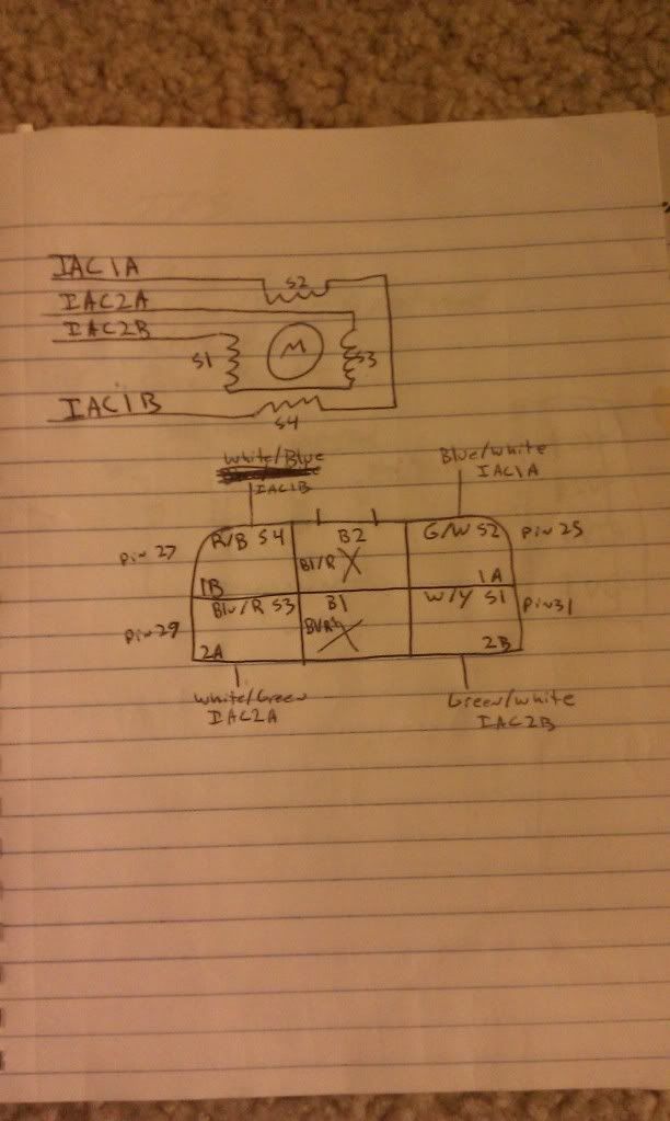

Basically, the Stock IACV is a unipolar stepper motor, and the MS can not control that, and really, it is very simple to make it work like a bipolar stepper motor that the MS CAN control! I took the time to draw a before and after diagram for all of you, and what wires go where if you don't want to figure that out yourself
and here are some rough setting to get it to work halfway decent, in case you missed it on the last page

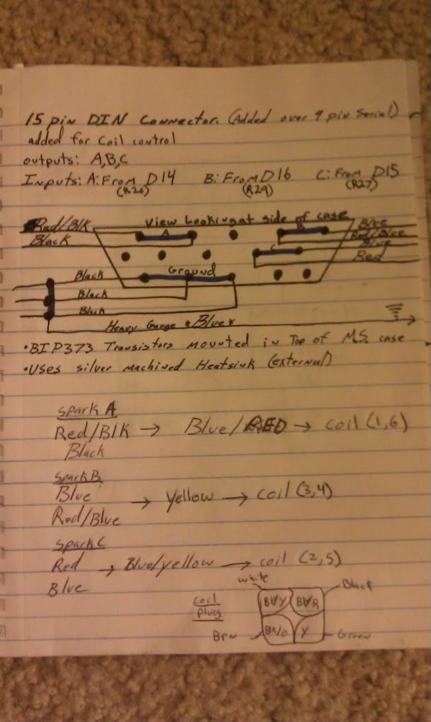

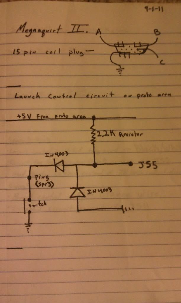

I HIGHLY recommend keeping a log of the wiring you do when you build and what you wire to!!!! Otherwise, you will be totally screwed if something goes wrong, and you don't remember what goes where. Plus, you can share your findings with others like I am doing!
Here is a few pages of the log I kept, mainly I just documented what extra circuits I added, and I drew a circuit of the boost control circuit inside the MS case as well.
This last picture may have the coil packs in the wrong firing order, I dont remember if I corrected it or not. You can figure it out!
