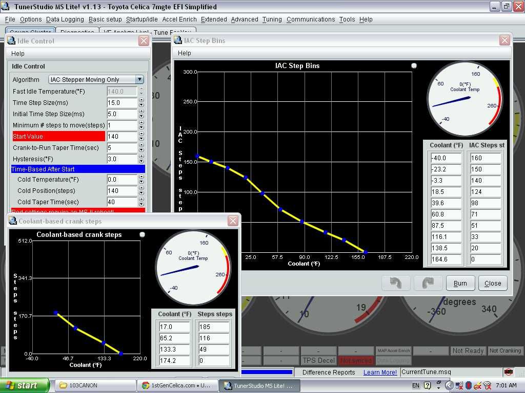

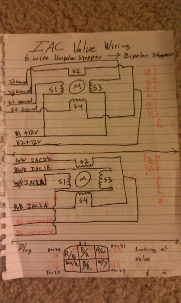

I already posted up how to wire up the stepper motor.
mkiiichip
Sep 10, 2007
1,434
WI
Right, and the link I posted keeps the unipolar design.
I appreciate the information you have supplied, I just wanted to point out there may be another option. When you switch from unipolar to bipolar, heat is increased in the windings. 1jz IAC's seem to be prone to failure, I am just trying to minimize my risks. Also, that's another part of my harness that can be left the way it is.
speedfreak426
Mar 31, 2008
380
Brighton, MI
I understand that.
I would just like to say that mine works flawlessly, and does not generate any excessive heat. It is only energized while moving, which is minimal.
But I am using 7M stuff, not 1J
