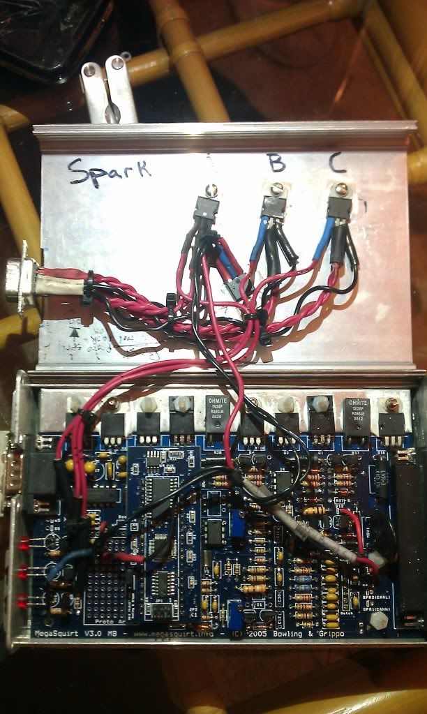

I highly reccomend Megasquirt.
I started from scratch and from starting building the kit to running 11's at the track within 2.5 months or so working on it on and off.

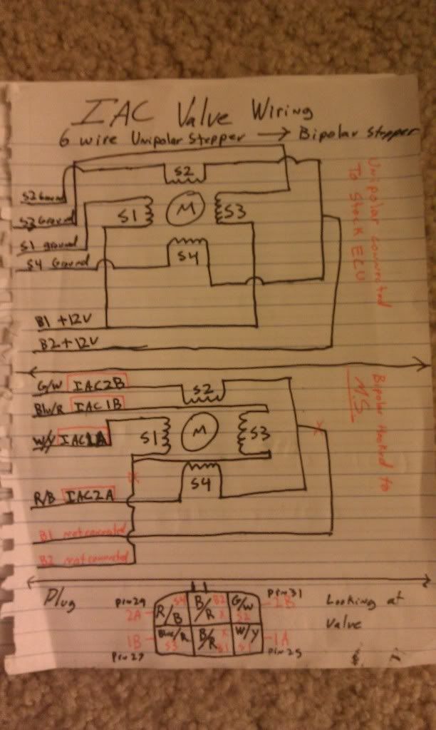

I can tell you how to wire the IACV and how to get it to work properly. Very easy once I figured it out! (I did the hard work for you, lol)
It is so satisfying building a computer yourself and then hearing it run for the first time :)
I have been tuning mine myself on a dyno and it has worked out great so far
Don't do the plug n play, just do it yourself!
Please shoot me a pm on how you did this or share with everyone. I have a few ideas in my head but working the IACV out has kept me from pulling the trigger. Any info would be great.

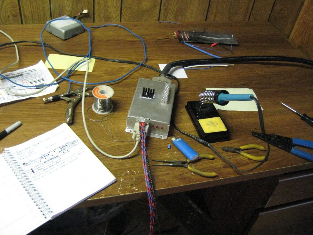

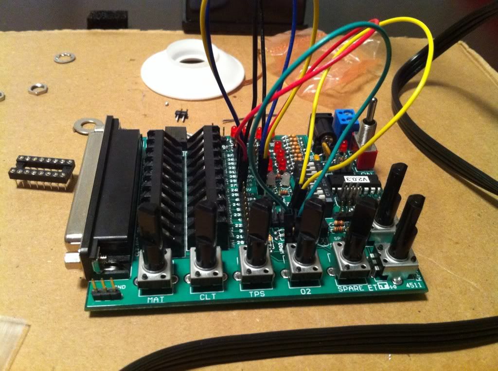

I am in the planning stages of running MS. I wanted to try assembling a circuit board, so I ordered a much cheaper test piece, and assembled that. See that centipede thing on the left, that was supposed to be soldered to the board, instead of the processor. So i may have fried it. Meh...
You have got to be kidding..... I have been researching for days on how to control these stepper motors. Do share, sir.

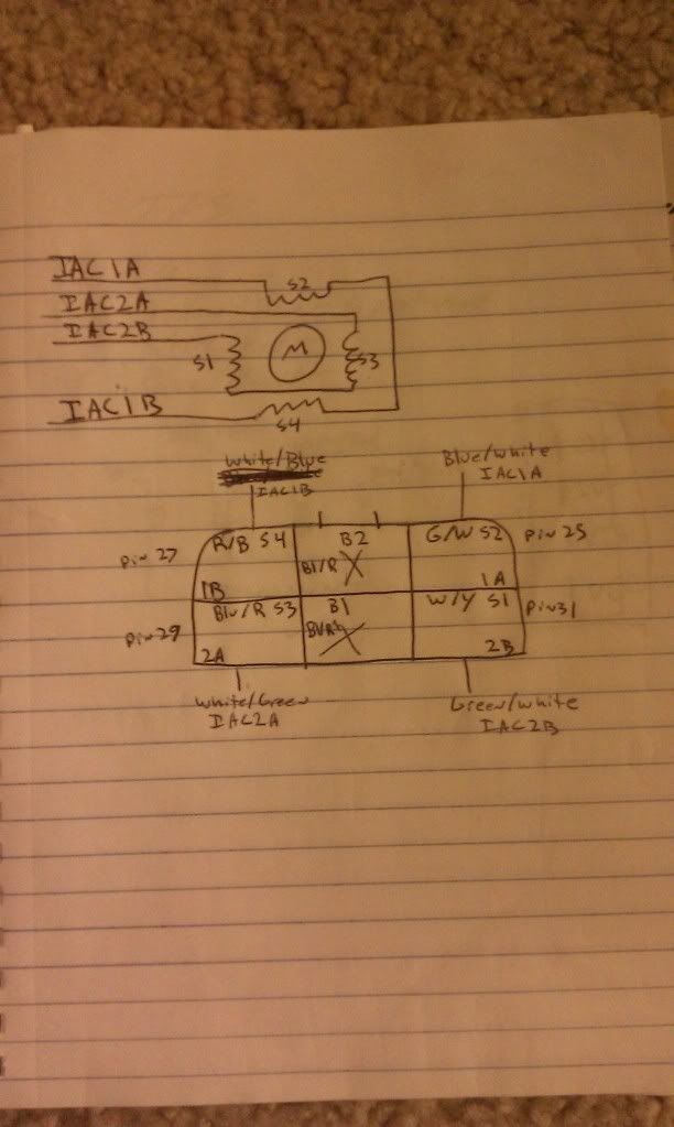

I got it to work great, just use my rough setting from the previous pics I posted on the last page in tunerstudio.

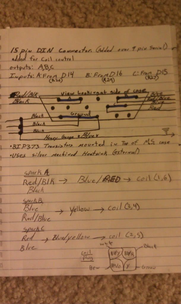

Basically, the Stock IACV is a unipolar stepper motor, and the MS can not control that, and really, it is very simple to make it work like a bipolar stepper motor that the MS CAN control! I took the time to draw a before and after diagram for all of you, and what wires go where if you don't want to figure that out yourself

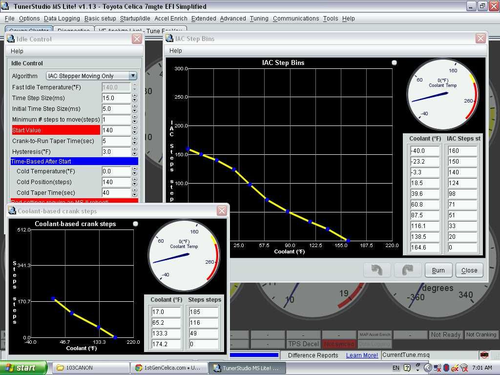

and here are some rough setting to get it to work halfway decent, in case you missed it on the last page

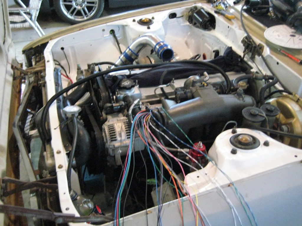

I HIGHLY recommend keeping a log of the wiring you do when you build and what you wire to!!!! Otherwise, you will be totally screwed if something goes wrong, and you don't remember what goes where. Plus, you can share your findings with others like I am doing!

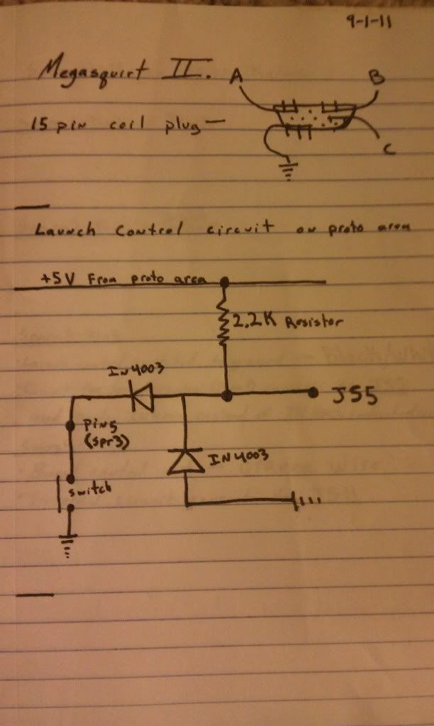

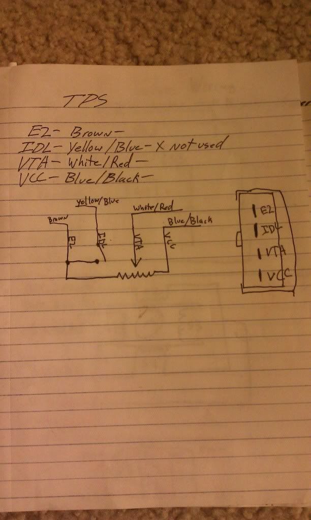

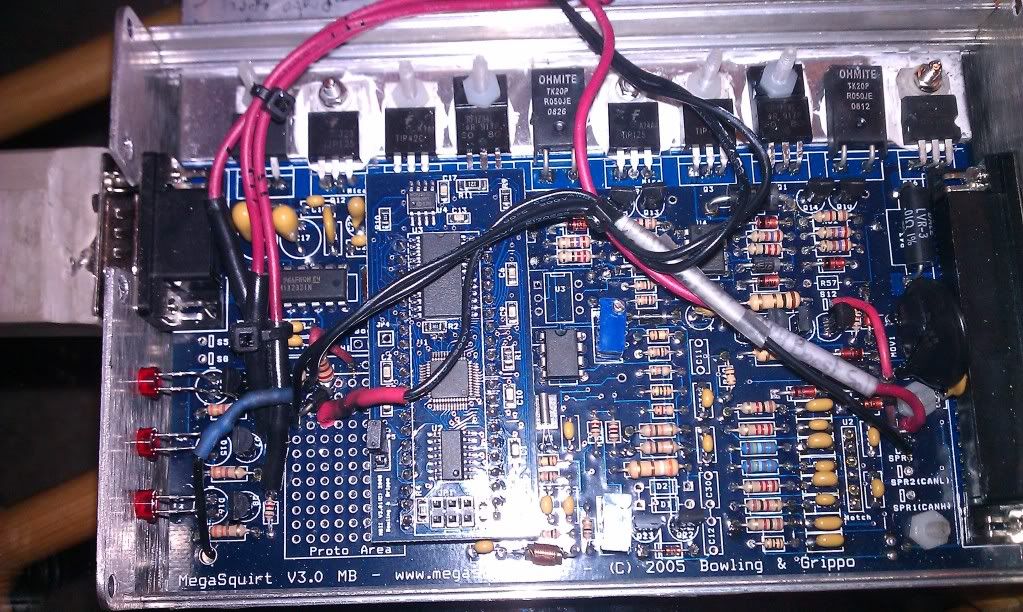

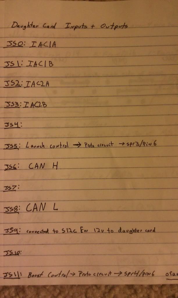

Here is a few pages of the log I kept, mainly I just documented what extra circuits I added, and I drew a circuit of the boost control circuit inside the MS case as well.
This last picture may have the coil packs in the wrong firing order, I dont remember if I corrected it or not. You can figure it out!
