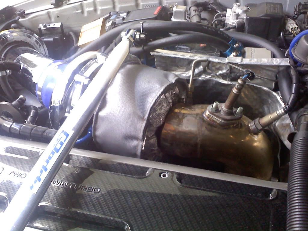

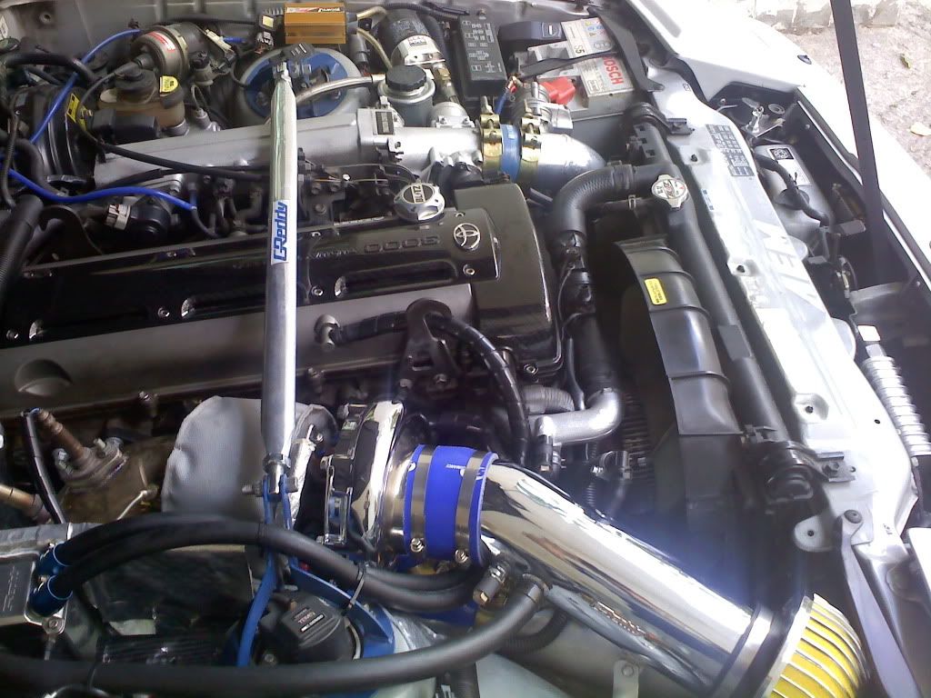

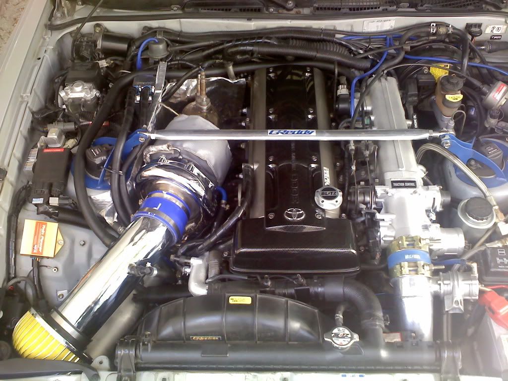

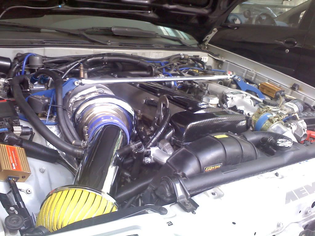

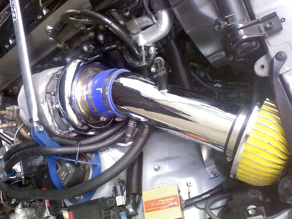

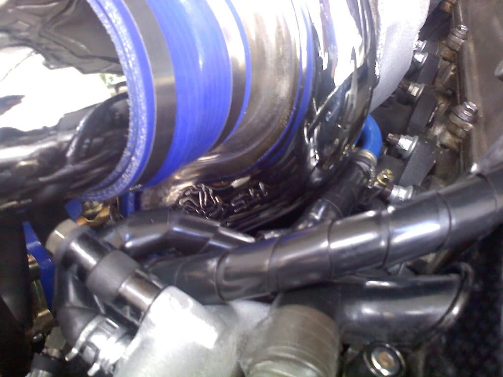

Turbo kit that I put together-my choise :
-Turbo ITS 72mm,T4 twin scroll,DBB - water cooled with 0.70 A/R on hot side
-Exh.manifold HKS GT T4 divided ceramic coated
-Wastegate HKS GTII 60mm wastegate
-Intake kit Greddy Air Inx kit
-Boost logic oil feed / return kit with all fittings
-4 inch down pipe and mid pipe with V-bands all over.
-Boost logic 4' inch to 3'inch adaptor to connect my 3' Blitz Nur cat-back
-Boost logic turbo T4 blanket
-PHR heat coated screamer pipe,HKS WG V-band clamps,HKS Exh.manifold studs & bolts,
and exhaust V-band clamps 4"
-And last some other stuff like : Turbo 3" V-Band clamp,4" silicon coupler & clamps,
SS braided wastegate lines , DEI turbo insulation kit / heat shield etc,.

Engine mods :
-HKS 264 cams
-BC springs / titanium retainers
-Ferrea valve stem seals
-Greddy cam gears
-Greddy pulleys
-Greddy oil filter
-Titan ATI crank pulley
Electronics :
-AEM with 3 bar map sensor and a motec intake temperature sensor.
(sold the MoTec...unfortunately I couldn't find or fly a tuner over here. And I was very low
on cash that time).By the way the AEM is more friendly-user to the OEM componets like CEL light,etc...

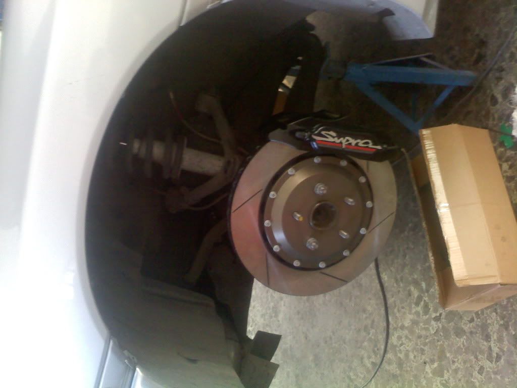

After about 8 months of doing nothing to the Supra (low on cash :cry
I am back with new ideas. Going to buy some parts to upgrade the supra
on the drivetrain-handling level to support the new horsepower goals :icon_bigg

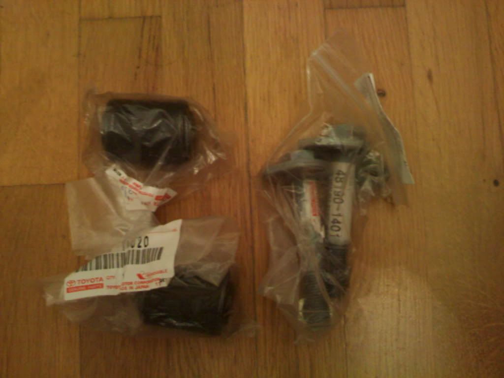

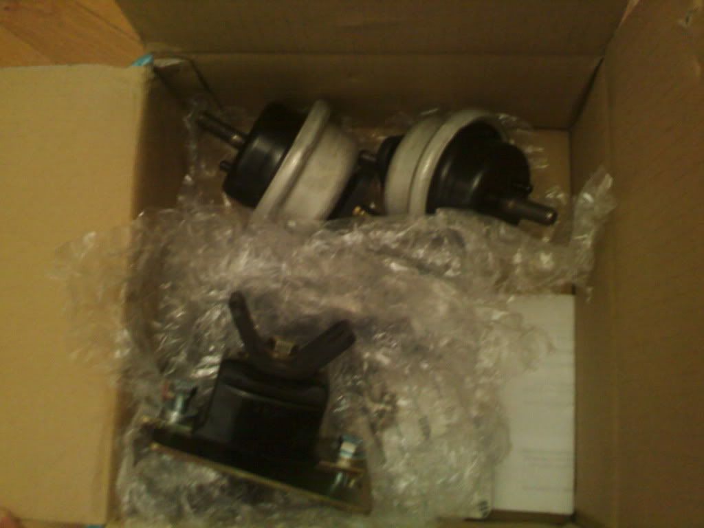

I had these a long time now,but I installed them last month.
Car feels much better now,engine/trans mounts made quite a difference!
TRD motor mounts and BIC poly trans mount

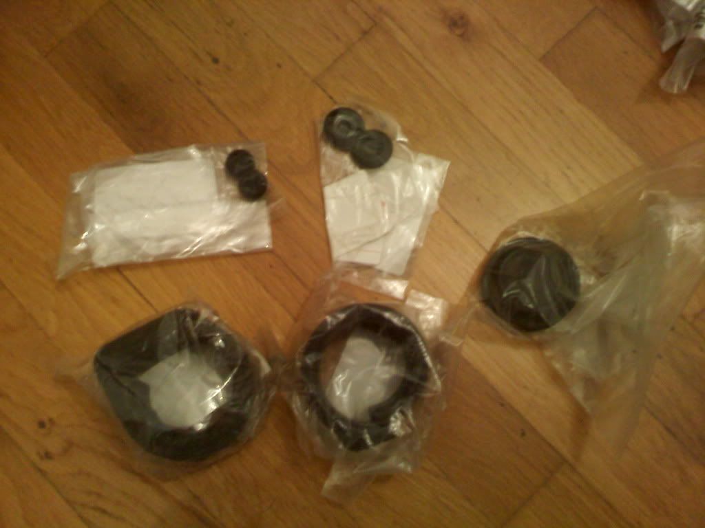

Toyota new oem rear bushings with adjustable camber/caster bolts
Steering rack toyota new insulators and front crossmember gaskets/plugs

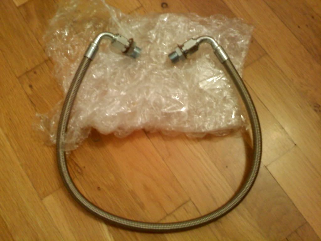

Driftmotion power steering ss braided teflon high pressure hose

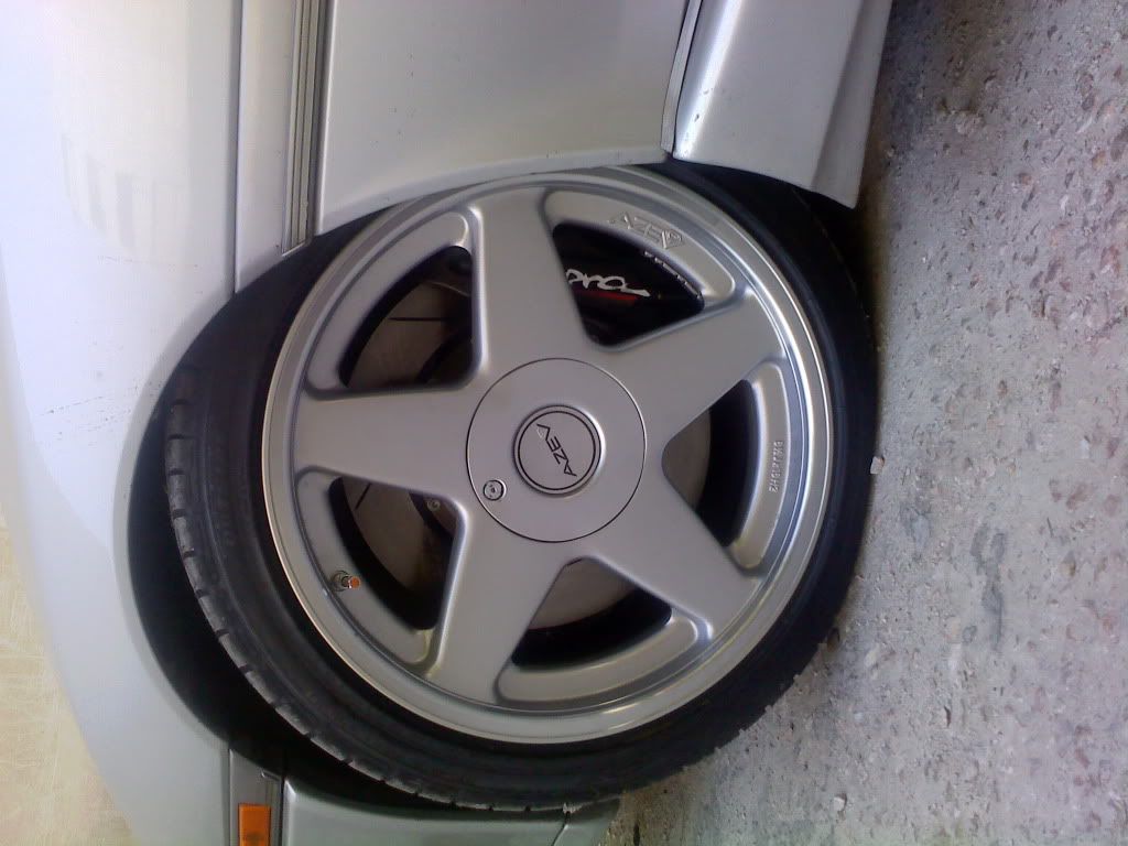

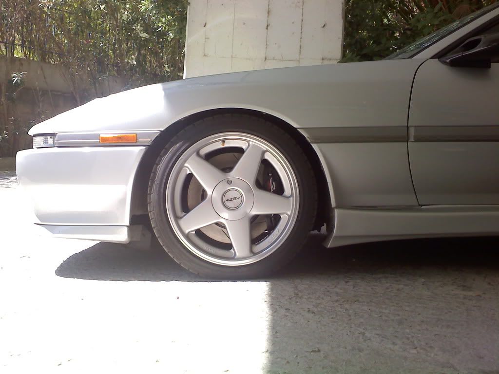

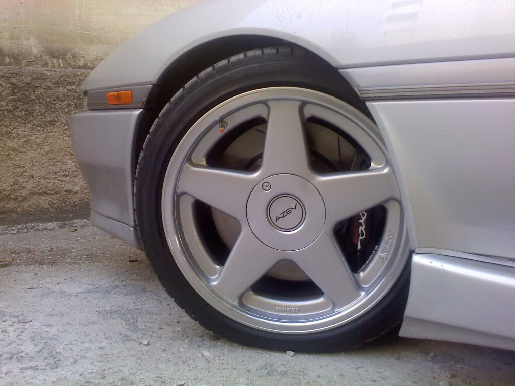

Six months ago I got New 18' wheels (5 spoke Azev type A' rims and new bigger Dunlop tires)
18' x 8.5' front ET25 with 235-40/18' and 18' x 10' rear ET24 with 275-35/18' (rolled and slightly pulled fenders in the back)
and now I got new parts today and waiting for some other stuff in the next days...

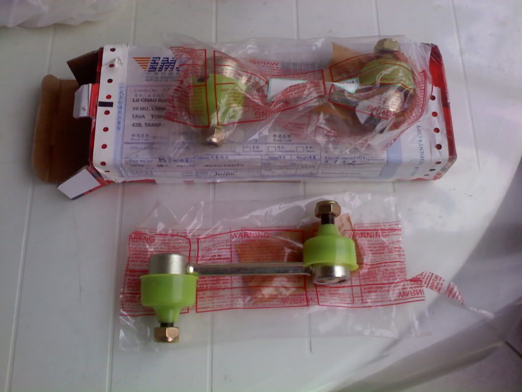

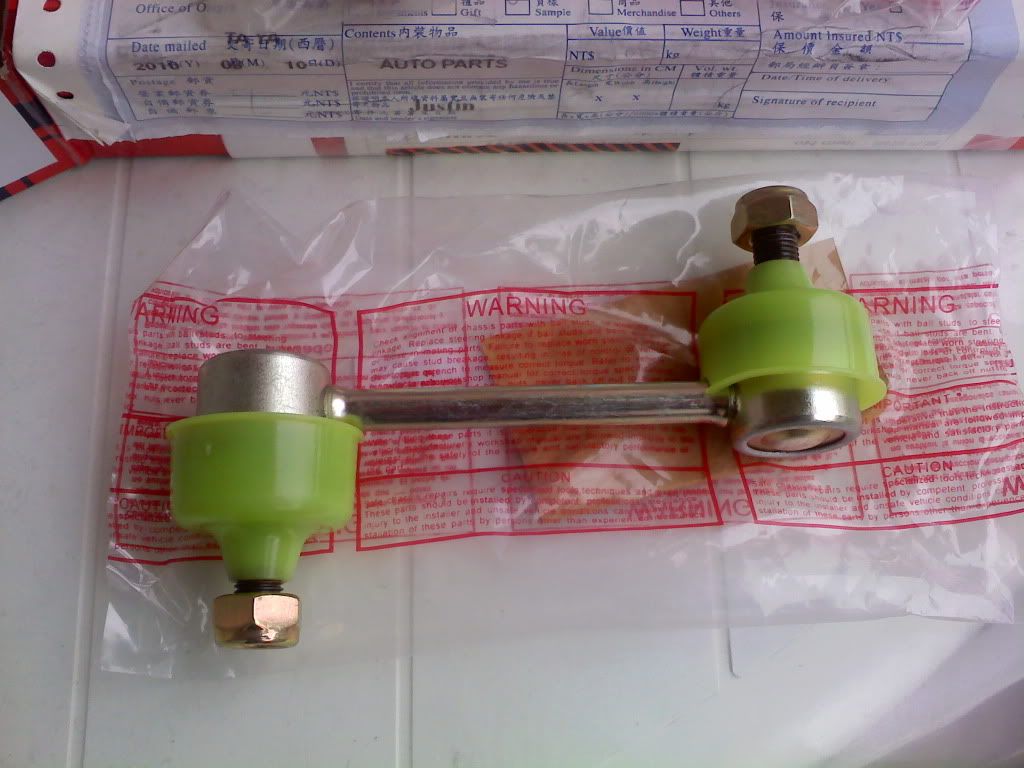

Next...some sway bars to match the end-links from far east xexexe!
