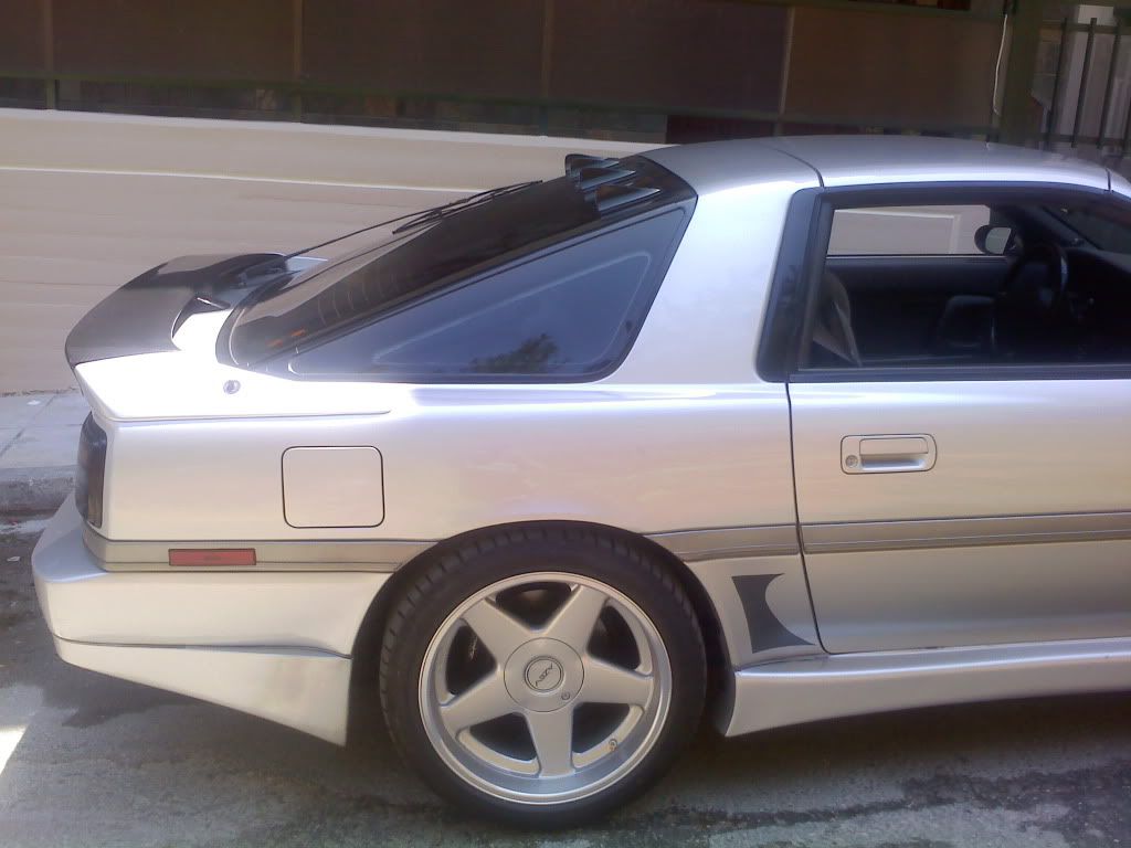

When you get a chance you should take some more pictures of the diffusers and rear bumper I really like both.

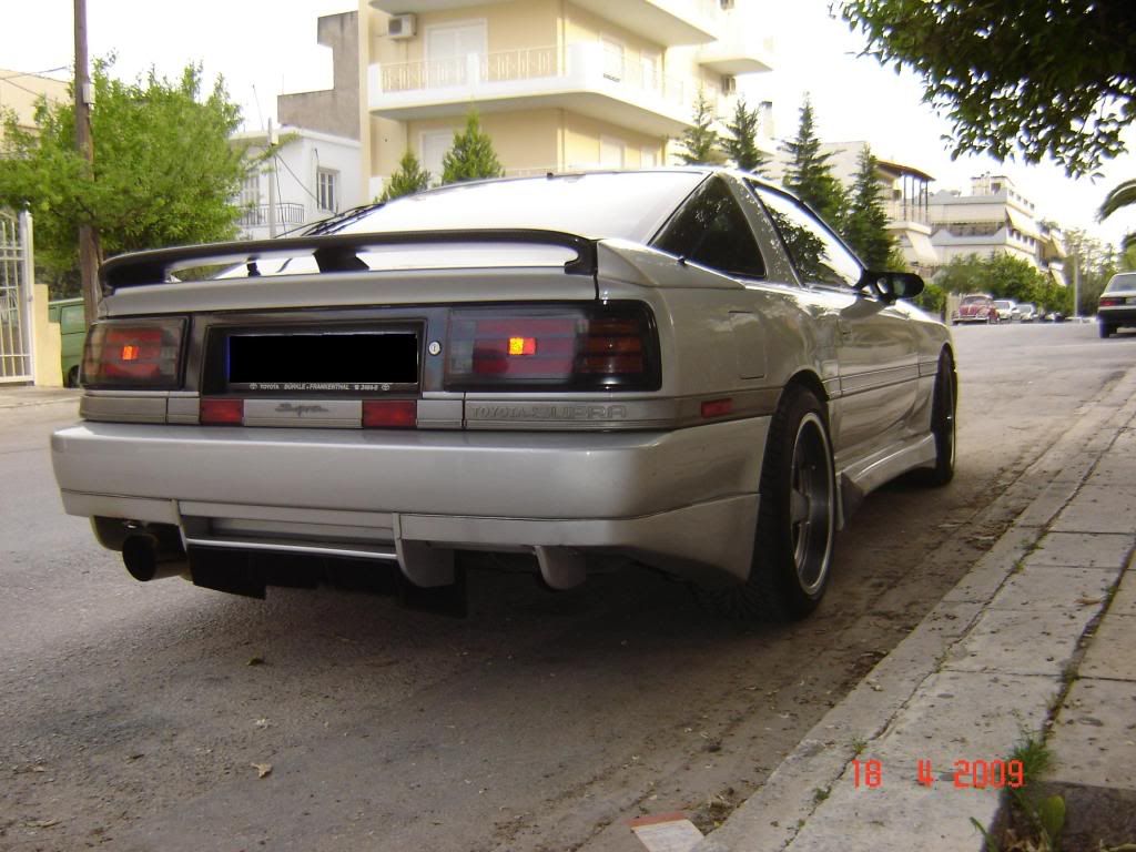

Will do :biglaugh:
Actualy the rear bumper is the stock one.
I have made a custom rear under spoiler.It is a combination of Bomex
rears and Regulus rear section. I have added a rear deffuser.
The rear deffuser is also a custom work from fiberglass and it is painted
black.
That's all :sarcasm:
I'll make some new photos of the rear section soon.

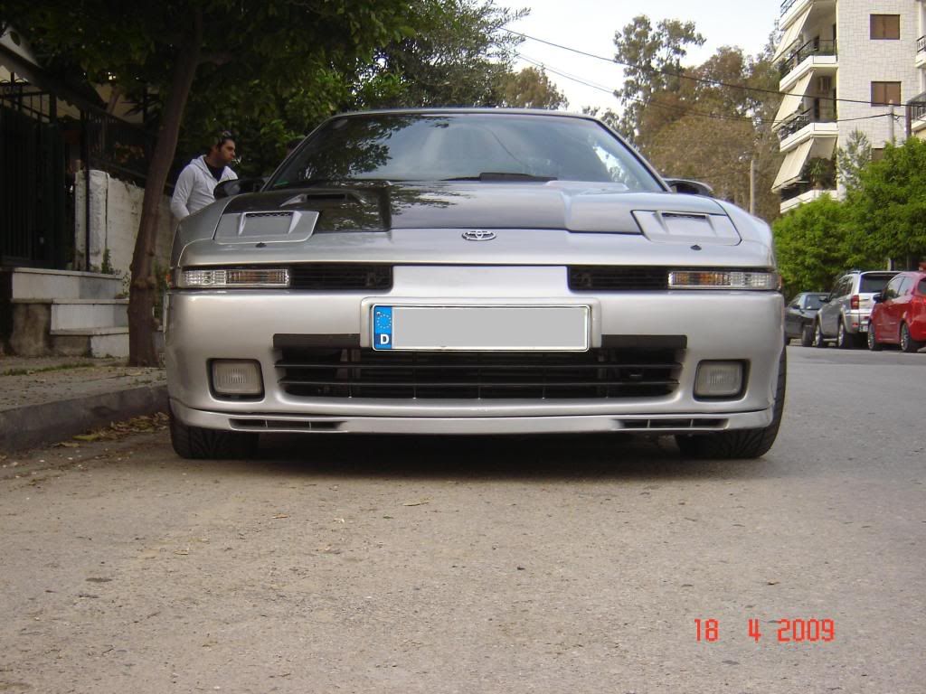

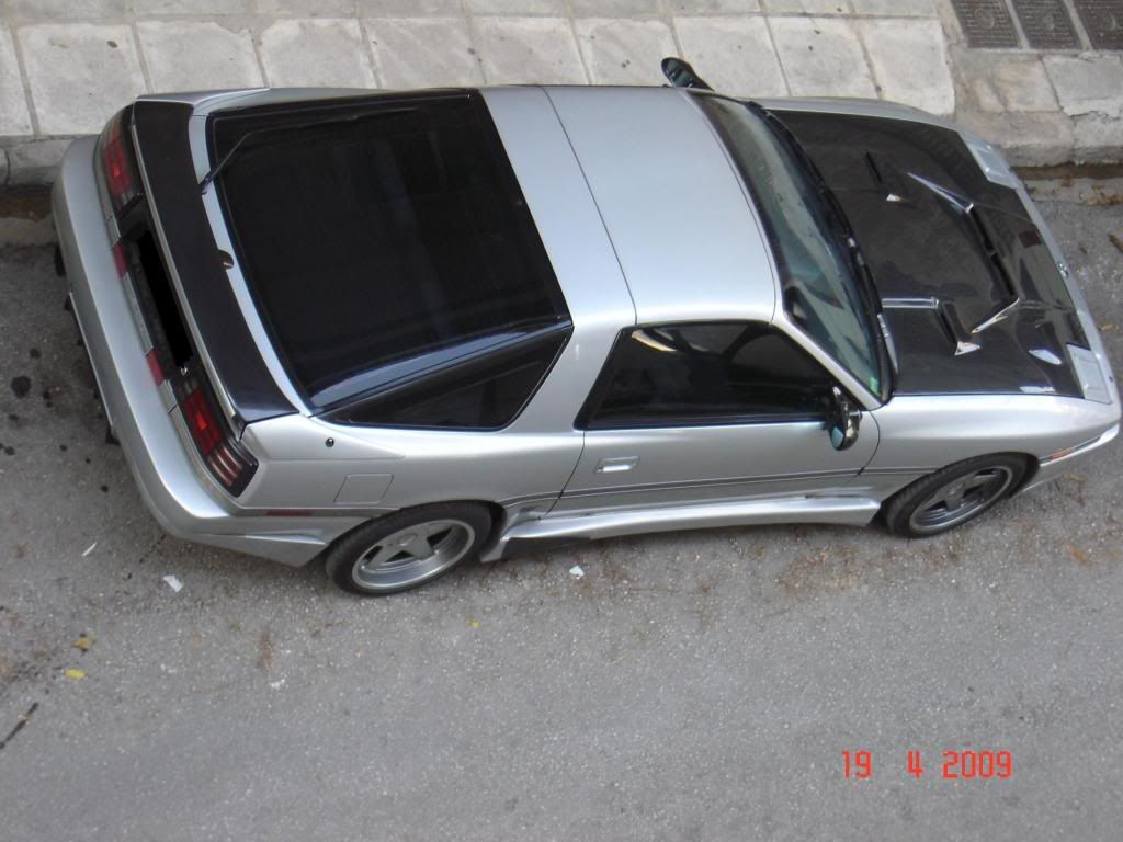

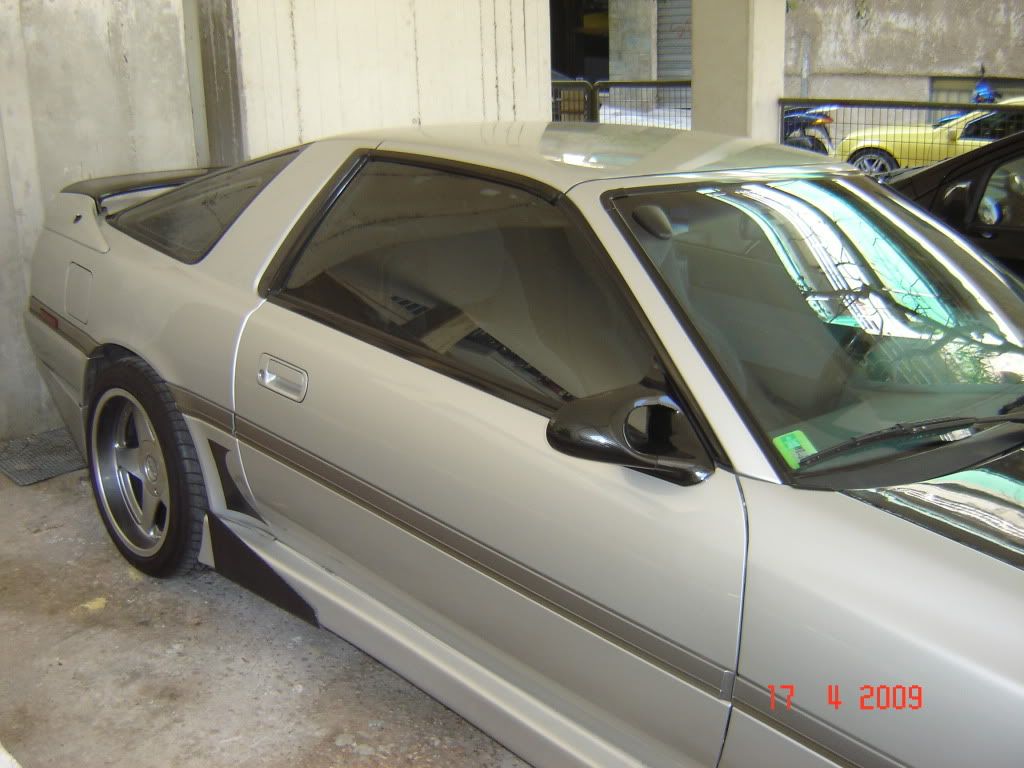

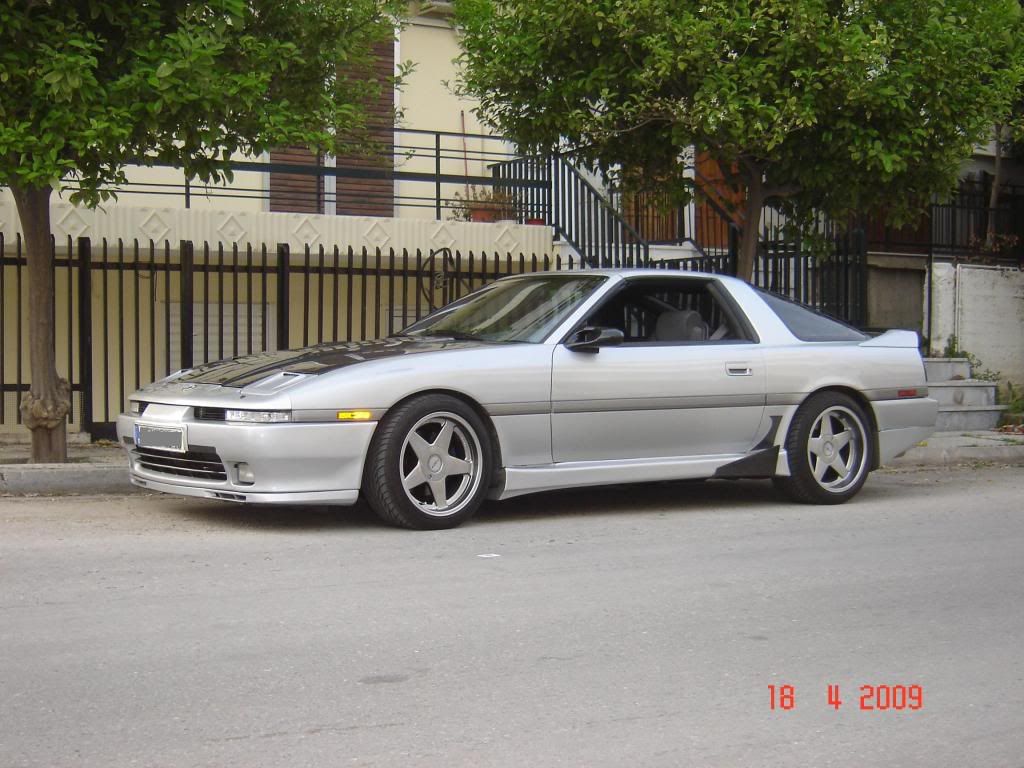

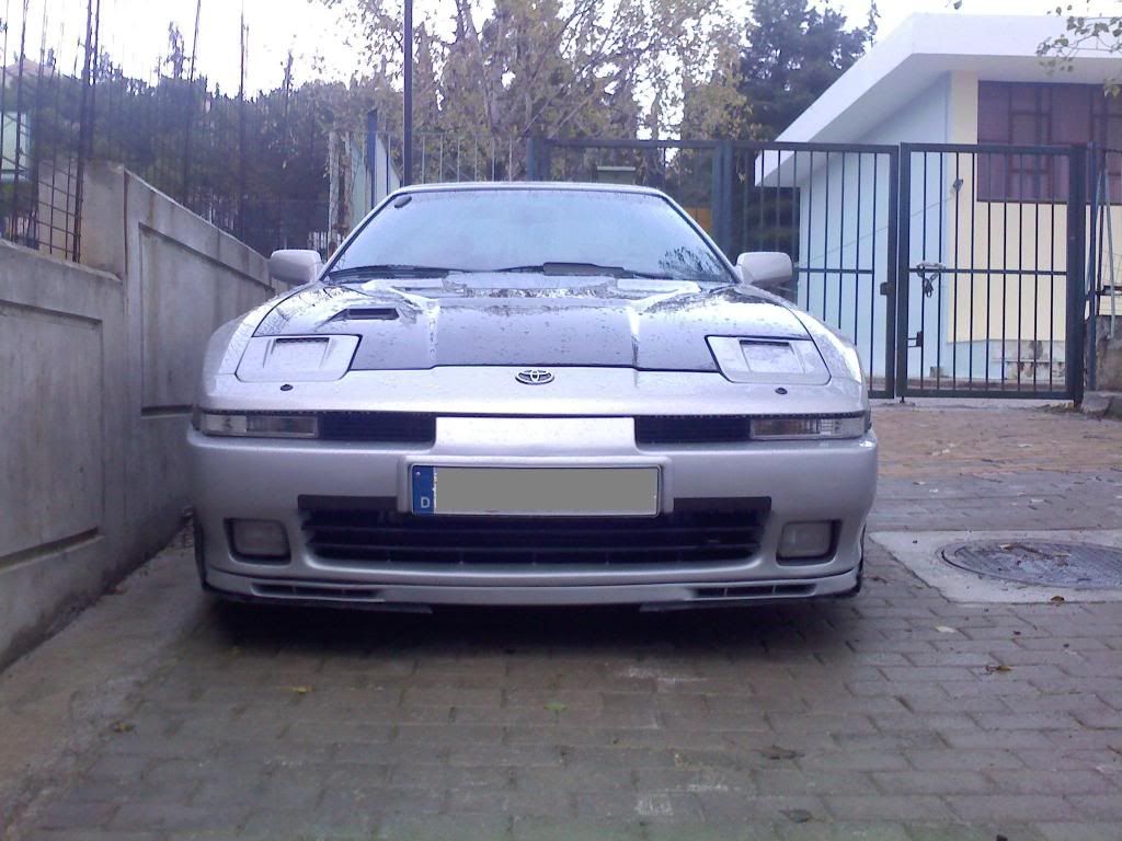

More pictures....

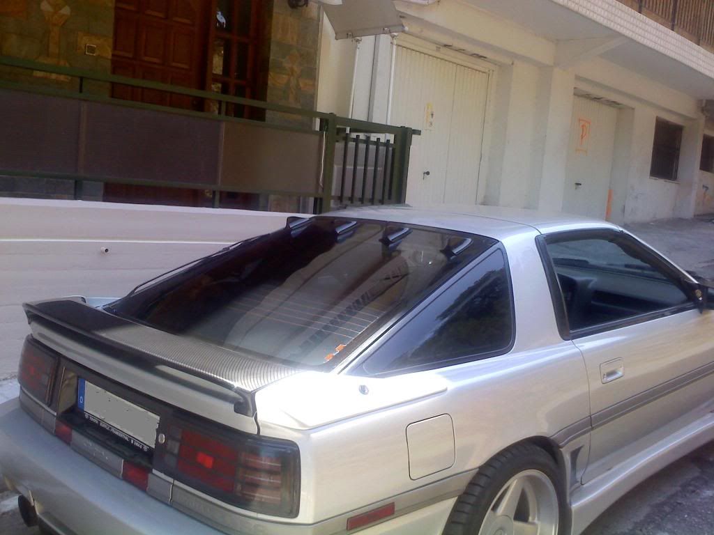

With the carbon hood,mirrors,rear wing,side diffusers :biglaugh:
The above picture was taken with the stock mirrors on...though.
The 17" Azev A rims have been sold. New rims..Same Azev A are on the way,
but widder and bigger ones :sarcasm:
Stay tuned :biglaugh:

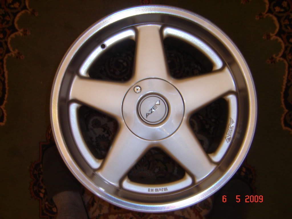

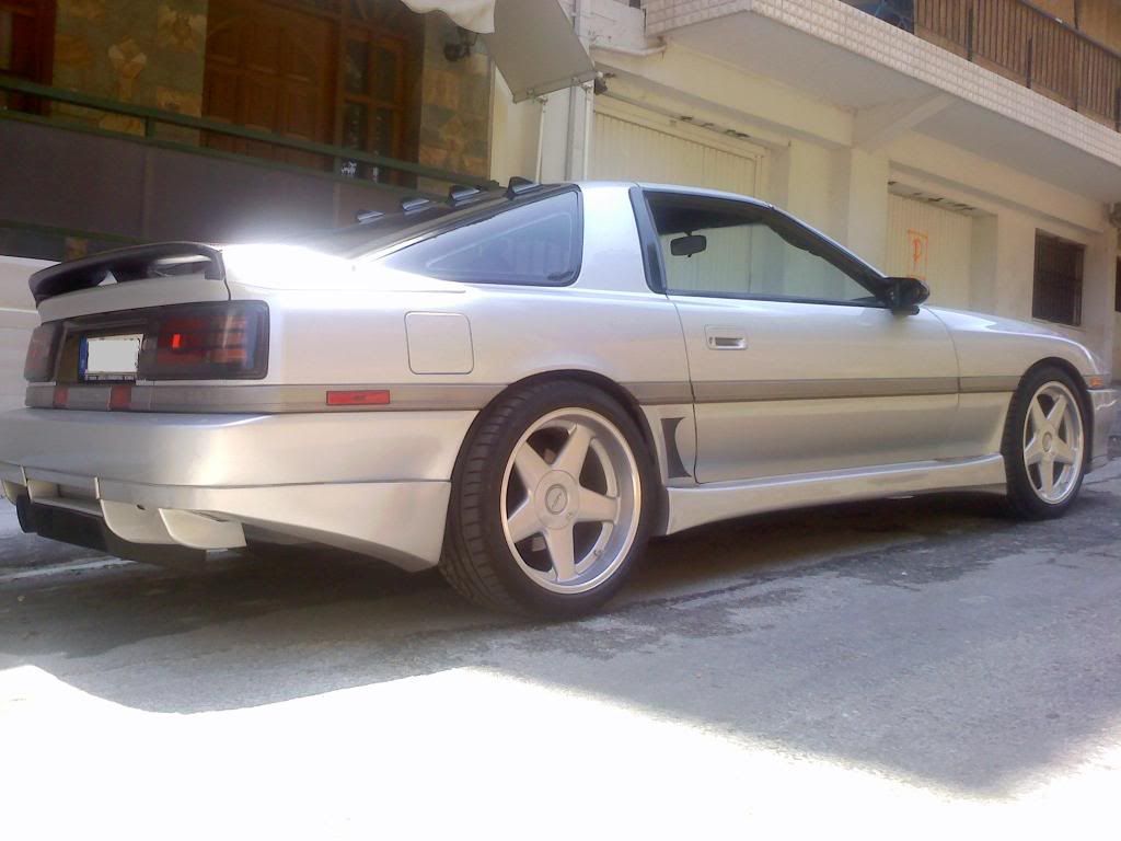

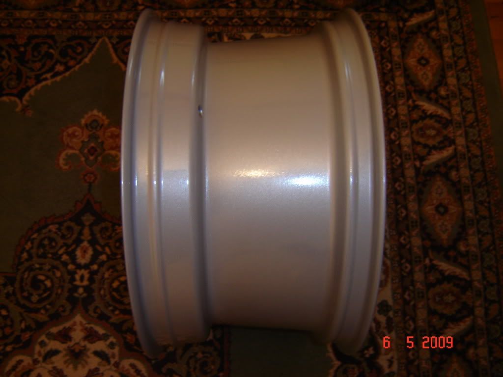

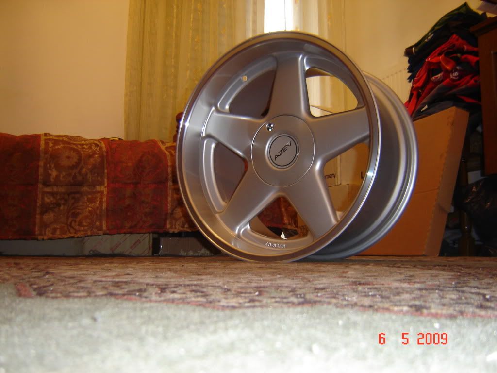

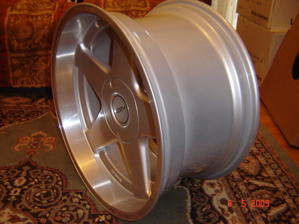

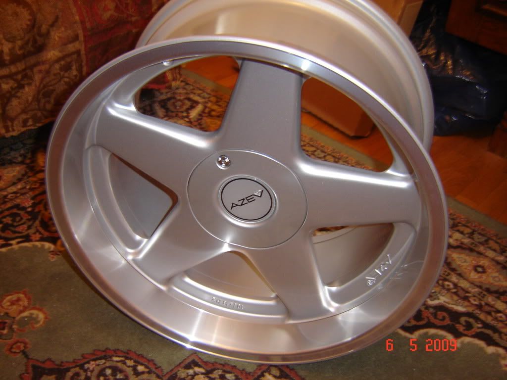

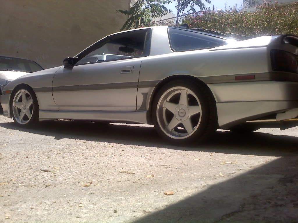

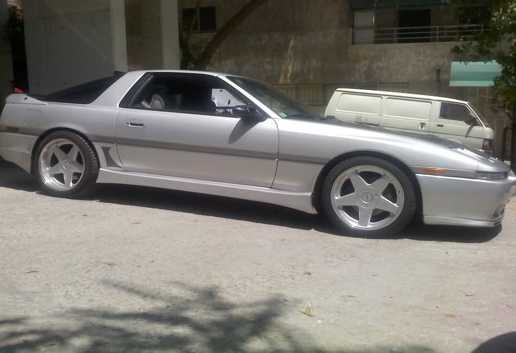

The 18" Azev rims have arrived finally after 3 months :love:
Front is 8.5" x 18" ET 20 with 235-40/18'' and rear is 10.5" x 18" ET 24
with 275-35/18" Dunlop Maxx asimetric tires.
I rolled the rear fenders and pulled them a little,so they won't rub :sarcasm:
Front are ok,no need to do anything!
Here are the new Azev type A rims:

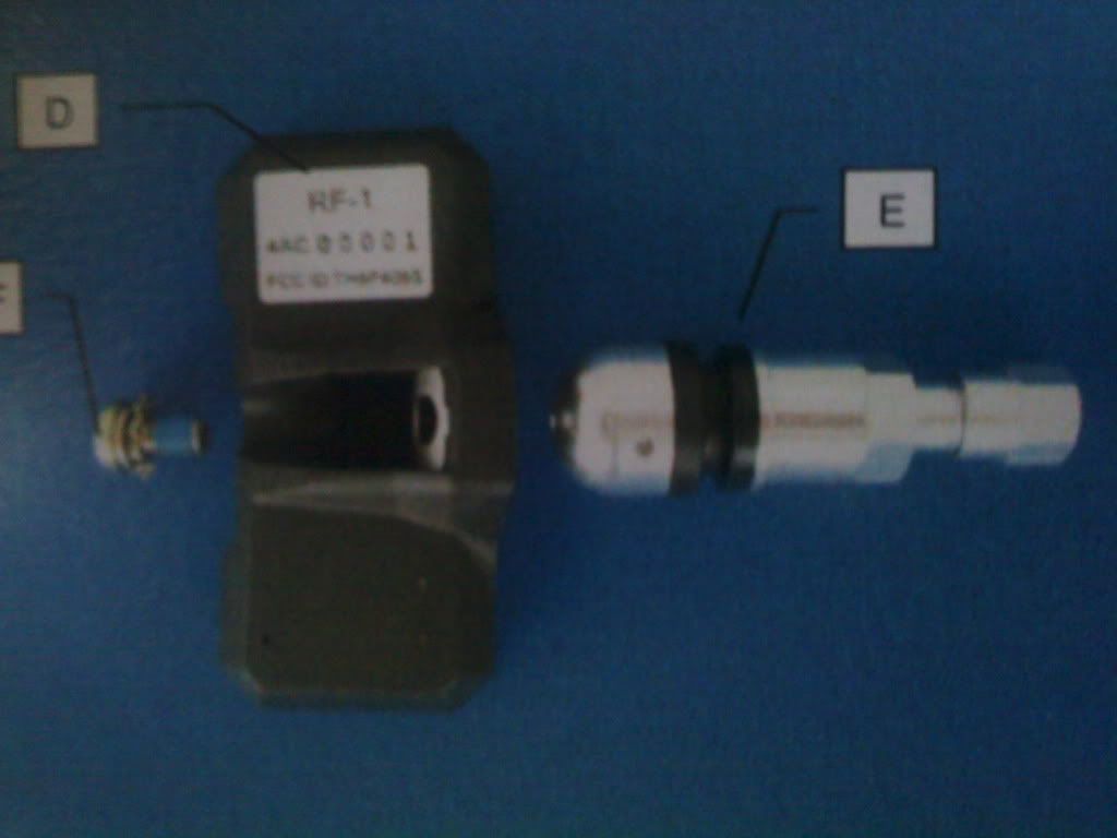

Also,bought this nice gadget. A wireless module that measures the tire
pressure and temperature.Ready to be installed with the new tires/wheels!

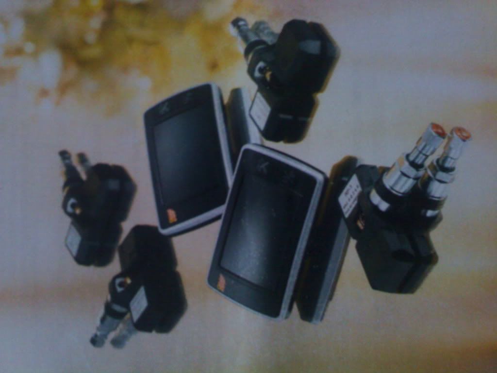

IJ.;1349843 said:
What sensors does the tire gadget use?
It uses wireless sensors. The valve attaches to the sensor inside the
rim. Send you some pictures...
They display tire pressure/temp in real time with an accuracy of - / + 1
psi or Farenheit. Nice gadget.You can set peak datas and warnings! It is important though to know exactly your tire pressure when doing high speeds (+150 mph) :biglaugh:

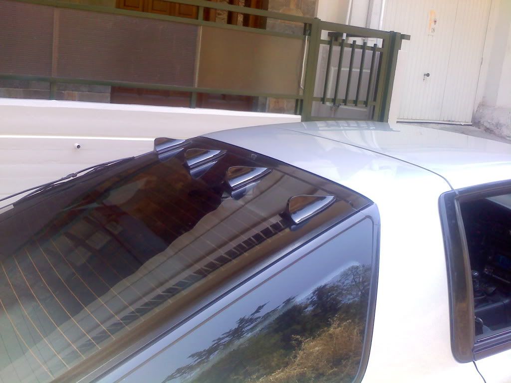

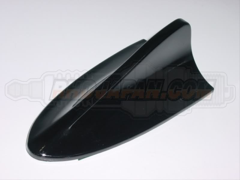

I also installed four sard vortex generators over the rear hatch window.
They look cool...JDM style :biglaugh::sarcasm::biglaugh:
RHDjapan.com says that these can lower the cd drag about 0.01 cd. Who knows?

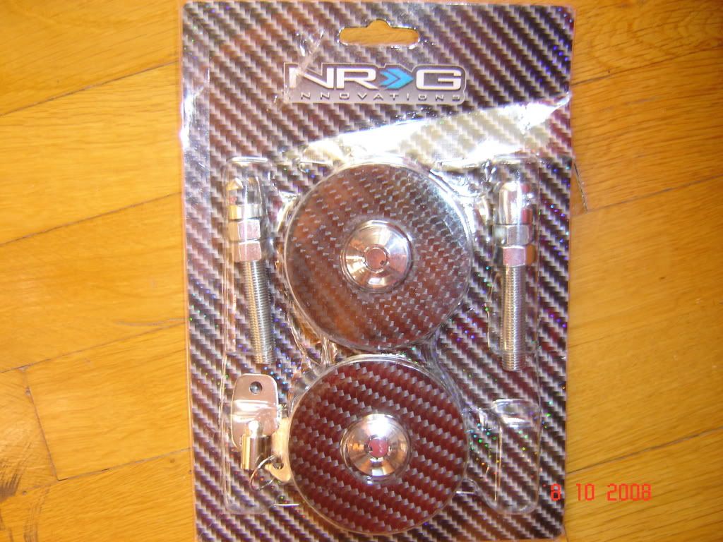

Got also some carbon hood pins for the 'Stout' carbon hood
And I took off the side diffusers...sold them! They didn't go with the Bomex
side skirts.

Yeah...You're right!
And I was thinking,I have new rims/tires...why did I get 2 stickers of lead on each rim?
Damn those sensors...:biglaugh::biglaugh::biglaugh:
62
A few of the race teams here have had issues getting a balance using that sort of sensor, if it's an issue have the tire shop try the tire in a few different positions to get the minimal amount of weight added.

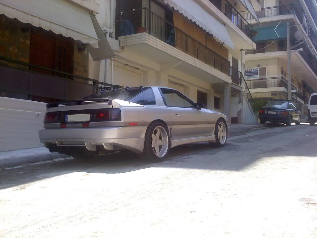

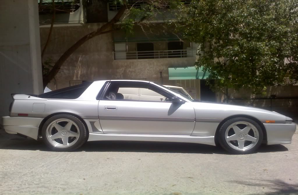

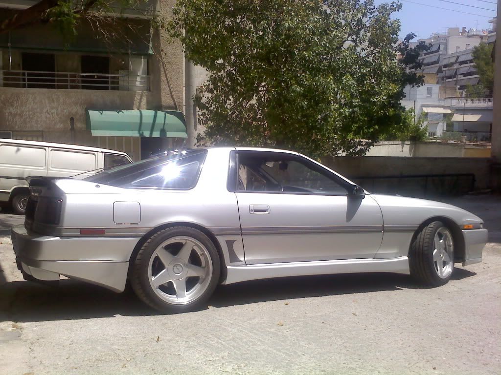

Exterior pics with the new 18" rims and the fat tires :biglaugh:
Also hood pins and sard vortex generators are on car right now...

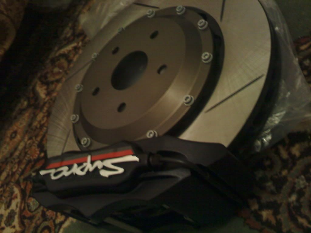

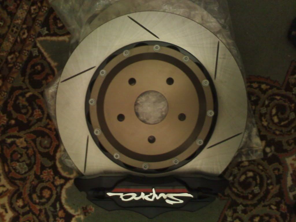

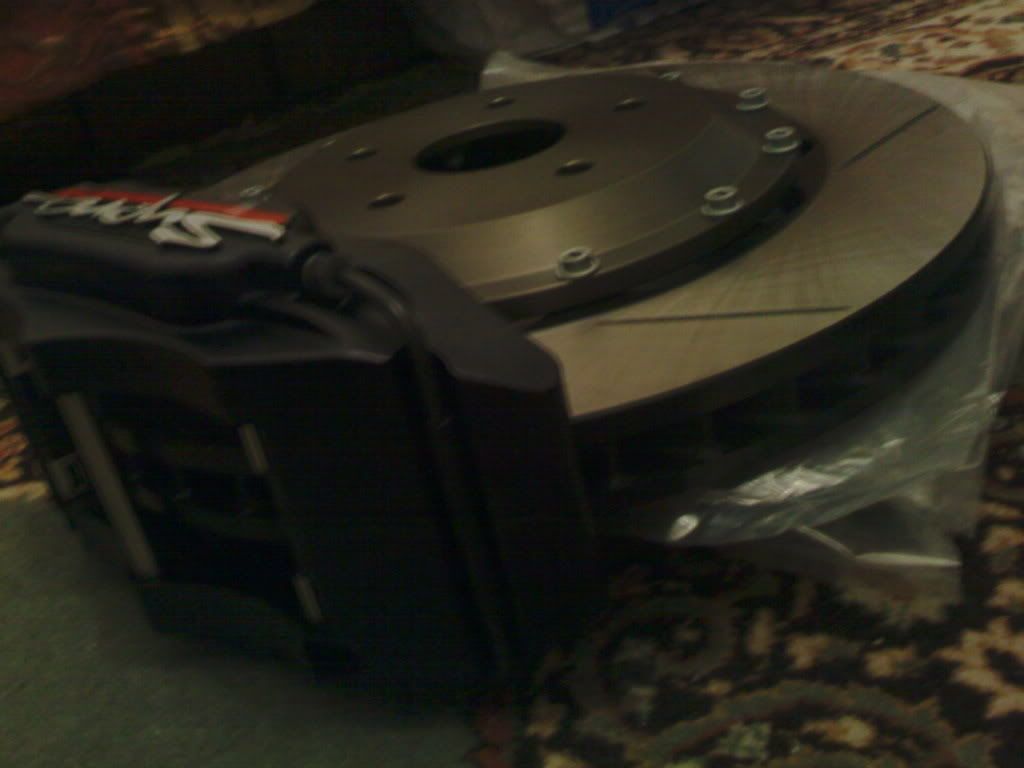

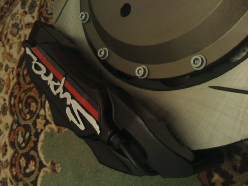

Big brake kit arrived!
JGTC JDM 6 pot aluminum lightweight caliper and divided 355mm (14") slotted
32mm (1.25") width rotor. Put on a mk4 supra decal on them :sarcasm:
I like the oem stock looks :biglaugh::biglaugh::naughty:
Time to put these on...maybe tommorow!
