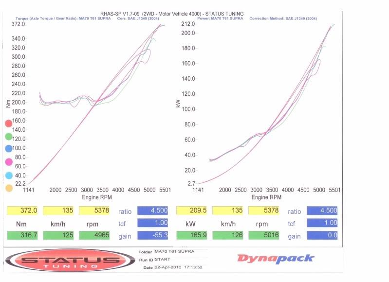

ok guys, there is a bit of good news,
Found the issue! my alternator decided to pack it in on the way to the tuners! and my vac lines were retarded (vac leak!)
now fixed the vac lines, he did the base tune and one power run!
8psi (7.8) boost 209rwkw (284rwhp) @ 5300rpm, power was not even starting to drop off @ 5300rpm!
im really happy with the result @ 8psi.
THIS IS NOT THE FINAL PRODUCT, just a mid tune power run but its showing promise! Afr's are 11.5:1 and SFA timing too!
Yellow results are my car, Green results is a comparison against a 1G-GTE in similar specs
Cars booked in for 2 weeks time to have the tune finished once i fix the alternator.

Well to give you a base i've had 260RWHP at 7.7 PSI (due to a big boost leak) with a stock CT-26 so hopefully those numbers will jump significantly with higher boost

this run stopped @ 5300rpm. power was still shooting up! so i doubt 260rwhp is what it had in it at this level, the tuner didn't get to finish before the alternator died %100 so its not really tuned past 5000rpm...
i think one other thing to note is this is a Dynapac (bolts to hubs) , not a roller dyno. from what i hear they typically read lower than roller dyno's
this is at 11:1 AFR on closer inspection of the graphs and running around 10deg timing on a base tune!
what's been done? i listed everything previously, main power adders are 3" turbo back exhaust, turbo, FMIC and standalone ECU
This turbo's peak efficiency island should be somewhere round 18-22psi from my calculations.
There is one way to find out how much power it will make at full boost :)
