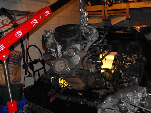

Well after that little issue, she's out!! Thanks for putting some doubt in my mind so that I was able to find it. Sorry to waste your time! :)
It was kinda nerve wracking as the hoist got higher and higher, but I just went ahead slow and steady! Now just have to grab the following from this engine and bolt them up to the new one:

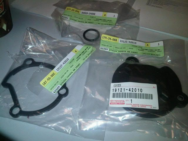

The other day when I pulled the CPS off, I noticed that the cover was broken around the screw holes and the packing was just rock hard and broken to many pieces. So I went ahead and ordered some replacements:
Got them in less than a day! :naughty:

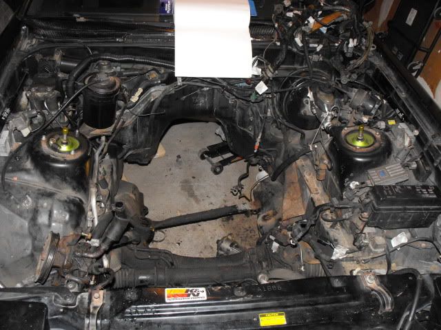

Nothing that exciting except I got those snapped studs out. Also, I test fitted the IC. Looks like I may have to adjust the height at which the coolant reservoir sits. For now I have removed it.

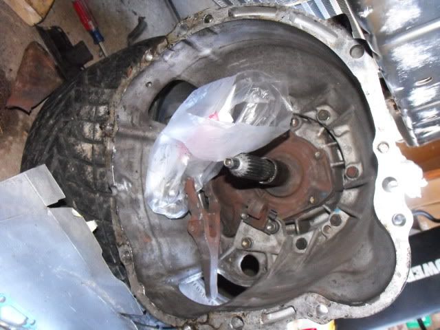

- swap the tranny/clutch/flywheel. - Not done yet, but got the clutch and tranny off the old engine.

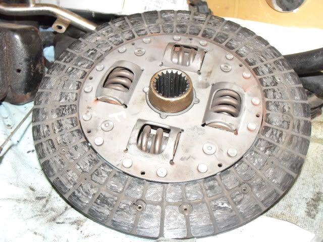

Here are some pics:
Guess I need a new clutch!?? :dunno:

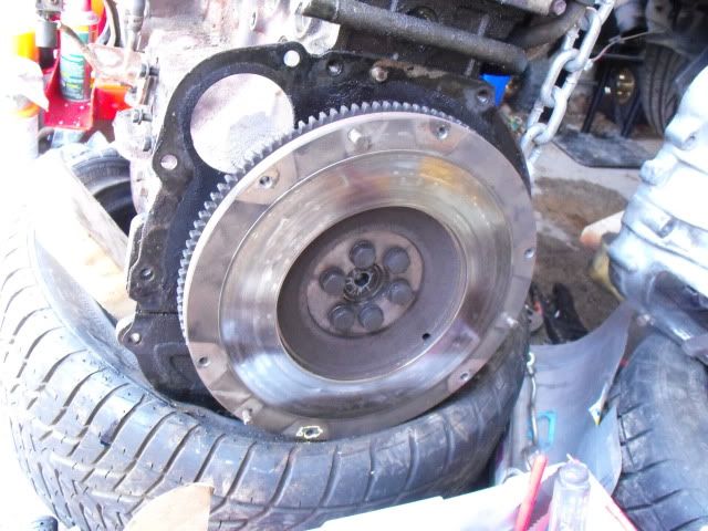

My .02 is to install a new insert on to the Fidanza, and at least get a new disk. What does the pressure plate look like and what kind of clutch kit?

Thanks Ken. For now I'm just gonna get a new OEM disk. Already ordered it from DM. ;) The pressure plate looks ok. Is there anything in particular I should be looking for? I'll get a pic up tonight. That Fidanza will run me about $400 right? I really can't afford that right now. The right now is to drop the tranny again this winter to have it rebuilt. I will definitely change everything then.

Since you're pulling the transmission in a few months, you're probably ok on everything. A few months isn't that long...
For now on the pressure plate, I would just inspect the fingers for cracks/breaks. If you don't see any, run it!
As for the fidanza, $400 is the ball park price for a brand new Flywheel. The inserts are around $80. I think! ;) That insert will get you through the summer tho.
You're getting closer! :)
