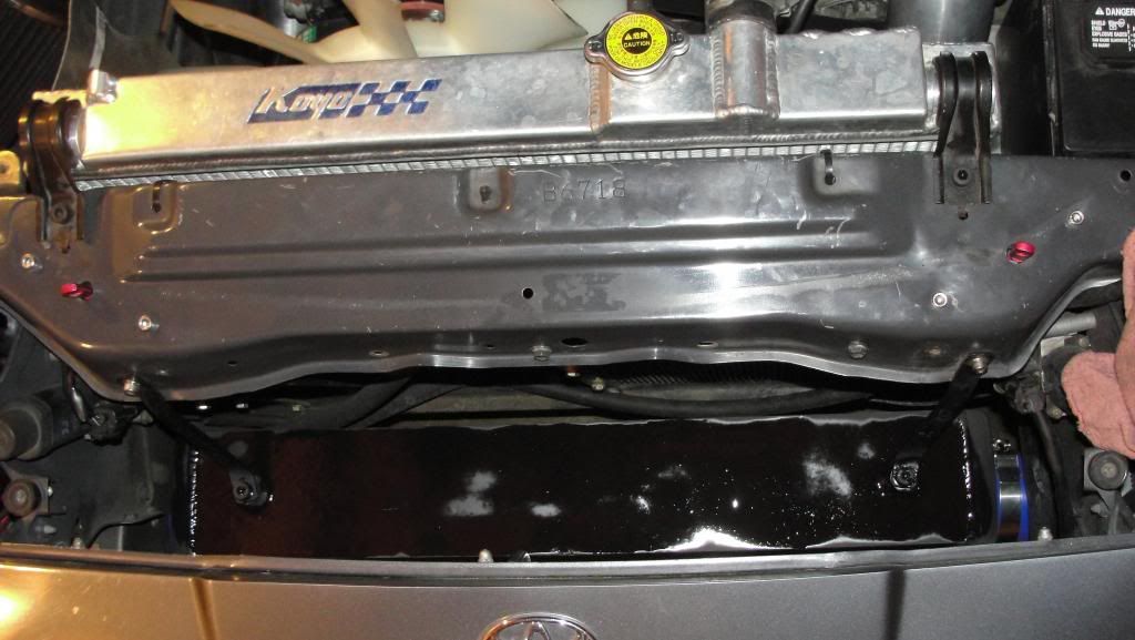

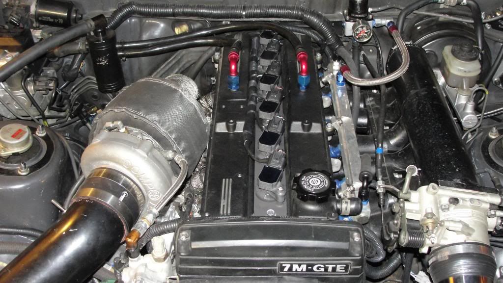

The new engine bay, complete with 3" IC piping, 1ZZ coils, and generally cleaned up.

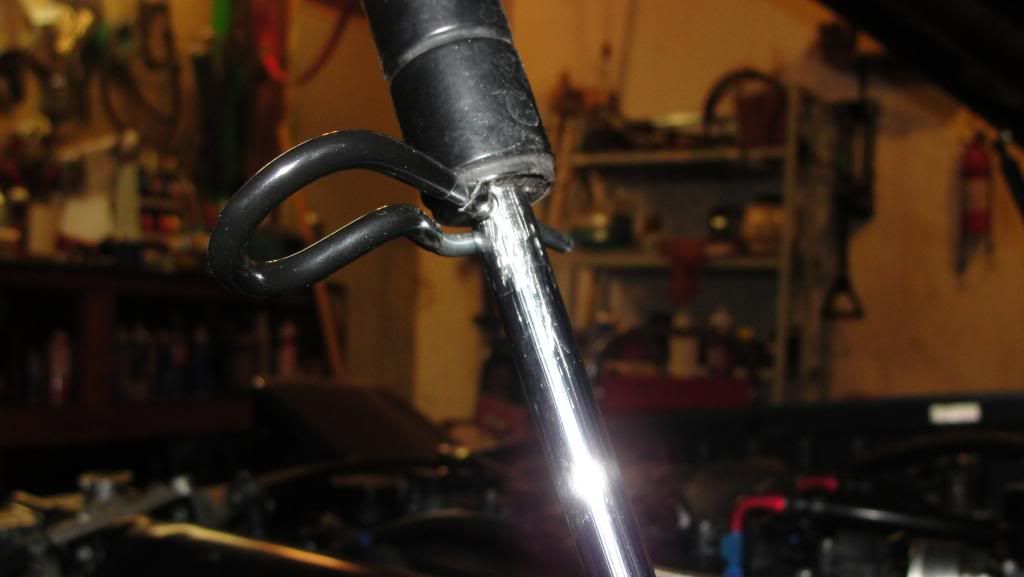

Carbon fiber hood strut mod. Blown struts plus hold and pin = Winning!

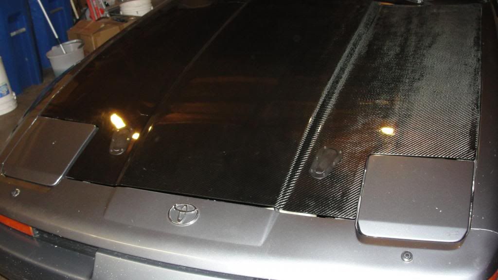

CF Hood closed with the Aerocatch pins
Deleted hood latch, which will be the new coolant reservoir home. If you look closely, you'll see 2 silver allen head bolts next to the pins- they hold the drop-down brackets the pins thread into.

wtf someone that actually installed the aerocatchs the right way! looks great.

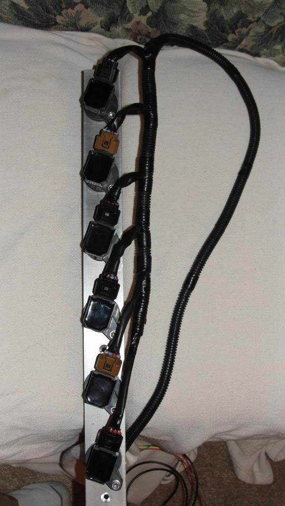

I thought 1zz coils were too tall for the 7m? where did you get the bracket?

They're a little tall, but they work. Much higher than my old 2JZ-GE vvti coils, but they should have more spark energy. Bracket was made by Albert, but I slightly modded it to fit easier.
The latches were little hairy since I've never cut into CF, but it went pretty well!

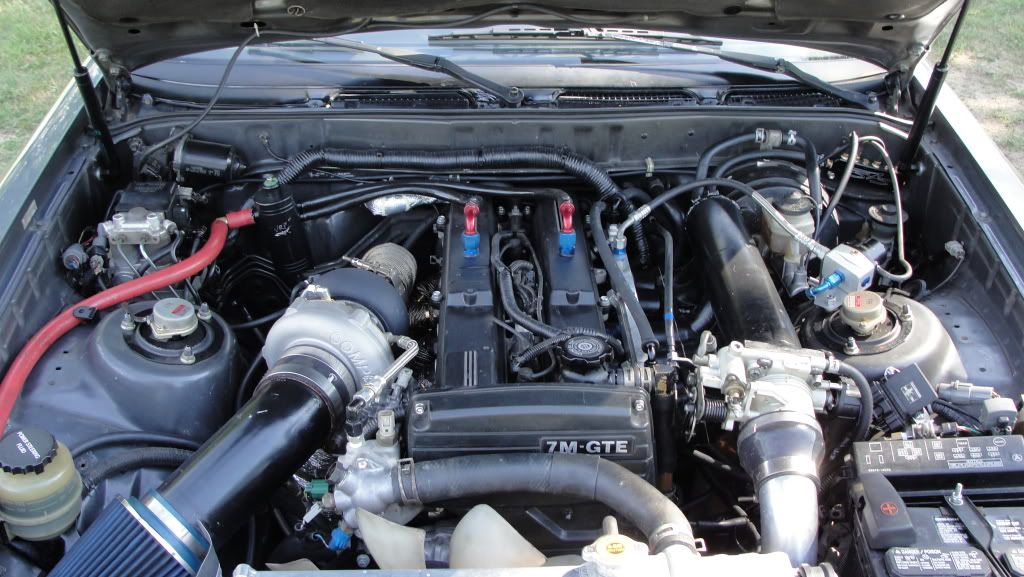

Edit best comparison picture I could find on my PB:

I had run out of spark energy last year with the 2JZ-GE coils. Once the plugs had worn to a .025" gap, it started to break up at 26+ psi boost. It was fine around 18psi, though. I have them gapped at .023" normall. Since I'm going much higher boost this year, I wanted to add some overhead. That's besides the fact I have a lot of these coils from engines I've replaced over the years.
