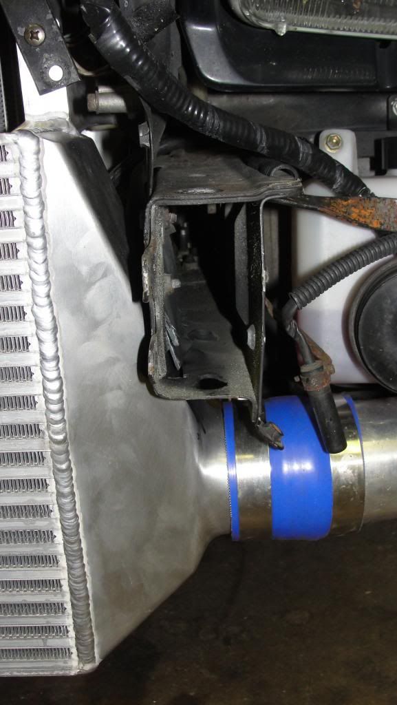

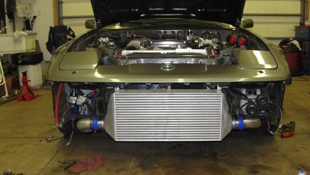

Ran at the drag strip and was underwhelmed by the car's performance. Checked the data logs and found the intake air temps were around 190*f, just a little warm. So I ordered a nice new ETS intercooler. Unfortunately, the IC was about 3" bigger than advertised so slight frame modification was needed for it to fit well D:
Final install
