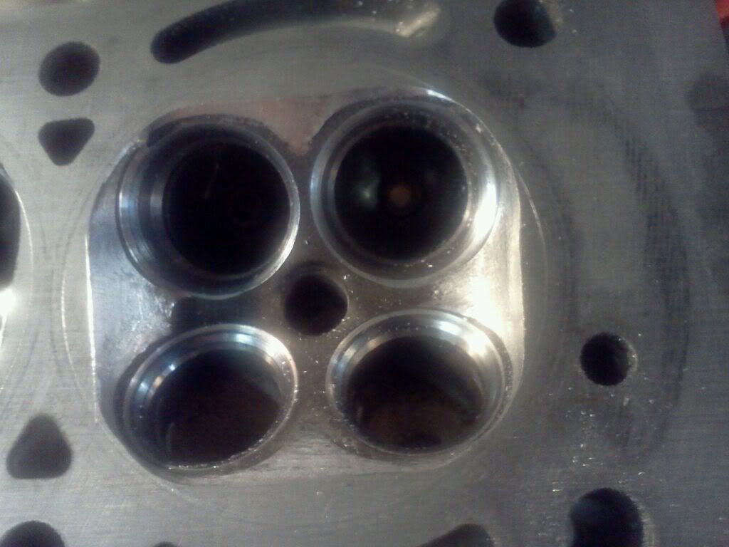

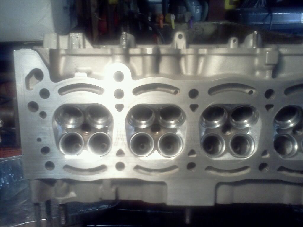

I stopped by Iner's garage today over lunch to pick up a piece from my 4" exhaust that needed his expertize. I immediately recognized the head of Steve's 7M that he was working on. I snapped a couple of pic's of the porting job. Bear in mind shitty camera phone, plus he has a ways to go, and garage was poorly lighted at the time. I have seen his porting before, and he's good, real good. The $20 is how much he charged me to not do too good of job, so my 2jz can still beat him. :evil2:

The head porting is done, so all I have to wait for now is the machine shop to finish up the valve guides and machining! As far as I know, I have all the parts to start reassembling the engine once that last bit of machining gets done!
