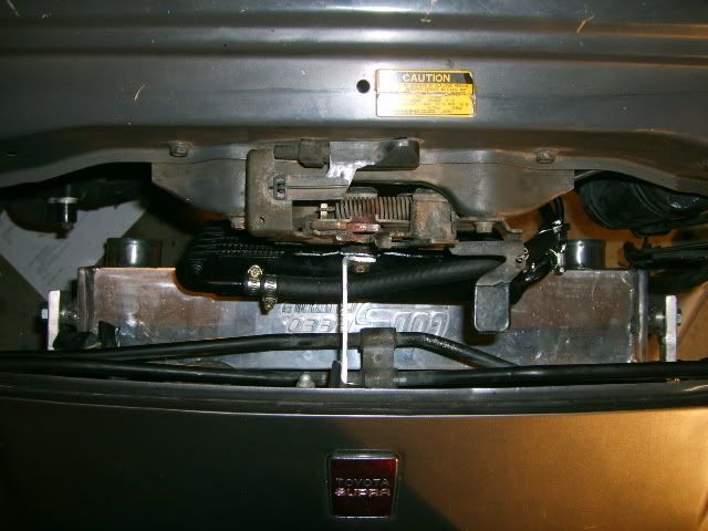

I was lazy this weekend and only got the intercooler mounted, no plumbing yet. Also started dismantling the wire harness to run the 4,5,6 injector wires to the harness ends, but I didn't get too far- I can't seem to find the spare wire harness from my corolla to use for terminals. Oh well. Later, I guess.
looks big and mostly blocked, but I will be doing a turbo-A duct (hopefully in CF!) later.

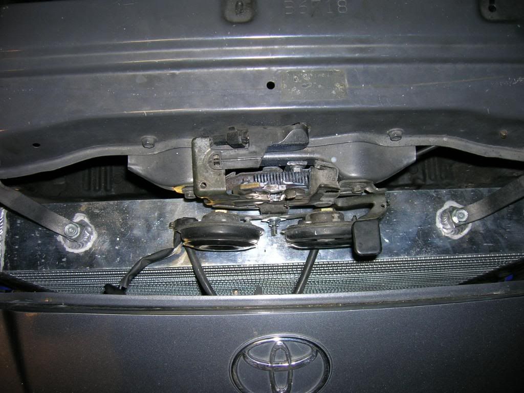

Your going to want to re-install the bracket that goes from the nose to the hood latch. Or make a new one. Go and wiggle your latch and you will see why ;)
toyotanos
What will we break today?
Nov 29, 2008
2,842
Coon Rapids, MN
Ah, I knew someone was going see that. If you look at where I mounted the horns, there are threads sticking out from the bottom of the latch... I welded the mount onto the vertical support, and it bolts onto the latch from behind. :biglaugh: Holds the latch nice and firm.
If it ever becomes an issue, I can always run a second support bar from the nose.

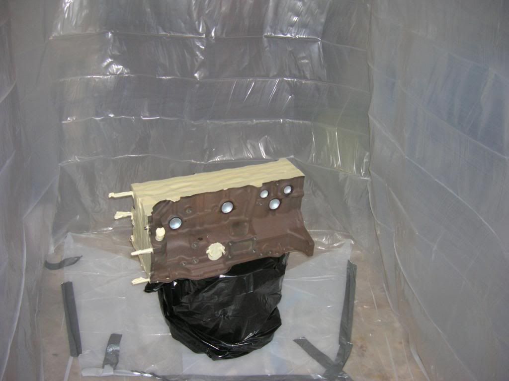

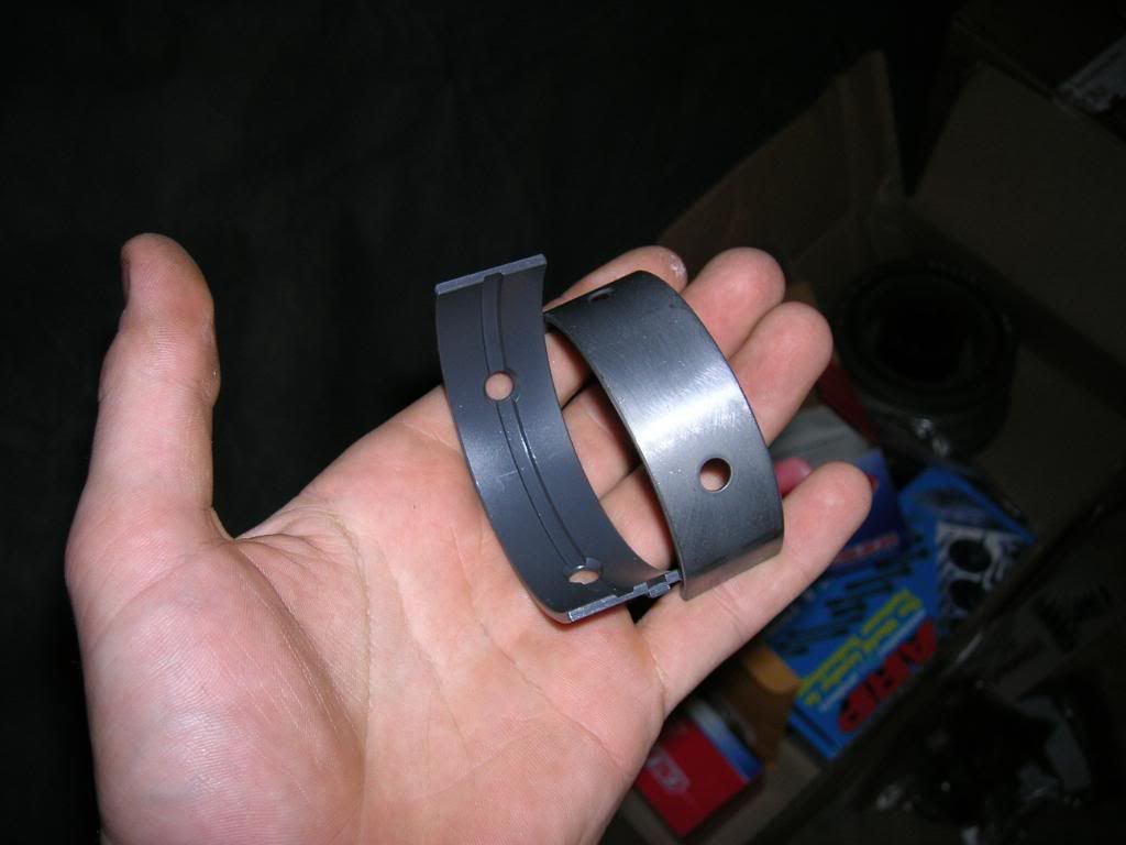

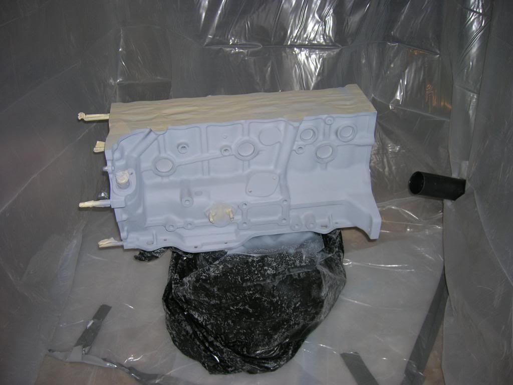

So after 3 months waiting for parts, machining, and some more waiting for parts, I finally have my engine back. Not much done yet, as I'm painting the block so it's nice and pretty! The coating on the bearings is cool, too- dry film lubricant is something of a mystery to me, yet... Anyways, that's where I'm at!
as it came
first primer coat on
Calico bearings- very interesting

Yeah, it looks really good now. I have to say- I'm not usually a detail/finish oriented guy, but something about this car has been changing that part of me. Anyways, it's on the stand and ready for assembly and final measurements! Official engine build begins tomorrow!

Thanks Sean!
Aside from the turbo oil feed boss, I'm really happy with how it turned out. Now it's just time to get it together!

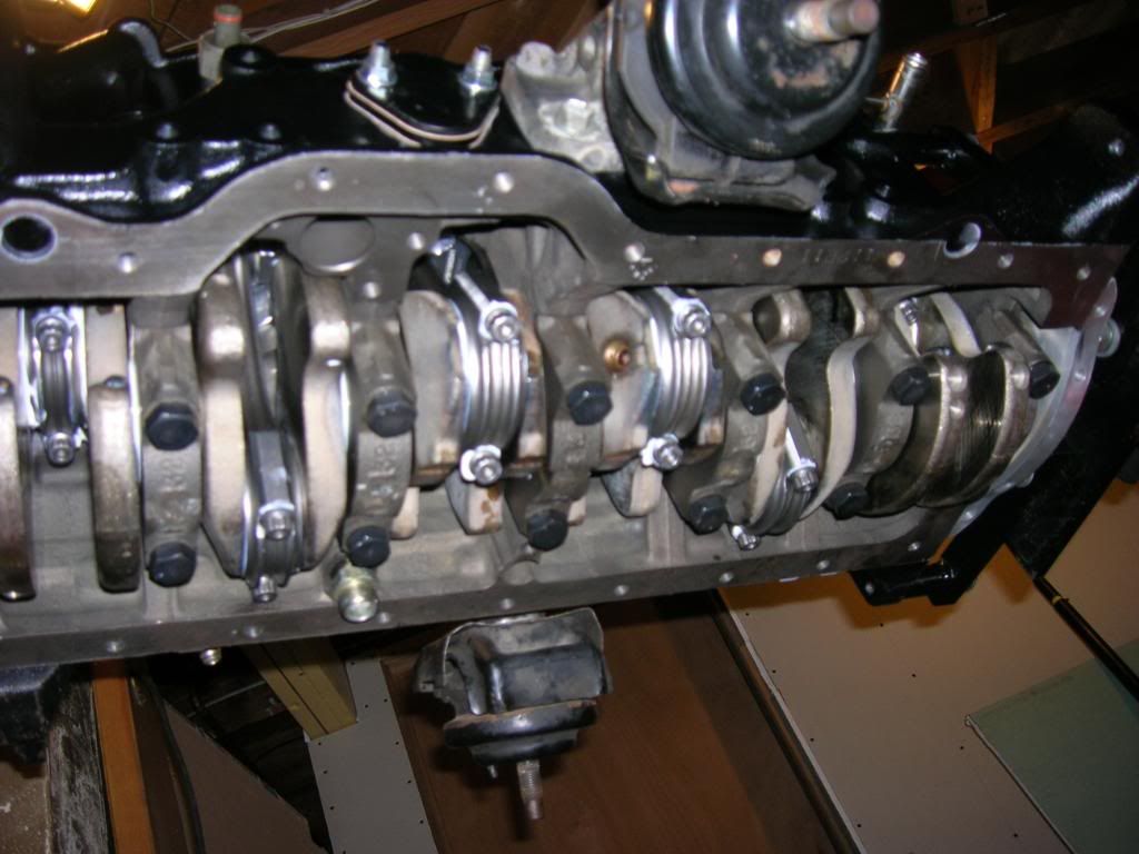

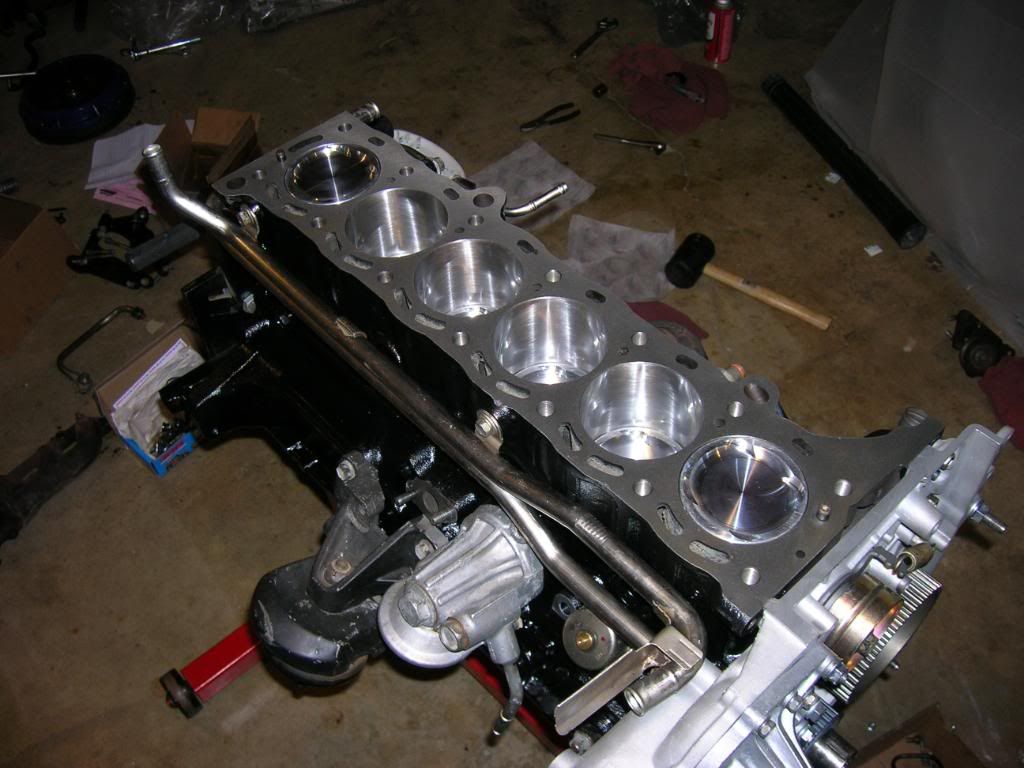

all bearing clearances have been checked and all check out good. Bottom end is done, aside from the oil pump and pan. Head goes on tomorrow night! Here's what I've got:
Feelin good tonight!
