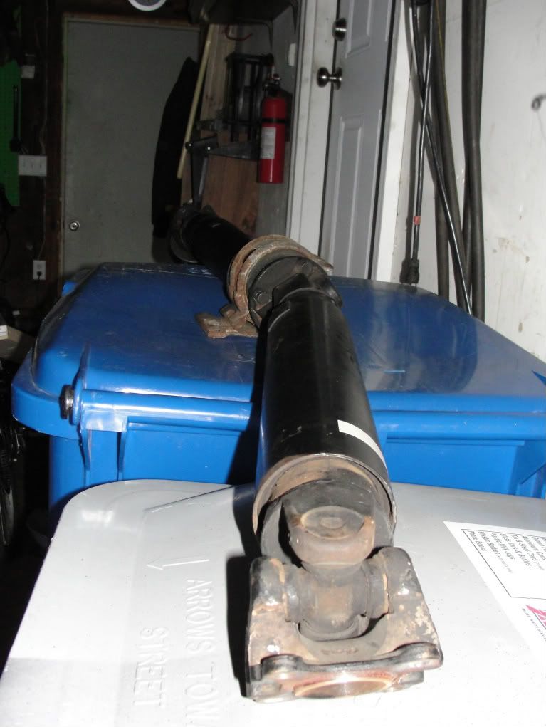

Yes I did... and nope, it died. Put about 15-20* of twist in the rubber bonded section.
I've ugraded twice, now as well! Went with a 3" jawsgear AL shaft and it was good for a couple weeks, but then the car broke. Now Im onto a 3.5" Dahn Automotive shaft since I'm going for a 4.3 rear end. (Trying to keep the harmonics in check) Should be fun once its together!

Nah, its not necessary just because of the turbo or power output, its the way you drive the car.
If you baby it off the line and shift smoothly, I bet the stocker would stand up to almost anything.
Launch it hard/drop the clutch and I'd put money on a stock NA with BHG would be able to twist it :p

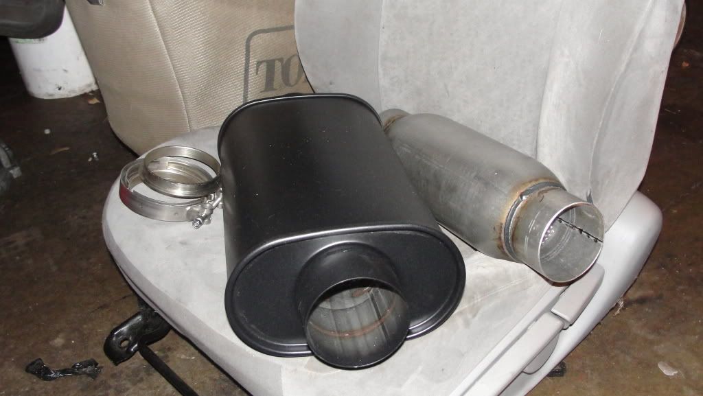

Update to parts coming in:
3.5" exhaust system is coming together, however I think it may be a touch louder than I had initially planned for- we'll see...
New 3.5" driveshaft is here and looks BOMB!

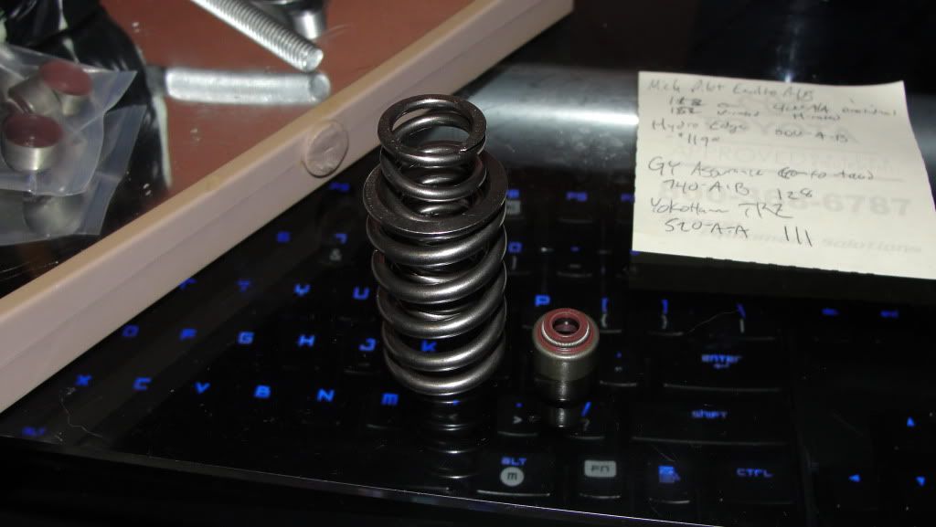

Dual valve springs are ready to install once I get the head back :D
Head is 1/2 done, and should wrap up within the next few weeks if all goes well!

Turbo Tony snapped a aluminum drive shaft, and a carbon one. He ran his 9.98 on a stock 2 piece with carrier. That's with launching it with slicks on the drag strip.

It really comes down to the wall thickness...Toyot I got to hold that DS I almost shit my pants when I lifted it...13lbs is ridiculous! I want to go with the thick wall aluminum which ends up being 13.8 lbs.

Sweet, Dustin! Wes said you guys were out there- I though it was crazy that it was so light as well. I figure that my driving habits aren't aggressive enough, nor my power output high enough to warrant any of the crazier driveshafts, but this was just a little more insurance for me once I get the NA rear end installed.
