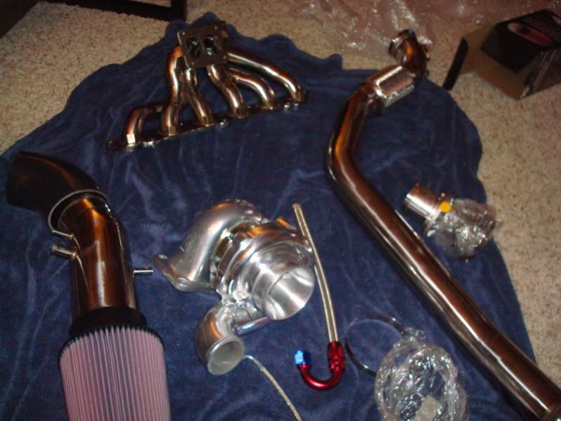

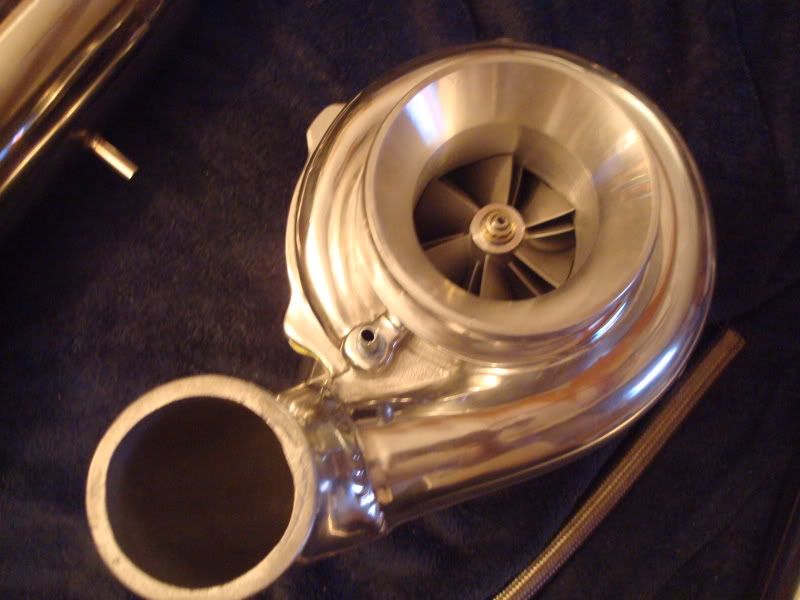

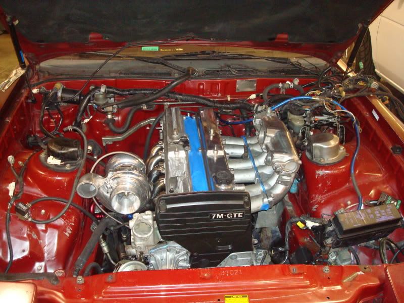

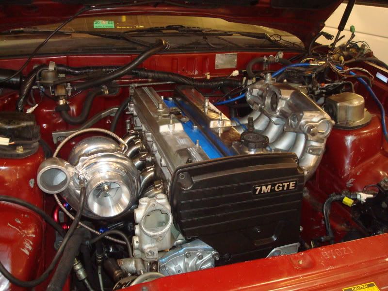

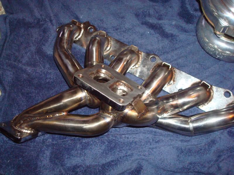

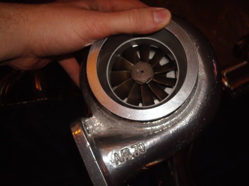

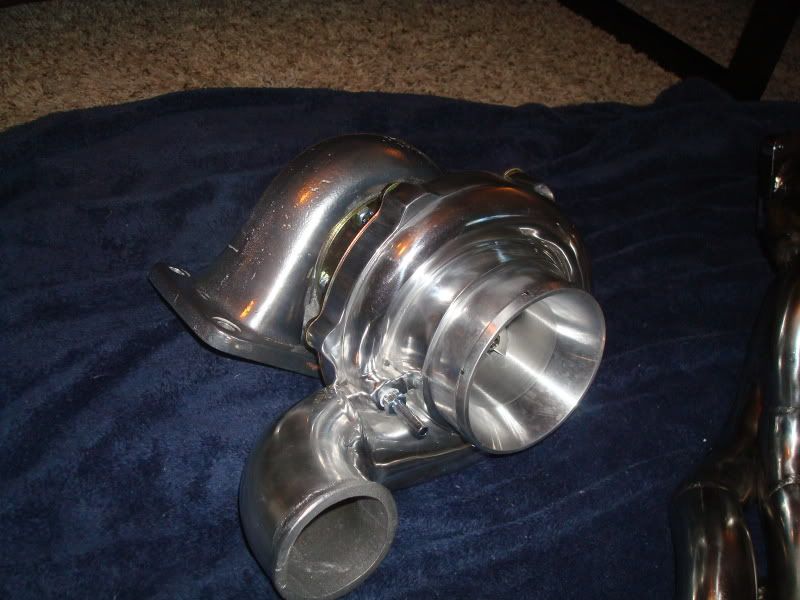

Christmas came early for me. Got some Driftmotion bling. 67mm turbo kit.
I'm really happy with how everything looks so far. can't wait to get this thing done.

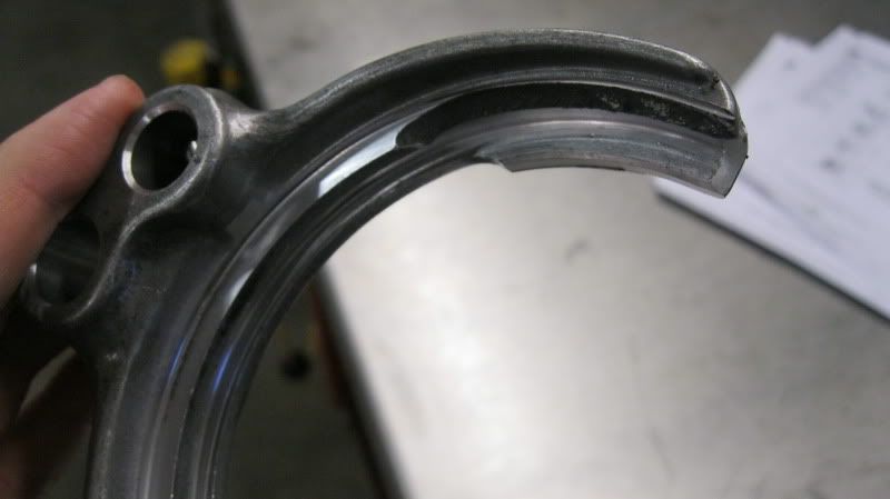

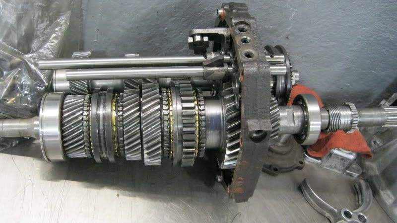

Well I got all my gears pressed back together after replacing the bearings and synchros
then found my damn #1 shift fork was broken, I don't know how I missed that earlier.
Guess I'll just get the marlin crawlin one now.:rant2:
Good job. I did my R154 myself. Check out my build thread for pictures...

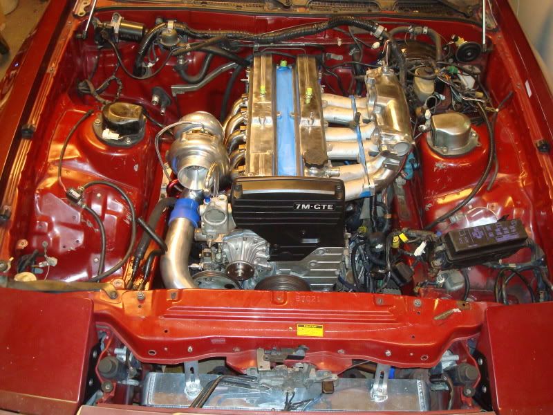

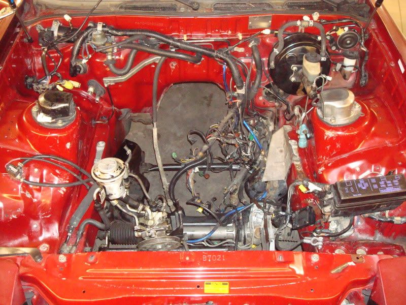

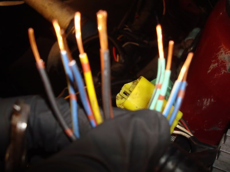

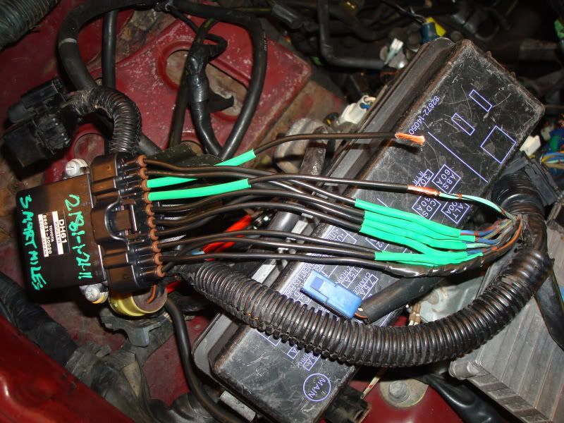

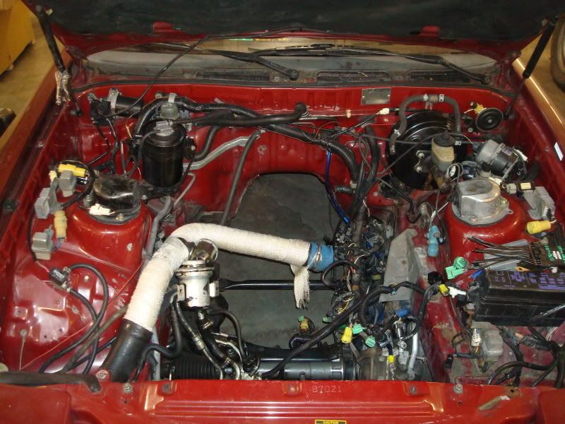

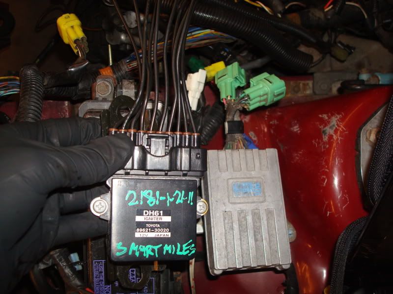

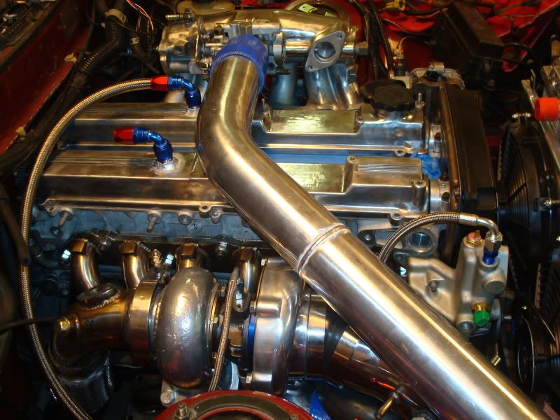

I'm still waiting for my marlin crawler shift fork so meanwhile I wired up
a DH61 igniter to remove the multiplex and cleaned the sh%t out of the
engine bay. Here's more pics.
Blackdawg
Taco Soup..my rides
Oct 12, 2010
247
Wyoming
Lookin good man!
glad to see another fellow 7m being built :D
i got the same turbo kit :) sept i went with .58 AR

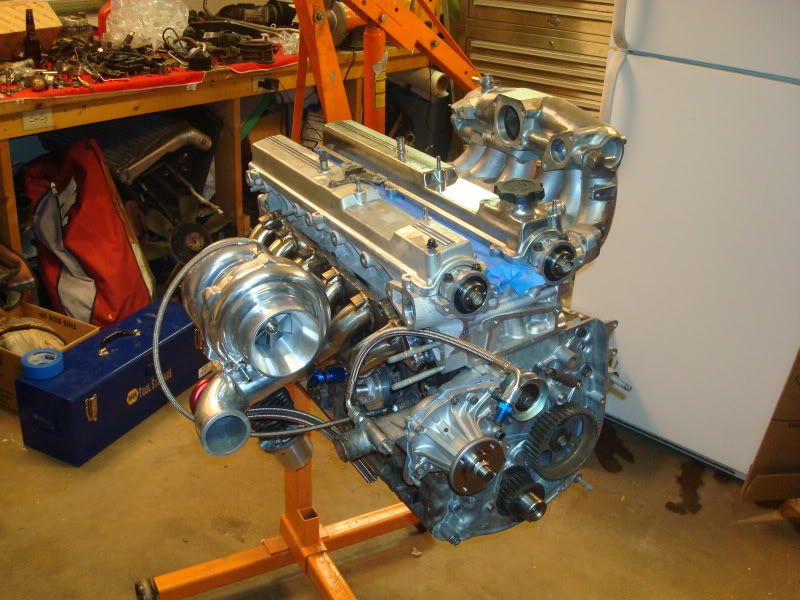

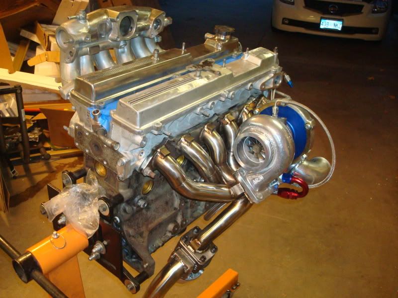

Back in May I just layed the engine in, nothing was really bolted together. I pulled the
engine back out and installed the Driftmotion exhaust manifold stud kit, full flow oil
cooler setup, shimmed the oil pump, finished rebuilding the transmission, mounted the
intercooler. Progress has been slow, but I'm really gonna step it up, I have a baby
girl on the way.

With a fresh engine like yours i would skip the catch can. I have about 2500 miles on mine and theres zero blowby. Nothing in the pcv or charge pipes.
+1 on getting the car done now, once that kid comes free time is out the door.lol

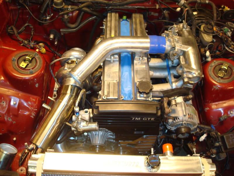

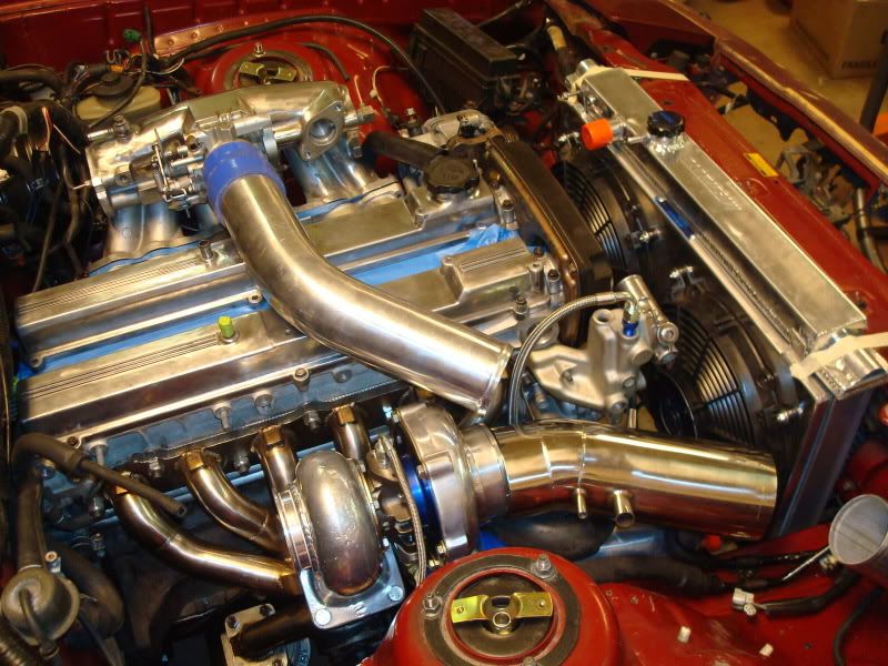

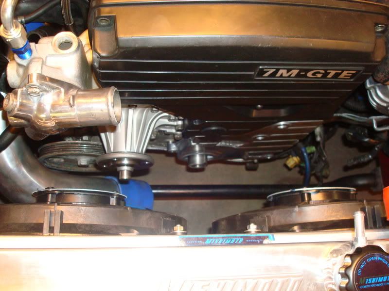

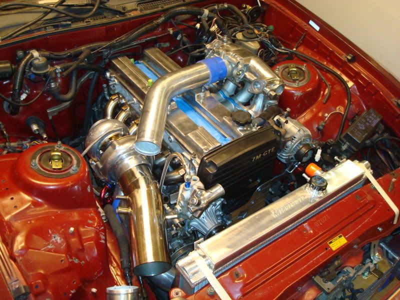

So just got my Mishimoto radiator, fan shroud w/electric fans,
IS300 coils, and dual stealth aeromotive in-tank pumps (thanks
for the idea Toyotanos) Here's a couple pictures.

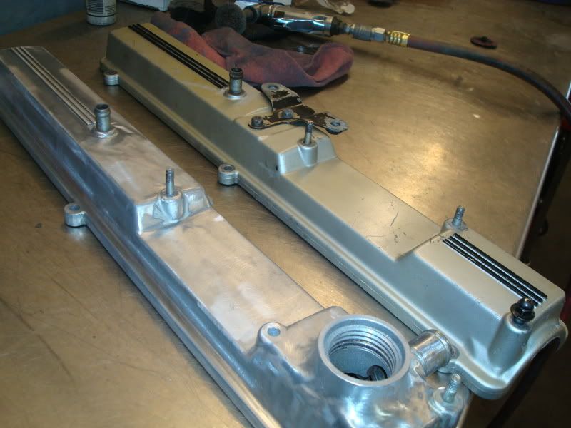

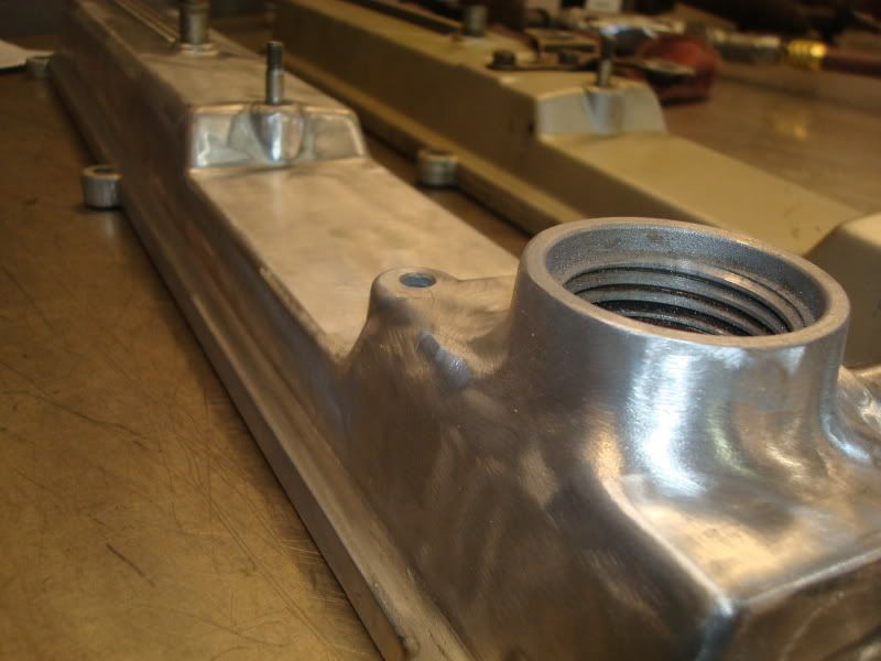

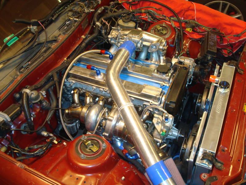

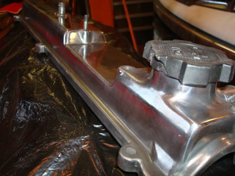

Got some AN fittings welded on my valve covers and intake pipe for my catch can. Just got my injectors and
SH!t load of braided hose, AN fittings, and fuel filters for the fuel setup.
