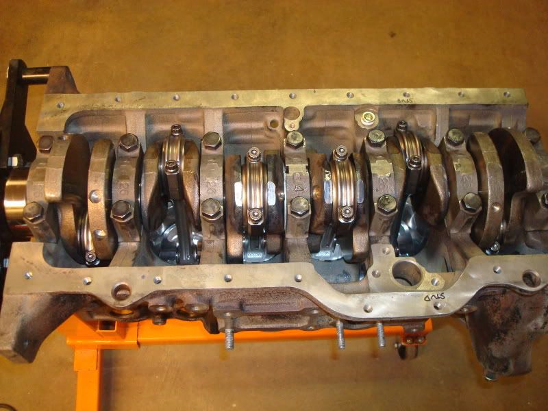

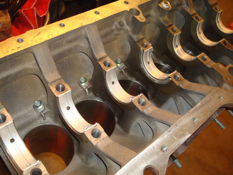

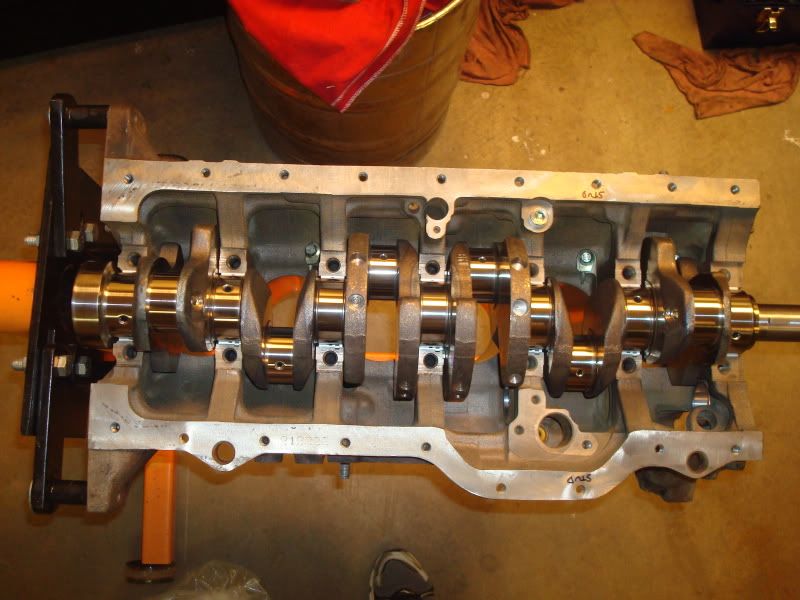

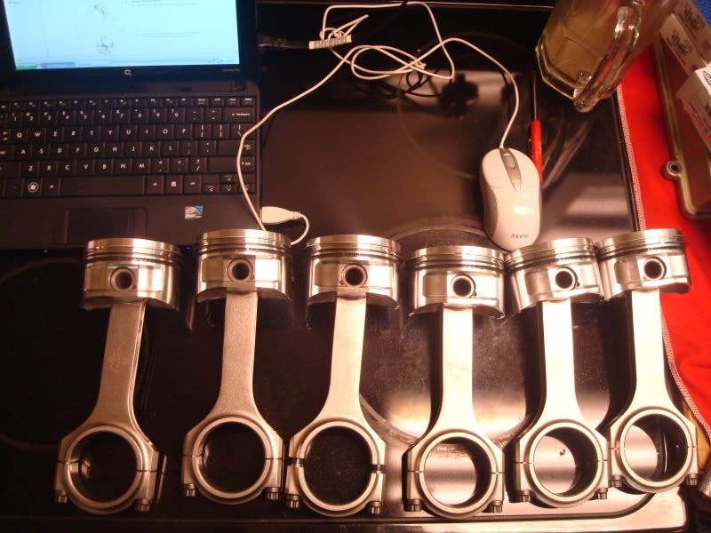

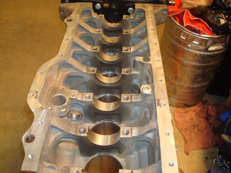

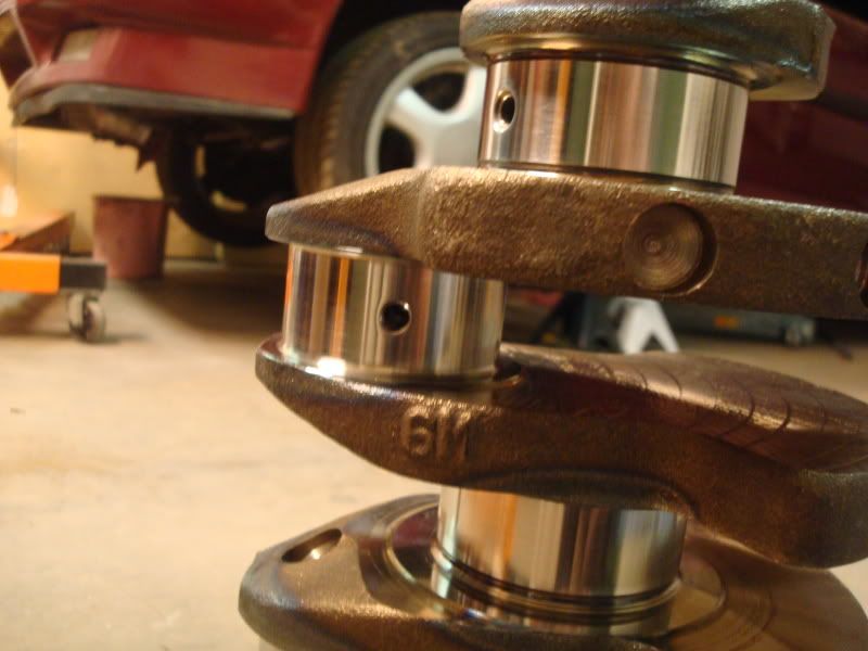

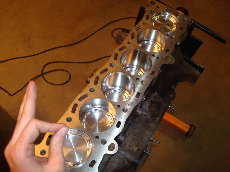

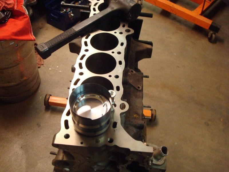

Made some headway. Got the block mostly assembled, worst part was
getting the ring end gap correct. I'm happy with the way the machine
work came out. Here's more pics.
