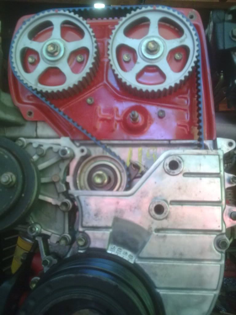

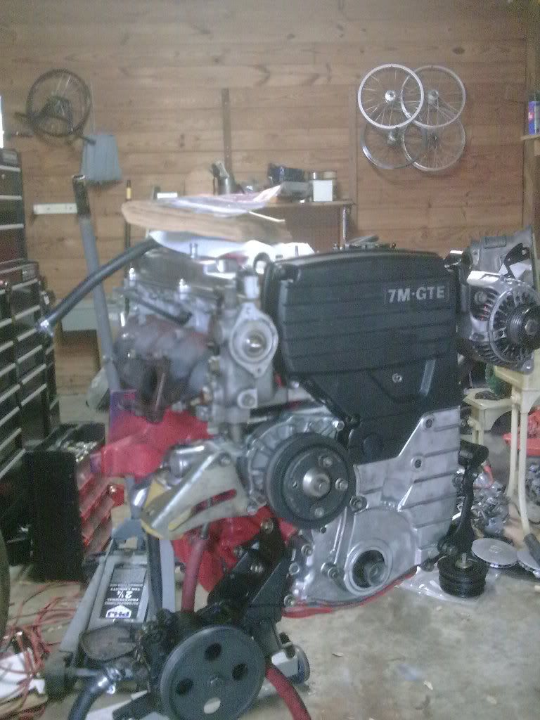

motor as of today. i hope to have it done this week and in the car next week!

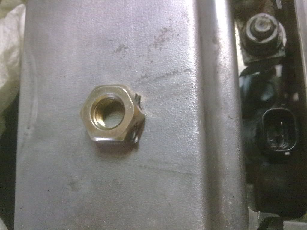

i have already snapped 2 bits trying to drill out the nut for safety wire
this is what i want
sexy blue t-belt

Is that a performance timing belt? lol
