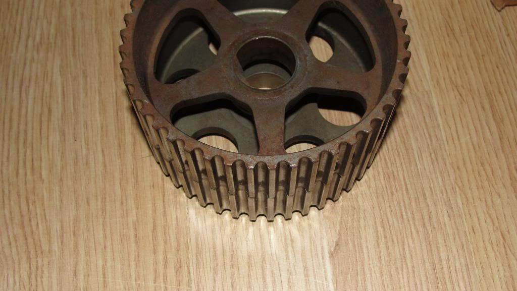

The 5m oil pump gear does fit with the spacer. The teeth are identical. Toyotanos is running one without a problem.

NegativeGeForce;1996061 said:The 5m oil pump gear does fit with the spacer. The teeth are identical. Toyotanos is running one without a problem.

Edit: Ah - steve beat me to the comparison pic! Yeah I found the same gear on ebay. I am sure Ryan is probably right and there's only 1 or 2 years they made these gears on the 5m.
