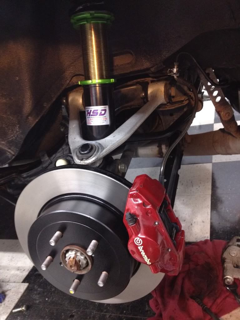

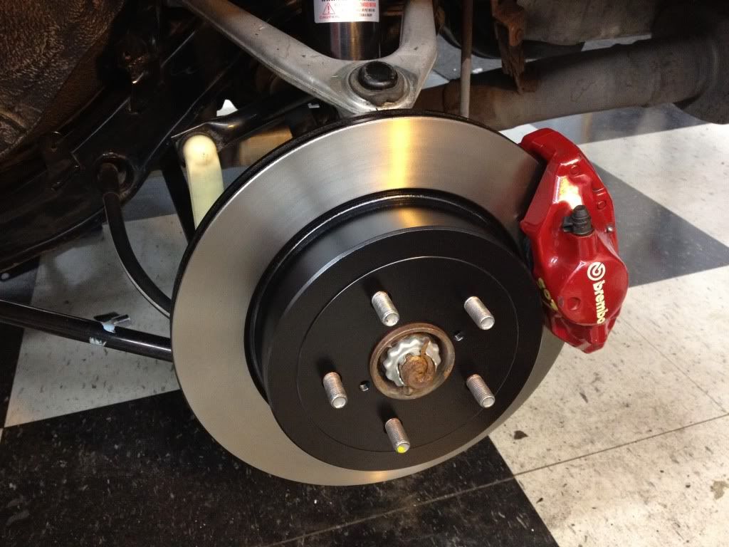

I finally saw one of the STI hubs and it is stepped. Inner step is 58mm for the rotor and outer is 56mm for the wheel. I just machined my hub down to 58mm and machined a small releif on the ouside diameter to clear the step on the inside of the rotor. I then bought. 73mm x 56mm aluminium hub centric rings for the rear wheels and opened up the ID to 58mm to fit the new hub. Now I can buy new rotors and not have to make any adjustments.

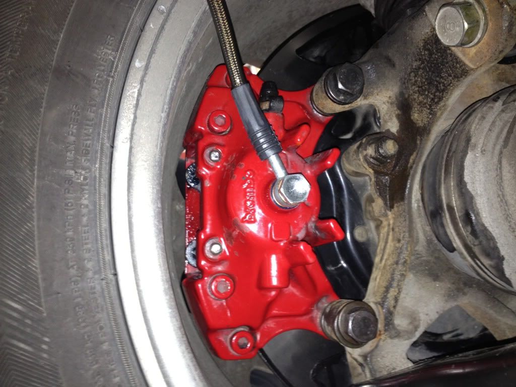

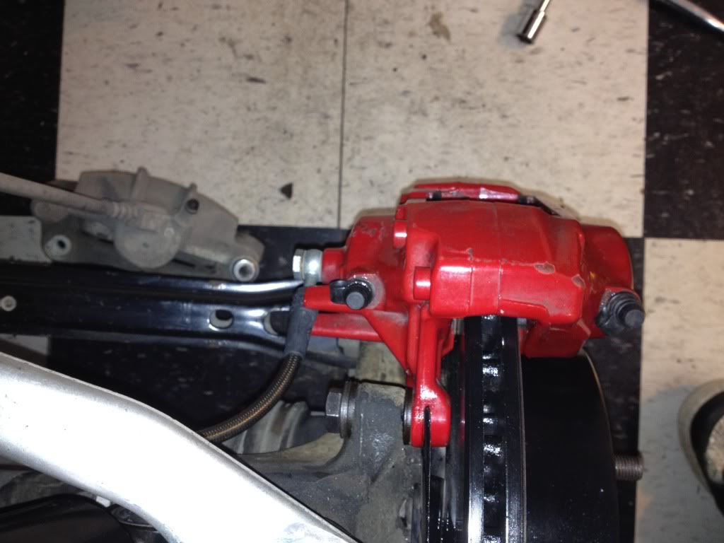

Well, I completed this but totally forgot to grind that backing plate down, and what an AWFUL noise that makes haha.
It's such a HUGE improvement though, especially with my Wilwood 13" front kit.
I used 3mm washers, Agency Power Evo lines, M10x1.5x40mm grade 10 bolts, and Stoptech rotors and pads.

The backing plate is right behind the e-brake assembly. The actual best way to avoid this is to have the lip in the rotors (the one that runs the plate) milled down about 2mm or flat to the rotor face.

It will still foul all sorts of noise on the bearing back plate unless the STIs rotor lip (located on the back side) is machined off as well..
Dylan JZ
一番 King
Oct 18, 2007
2,220
湾岸せん
I thought that would be possible originally, but it doesn't create enough clearance unfortunately.. Mine still made tons of noise when the hub deflected in a hard turns, thus machining the rotor is the only way.
That said, I LOVE my BBK setup with these rears. It is pretty much badass haha.
