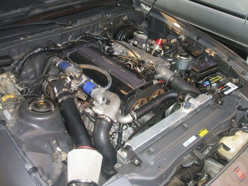

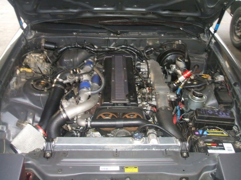

Couple pics of the upgraded 12b's installed...
I'll get a better side view pic later today or tomorrow, just got back from the gym and don't really feel like moving at all. Those pics are with the stock FMIC, I've gone with a larger unit, and have hardpipes now but wanted to post those to show that you can use the stock IC piping and IC with USDM 12b turbo's.
Dyno numbers soon to come, trying to get several other issues taken care of on the car first.
