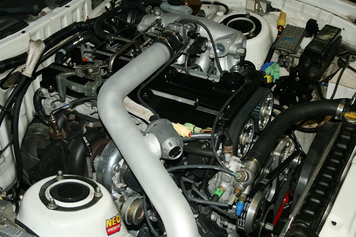

003.JPG[IMG]
As promised here is the engine, installed and almost ready for a baseline tune, then off to the dyno for a fine tuning. Thanks for looking. Van

Excellent build! I like how you got EVERYTHING coated. I noticed in the engine pics that you still have the stock filter head attached. Will you be running the stock pressure based setup or did you switch to a thermostatically controlled setup?
Van
87t Hardtop
Mar 26, 2006
974
Oak Grove, OR 97267
I switched to a RX7 thermopellet oil cooler, yet to install and connect. I will remove the pressure activated valve. Then the oil will flow under pressurre to the thermopellet and by-pass into the oil pan. When the oil temp reaches critical temp (at 180 degrees) the thermopellet opens allowing the oil into the cooler and back into the oil pan. After the oil reaches a safe temp, the thermopellet slams shut, the oil in the cooler remains there under pressure, until the critical oil temp is reached and the cycle starts again.
I had everything coated to keep out the heat, and I'm told that it will also help in the longevity of the parts as well. Thanks for your interest. Van

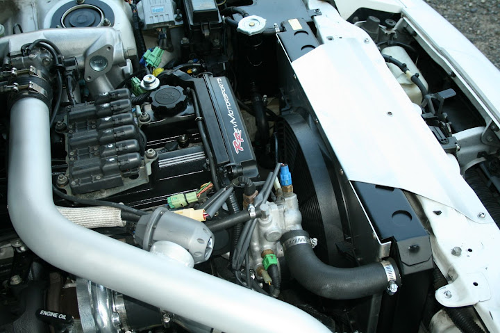

Here is a pic of what the engine looks like installed in the engine bay... There is more in the Supra Build Up Gallery "Sticky" Supramania's Elite Engine Bay thread... Search for Van, in the thread. Thanks for looking. Van
