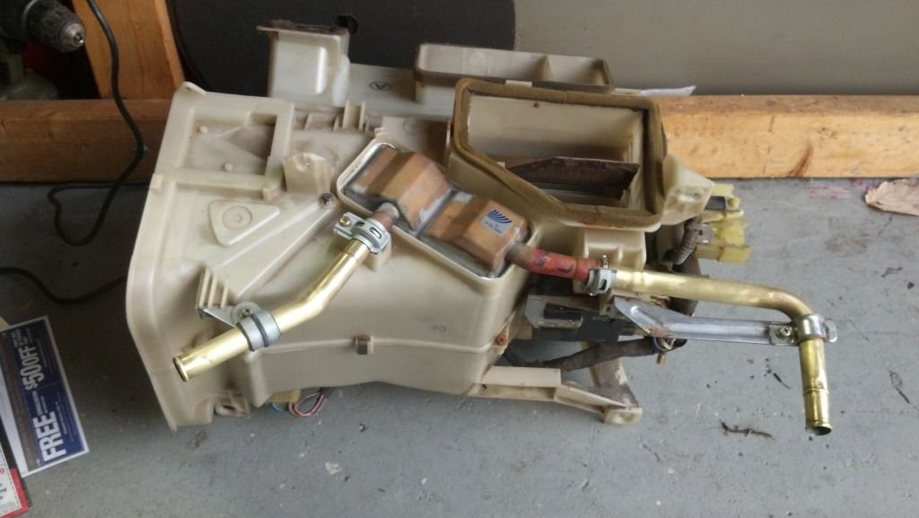

I found after removing my heater core from the box(which is very easy- just two hold-down screws), that my core was spotless, no leaks.
However, I did find the source of my glycol-smothered carpet:
A tiny crack, along the inlet pipe extension. My understanding, is that the dealer no longer carries these pipes, so I'll have to look for a used replacement.
I may end up back at that junk yard again tomorrow after all...
Oh- And this is the new heater core. I've had it sitting in it's box, waiting for more than 10 years.

The O-rings actually looked great, but yes- I will replace them.
Unfortunately, I can't just use generic rubber O-rings. These seem to be narrow, so that they fit withing the pipe flange.
Gotta hit up the dealership tomorrow. Next up- AC core box removal.

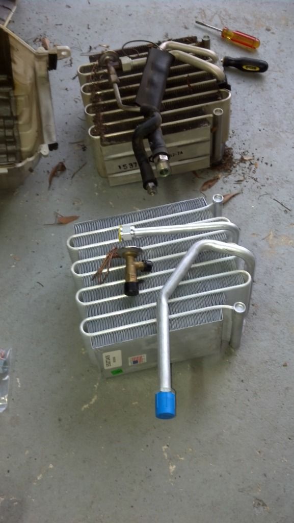

So, I got my NINE DOLLAR pair of o-rings today, so I finished up the heater core box.
Next, I pulled the ac box.
Old vs. new:

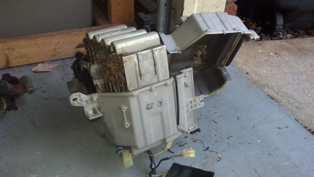

Yeah, there was quite a bit of junk in there.
Can't wait to open box #3- The fan motor. I imagine that gets the worst of it.

So, i got the ac core box sealed back up. Next is to pull the fan motor out, just to make sure it's clean in there.
Then i'll remount the ac box and the heater box.
