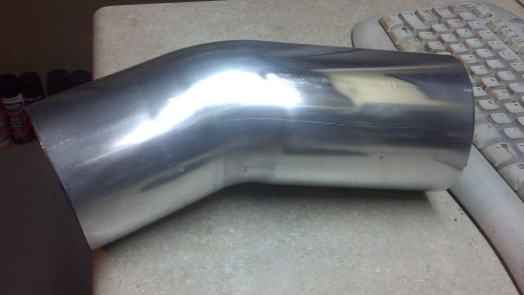

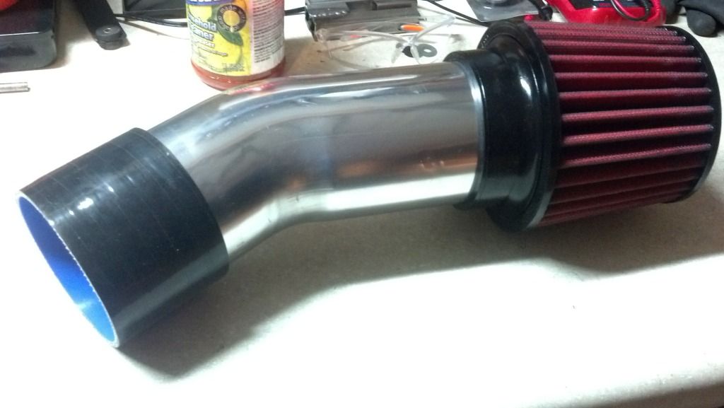

Today I received my 4" 30 degree intake pipe.
So I cut it:
And I test-fit it with the AEM dryflow filter:
Thankfully, the 30dgree angle is perfect for the space I have. Next, I have to get the fab shop to tig in the power steering idle-up nipple to the underside. Then I'll polish it and call it done.

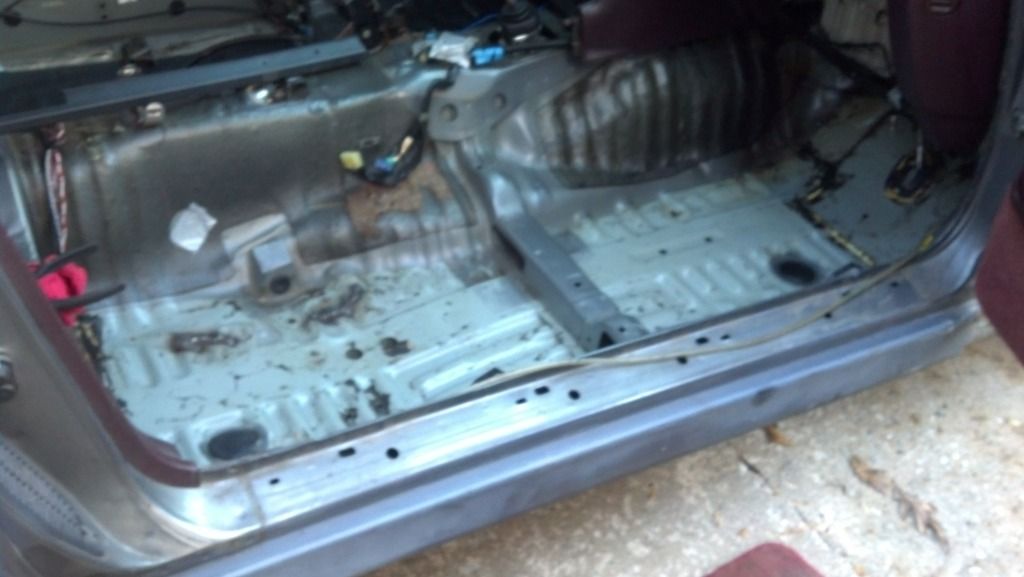

Today, I went to the local Caffeine&Octane show around 8am, just to drool over a couple hundred cars.

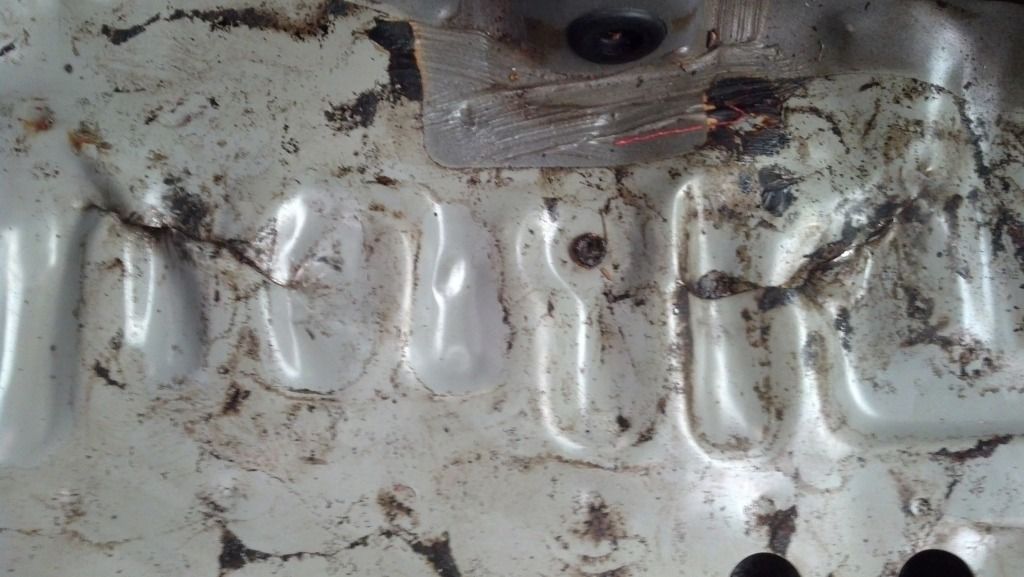

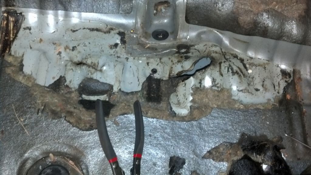

When I got home with a slight bit more motivation, I decided to hammer out the two cuts in my passenger floorboard.
Before:
After:
Good enough to allow me to weld it back together.
Once I had done that, I headed over to Home Depot and rented a pressure washer.
While I have the exhaust out(hopefully for the last time), I wanted to degrease the entire underside prior to undercoating it, so I decided to kill two birds with one stone.
Spent three hours cleaning my driveway and front steps, then rolled the Supra out of the garage and degreased the underside. Also, I washed all of the dust and dead bugs off the car. Next, I will undercoat, and reinstall the exhaust.

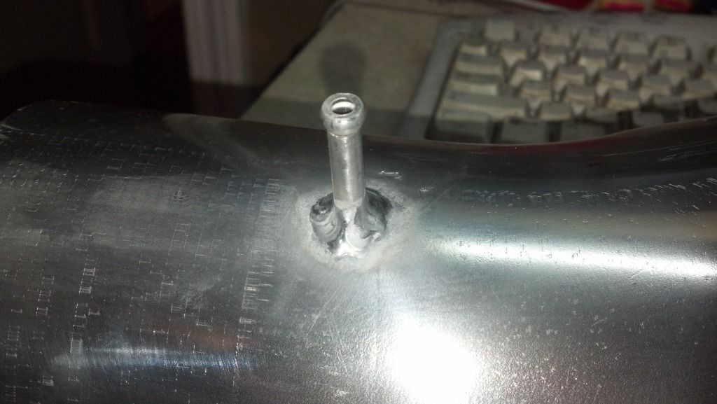

Not much time to do anything today, but I did get the vac. nipple welded onto the intake pipe at the fab shop.
then I polished the pipe, ordered some clamps for it, and turned off the garage lights. More work next week.

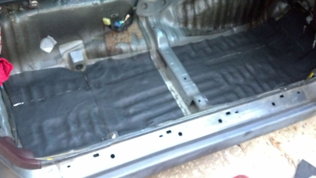

Got the driver's side floor finished with some new deadener mat, and I'll finish the passenger side tomorrow.

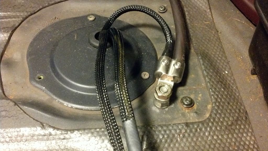

Also going to undercoat the car while it's out of the garage. Today I just ordered a few small electrical parts, and tied a couple of grounds together.
Amplifier and fuel pump grounds:

Did a few things today.
After raking the yard, and replacing the fuel lines in my leaf blower, I pulled the car out of the garage, to finish the sound proofing.
After removing the oem panels:
After installing the GTmat:
This stuff is designed with a sandwich of aluminum heat shield, as well as 1/4" foam, all bonded together with 2 layers of butyl. It reduces resonance, but not necessarily Db's. When I order the carpet, I plan to add optional mass backing to it, along with standard jute padding. Should reduce noise quite a bit.

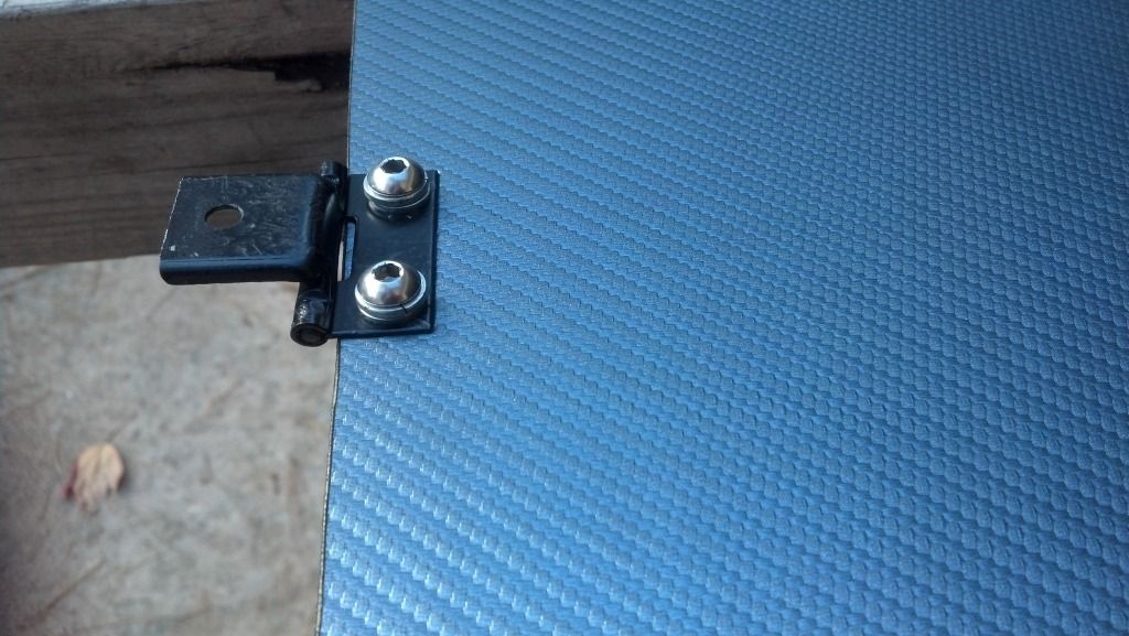

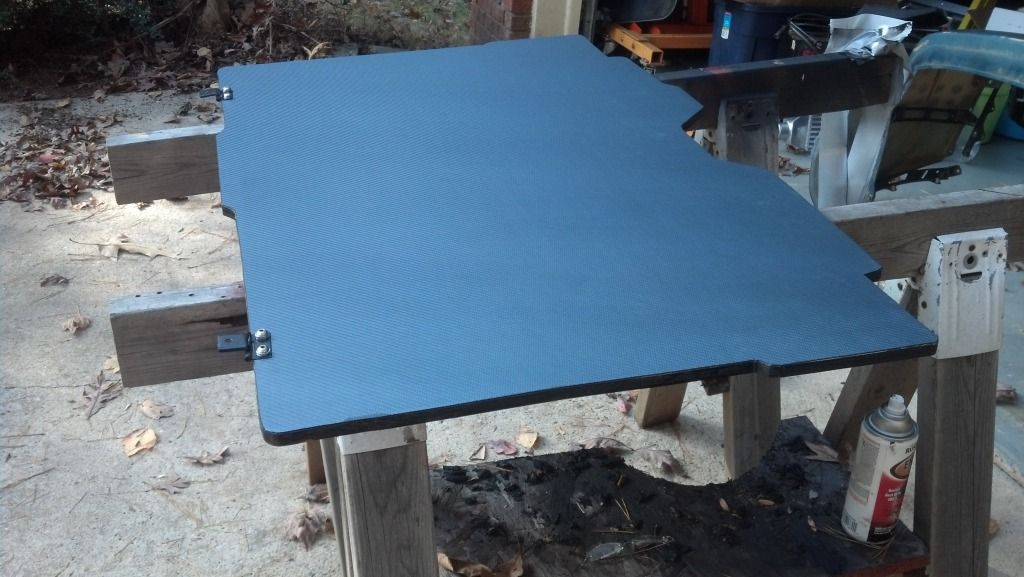

Also, I heat-wrapped the exhaust just prior to the cat, to insure a longer life for the speedo cable as well. And lastly, I finished surfacing my hatch floor.
Came out pretty good, and is now ready for the stereo equipment.

Grandavi;1976497 said:
Love that cargo cover (w/e its actually called) Much better than the plywood one. What material did you run with? I know you mentioned it a bit farther back..
Looks like it's vinyl wrapped plywood. Lots of love went into that. Looks awesome.
supraguy@aol
Well-Known Member
Dec 30, 2005
4,239
Atlanta
That is correct.
Its still plywood, but it's birch, and twice as thick. I moved the hinge from over to under, to raise it about a 1/2 inch as well. Wasn't sure how much room i'd need for the cap, amp, etc.
