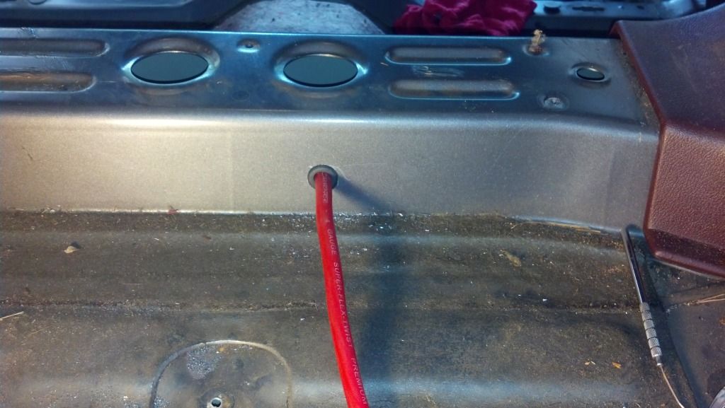

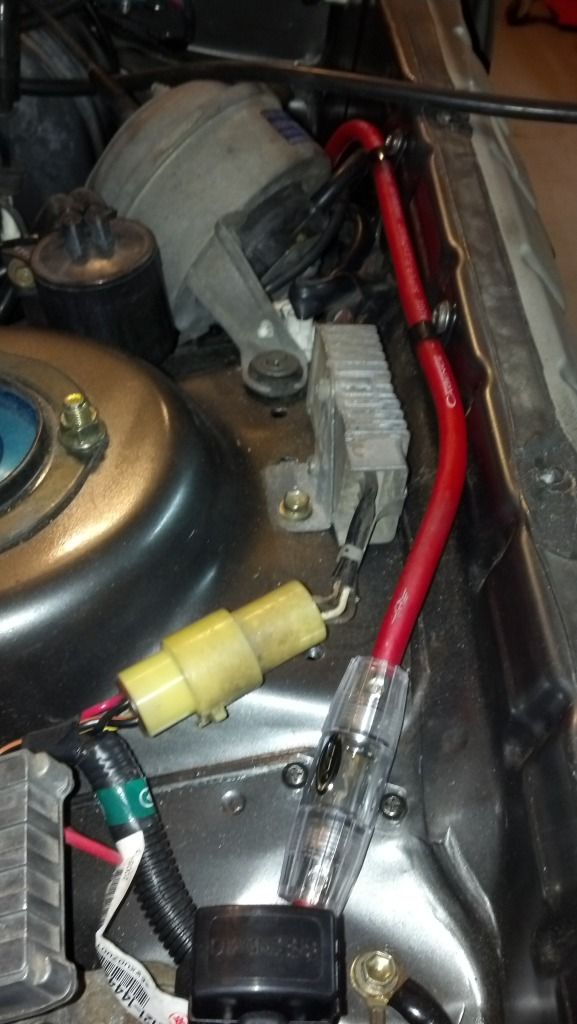

All electrical stuff, mainly. I began installing my main power line to the trunk area, that'll be powering both the audio system, and the fuel pump.
I'll be stripping some of the interior down tomorrow or the next day.

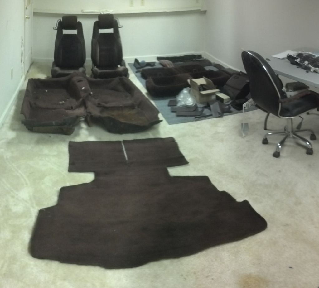

My interior now lives in my basement.

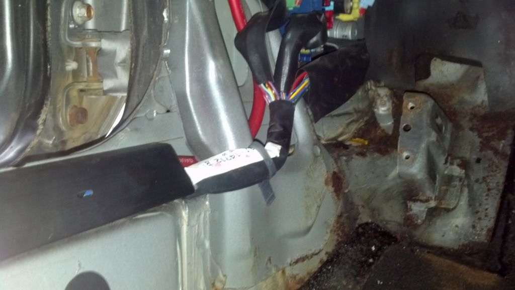

Car is almost empty now. Decided to gut it first, so i could deal with wiring now.

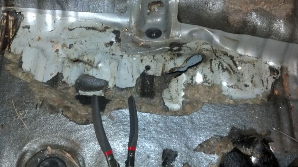

And, found a small issue on the passenger floorpan.
Thos are actually two seperate cuts to the pan. I knew that there was a big dent there from driving over a rock like 12 yrs ago, but i didnt know that it actually pierced the metal. Looks like i have to do some more welding.
that must have been one hellva rock. ive straddled some debris before but never boulders lol

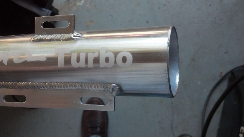

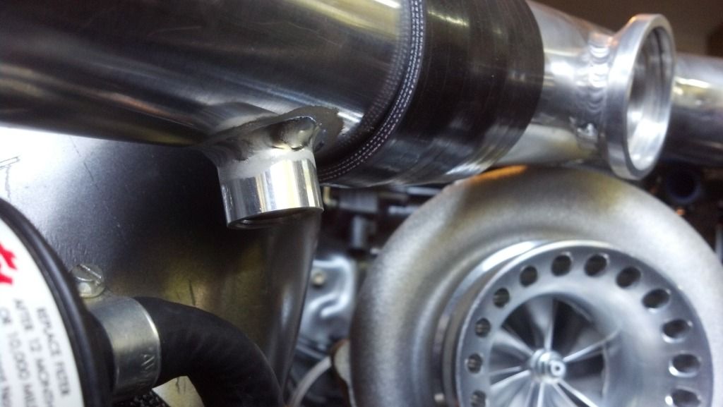

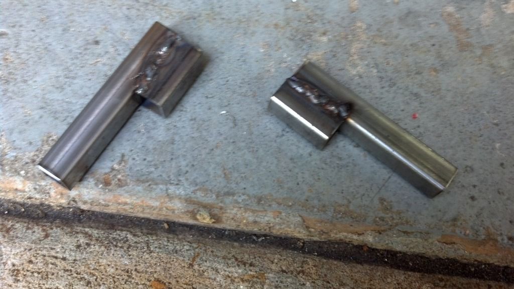

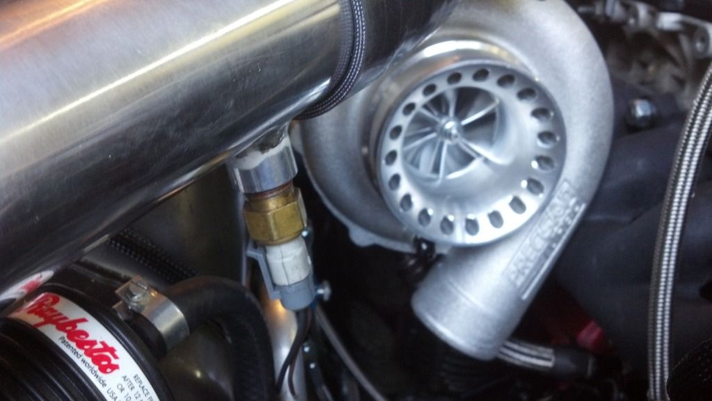

Today, I tacked up the upper turbo brace, and dropped that off at the tig master's place, along with some 3/8 stainless rod, to be shaped into the exhaust hagers(I don't have an acetylene torch in order to heat them enough). While I was there, I picked up my IC pipe, that he had tig'ed a IAT bung on. Then I cut down the excess inner lip on the front bumper reinforcement, in order to make a bit more room for the intercooler. Also, did a quick weldup of some upper IC mounts, out of square tube. Those will be welded to the top of the bumper reinforcement. Also, I cut about 1.5" off the upper IC pipe, as it was made too long(DM kit). After playing with the fitment of the lower IC pipe(that connects to the compressor outlet), I realized that I need about 1.5" added to that. Guess where the material is coming from? :)
IAT position:
Upper IC mounts. Need to be painted once mounted.
The cut end of the upper IC pipe, and a pic of the lower pipe. You can see how it needs to move back about an inch.

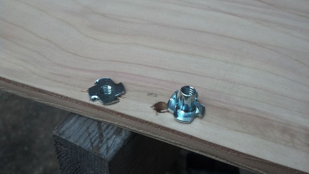

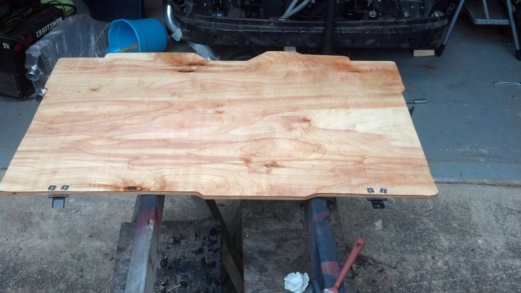

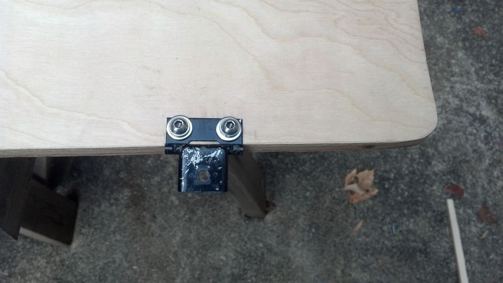

So, while waiting for TIG work to get done, and parts to arrive, I played around with carpentry.

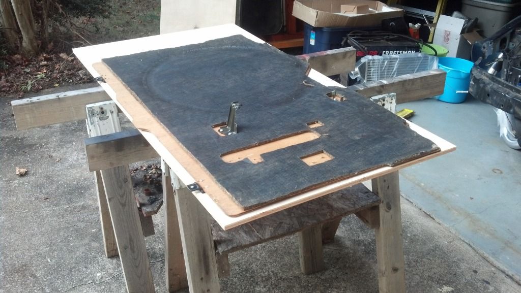

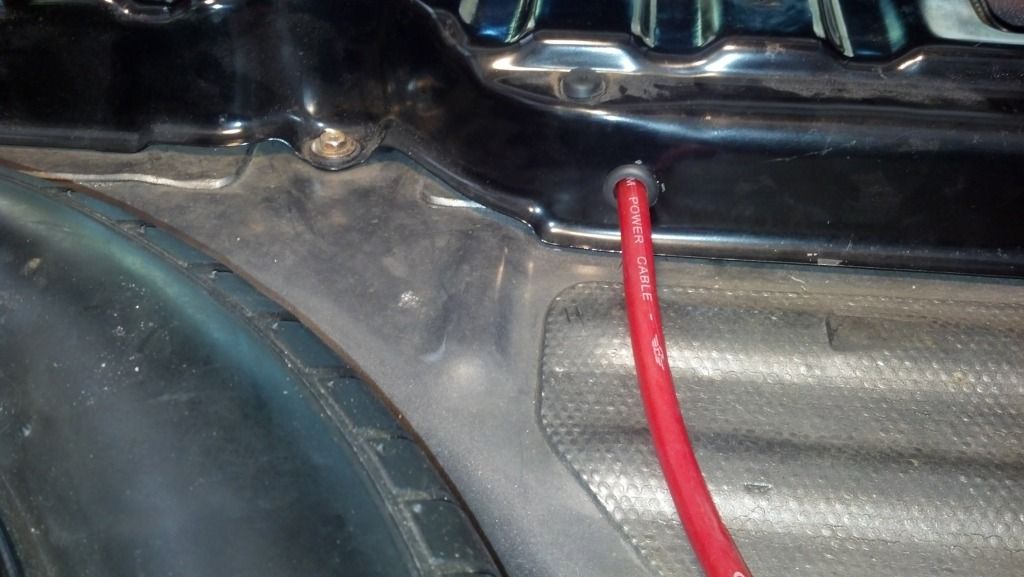

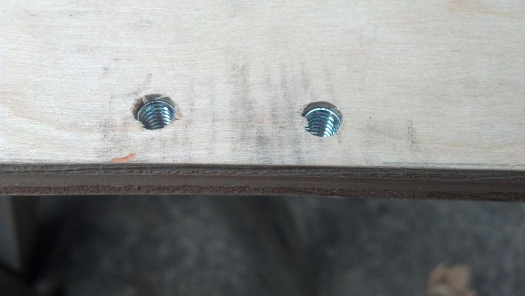

Started building a new rear deck for the hatch area. I wanted to raise it a little bit, so that I'd have more room for the amplifier, capacitor and power distribution block. Also, because I am planning to 'hang' all of this upside-down from the underside of the deck rather than plant it all on the hatch floor, I wanted a slightly beefier piece of wood.
1/2" birch plywood, vs oem 1/4" crap plywood. Using it as a template.
Countersunk fasteners.
Clear polyurethane coating to resist moisture.

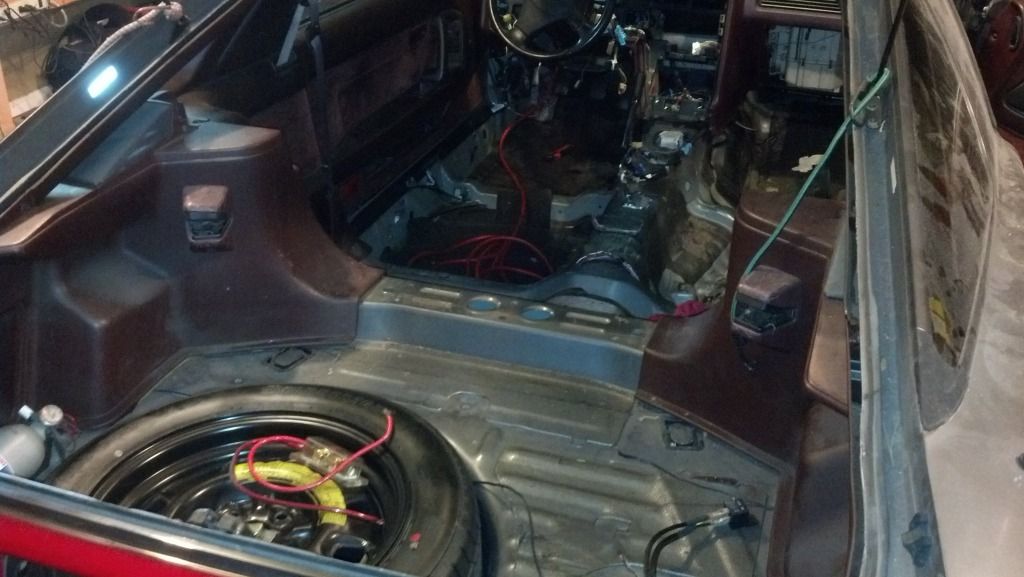

Also, I ran the 4 gauge power line to the hatch area:
It'll be a couple of days before I can finish work on either this, or the IC setup(waiting for parts). But I'll keep posting, if you guys keep reading.

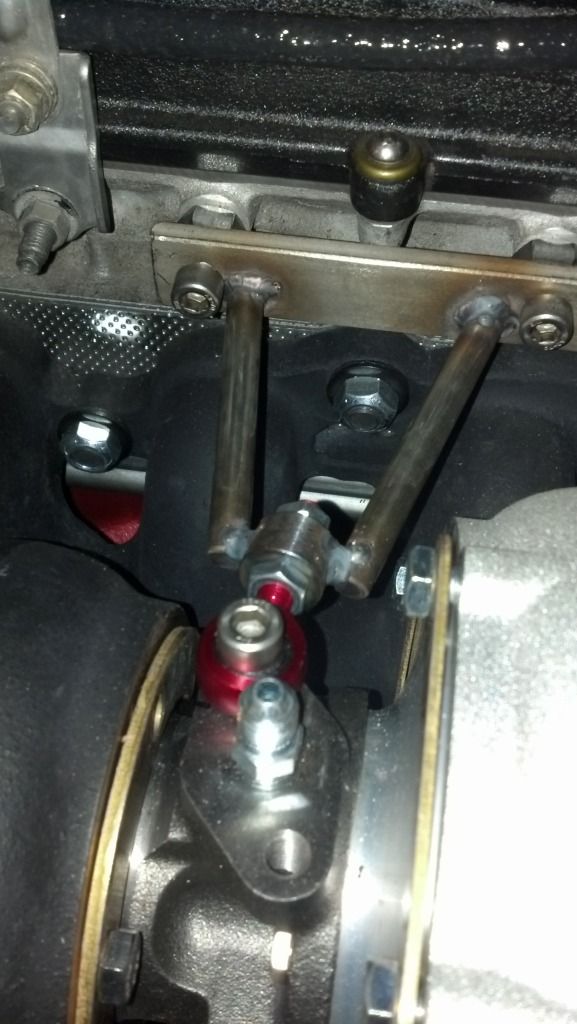

Picked up my upper turbo stay from the fab shop. Looks like it will do what I need it to.

Want to take some of the torque strain off of the exhaust manifold bolts. They're supporting a:
25lb manifold
20lb turbo
10lb downpipe
Fwd weight/ strain of the exhaust system
The stay will simply put a light upper tension on the turbo. Hopefully, it'll help with longevity.
