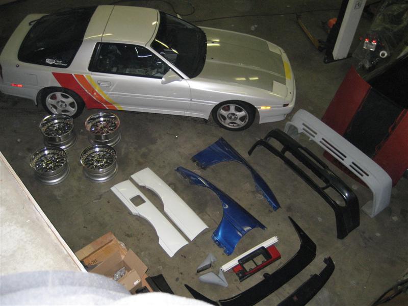

OK I have some update pics here, I will post the folder on my webpage with all the pics and I will just post up a few pics on the thread directly.

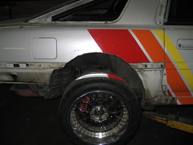

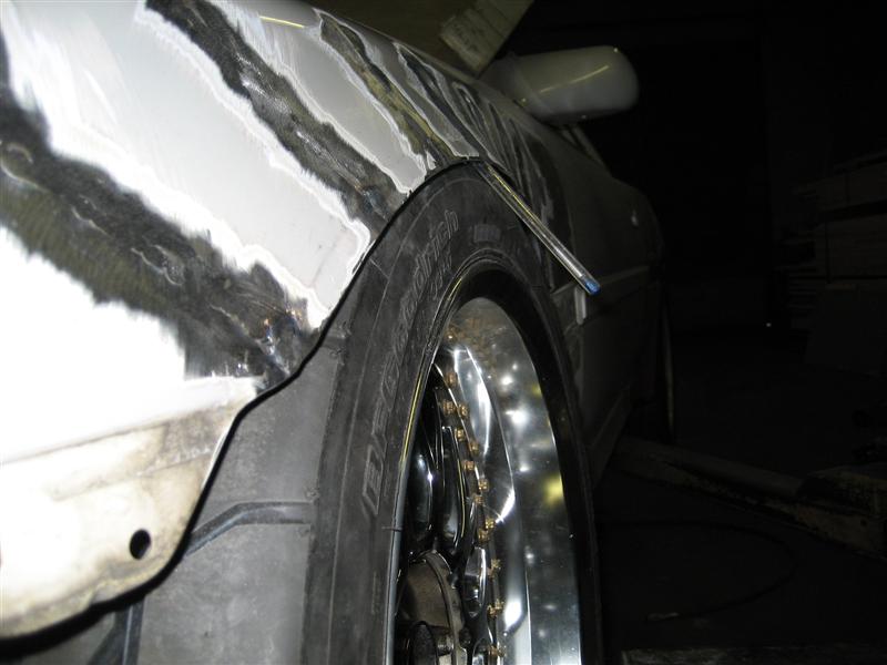

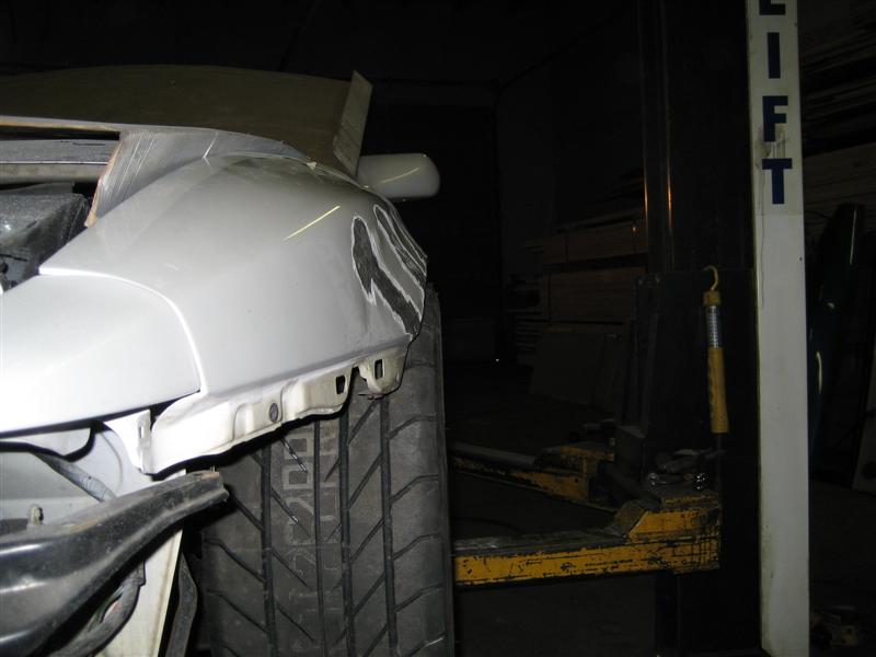

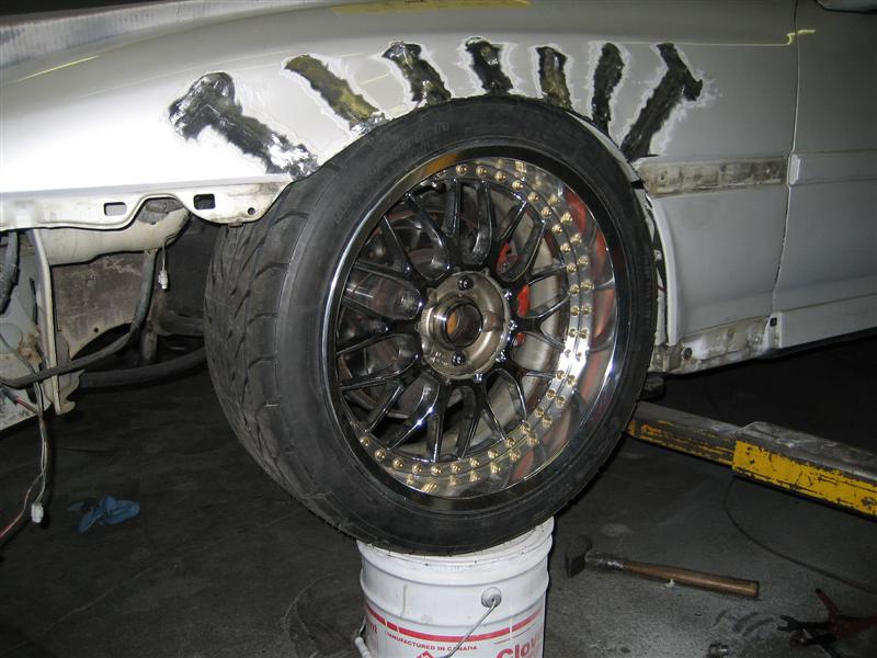

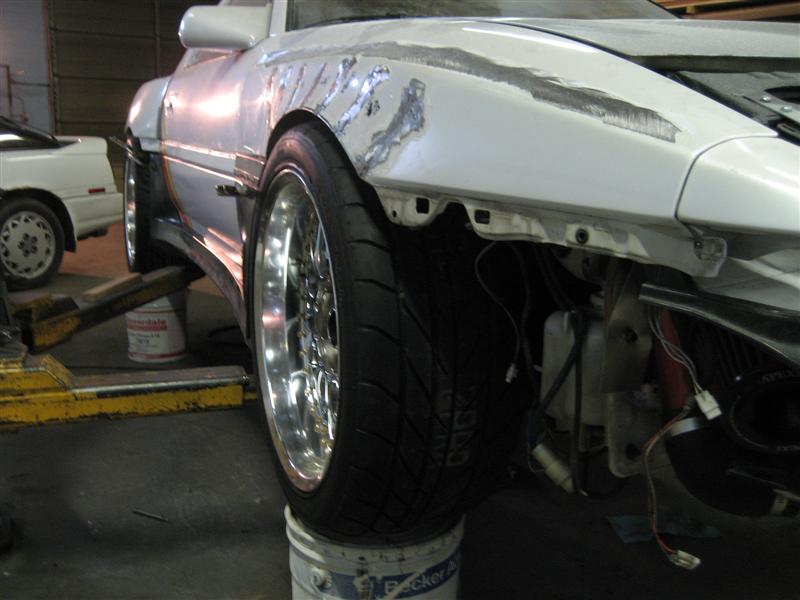

I have finnished widening and welding up the front fenders, they are about 1.5" wider than stock and the inner lipp of the fender has been rolled flat for an extra 1/2" of tire clearance. I have also trimmed about 1-2" off of the top of the rear fender openings to allow clearance of the tires. The outer fenders have been folded over and welded to the now trimmed inner fender. I hope to have the rear fiberglass fenders bonded to the quarter panels sometime this week, then the blending will begin.
The Bomex front bumper has had the IC/ turbo A style duct filled, and the small side vents are next to be filled. The rear Kaminari bumber need to be modified so the ends sit about 3" farther out to meet up with the widened rear fenders.
We also have some other trick stuff/ parts that has NEVER been done or installed on a mk3 before, I am forbidden to divulge any info but it looks amazing!!!

You have good taste my friend. And know how to extent the fenders properly. I cant wait to see it done. The overhead shot of the car and parts is sex. I love that pic. Think you'll have it done for suprafest '07

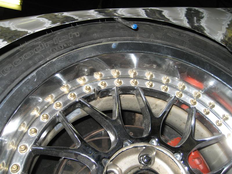

that is insane. on the pics showing the fender gap, am i forgetting something or will the tire rub like crazy if the springs are compressed?
becauseican
1,451
Vancouver
www.bicperformance.com
That pic is with the suspension compressed, the ride height wont be that low and the car is on Tien coilovers, so there isnt much wheel travel.

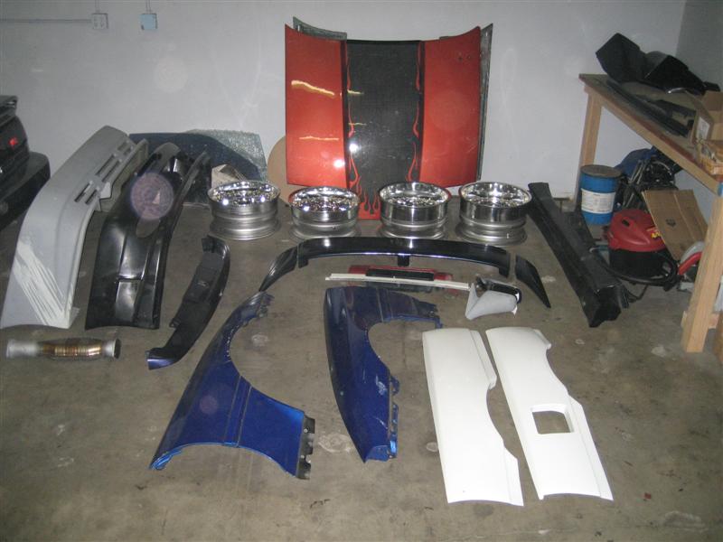

tekdeus said:
Sideskirts finally arrived from Germany. Today we did a rough mock-up with the body parts and the tires mounted. Every body part is made by a different manufacturer, so there will be a fair bit of mods and molding to be done still, but it will all flow together very well!
The front fender flare has been stretched and rolled, but Randy and I have agreed that the entire fender body will have to be cut at the long straight stock crease above the flare, and pulled out to match the shape of the rear fenders.
