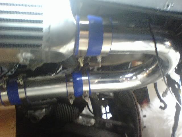

new 3inch intercooler pipes :icon_razz, now i also made a harness bar and ill try to get some pictures of that up soon, and im ordering a new areomtive external pump A1 and either 750cc or 1000cc injectors "RC" but going to go ahead and use my 550cc for the break in

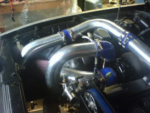

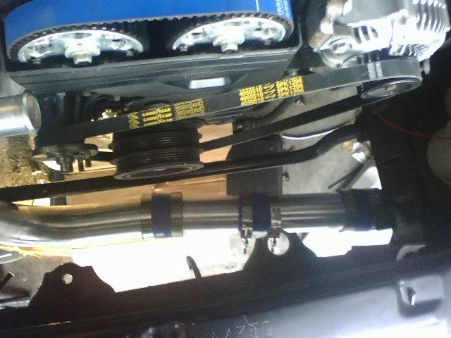

well pipes are going to be wrapped, but i had tried 3 different ways and all are near impossible, that has been the only way i found to fit it, that turbo is just so damn huge. so turbo will get a blanket and the upper pipe will have wrap. i mean im trying my best to keep it simple but nice but at the same time fit.

Here's an example of what TRD chose to do when confronted with reheating, already cooled charge air: http://www.turbosupras.com/images/Group%20A/Group%20A%20Engine%20Bay%206.jpg
Of course, there is the option of a FFIM, which I've thought of doing myself. In the meantime, I'm planning to take my charge pipe and have it ceramic coated w/a thermal barrier for $85, at FinishLine Coatings, in Milwaukie OR.
I already had both the turbine housing and exhaust manifold coated in a 2000 degree thermal barrier, as well as the down pipe and turbo elbow.

exactly what i was planning on doing, again that turbo is the major pain. the last guy i spoke with that has that same turbo says he spent almost 6000$ just to make the thing fit right, im not doing that, i've already spent almost 7000$ into the motor and interior and already out of money.

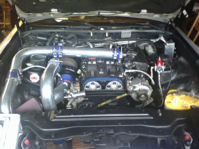

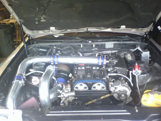

well if i could get away with this, and in a magical land of no heat produced by turbo world, i think it looks sexy :naughty: but im still going to attempt to leave it like that, just welded together and heat blanket for the turbo and some DEI intake wrap for the IC pipe, and then i already have header wrap for the new DP

Why the gt45 for 500rwhp?

Yea man, there is no way your boost prediction is remotely accurate.:icon_conf
If 500-600 is the ultimate goal a 61 trim would be ideal.
I would've suggested the GT35R....as well as a FFIM if your not going with a stock intercooler design.

The GT45 and 550cc injectors are not a match made in heaven. You either need a smaller turbo 61mm-63mm on 550's or larger injectors like 720's or higher with a turbo that large. Nice looking build though.

and the reason why i chose the gt45 is because i got it for 400$ and it came with the external wastegate. now starting to regret it.
as for injectors, yes i know i fucked up bad on that. but im getting the rc 750cc or maby 1000cc and a areomotive A1 external fuel pump

that's a bigass turbo...either sell it or plan to make waaaay more then 500

Should have sold the 45 and bought one that fits.
