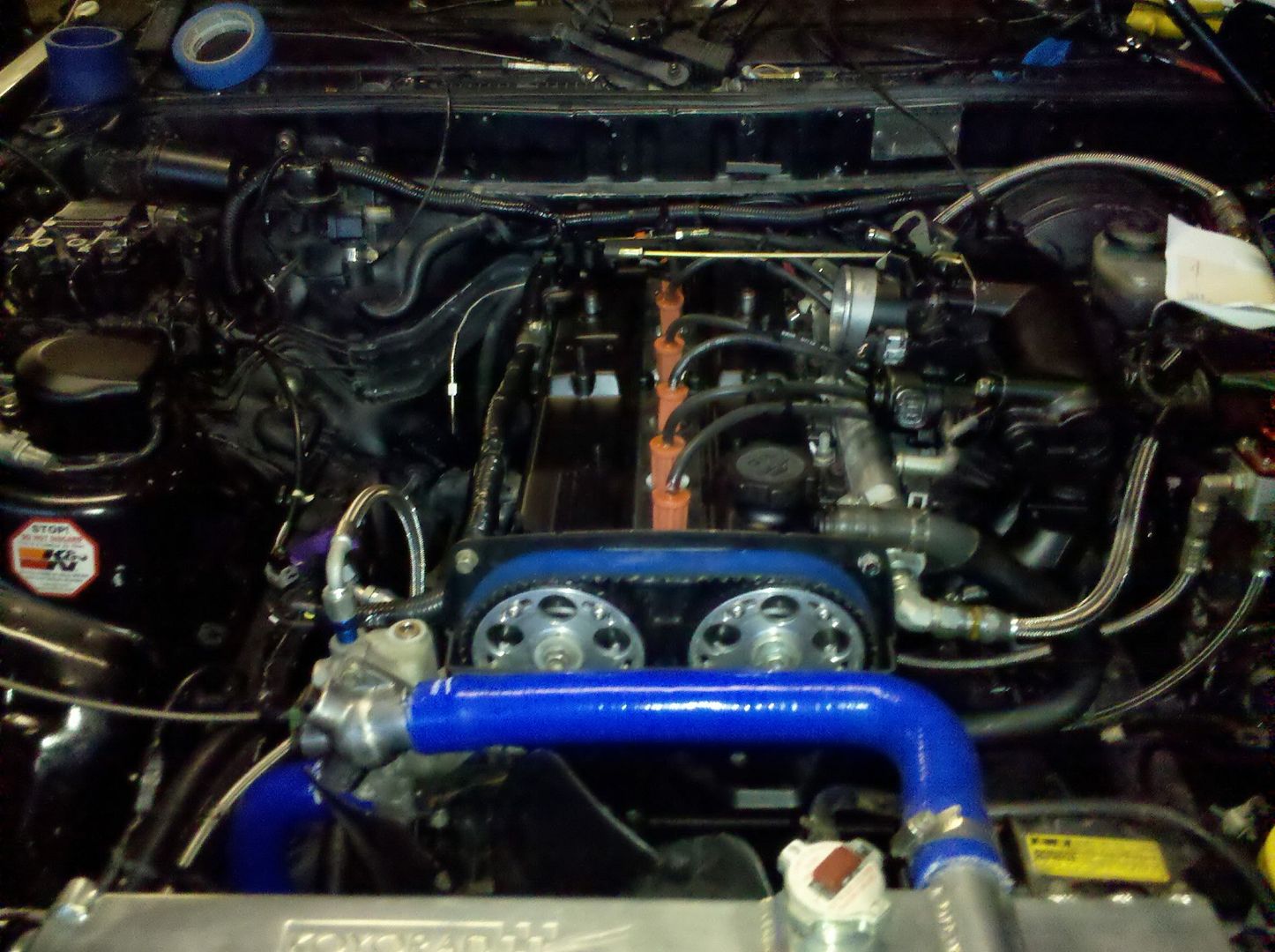

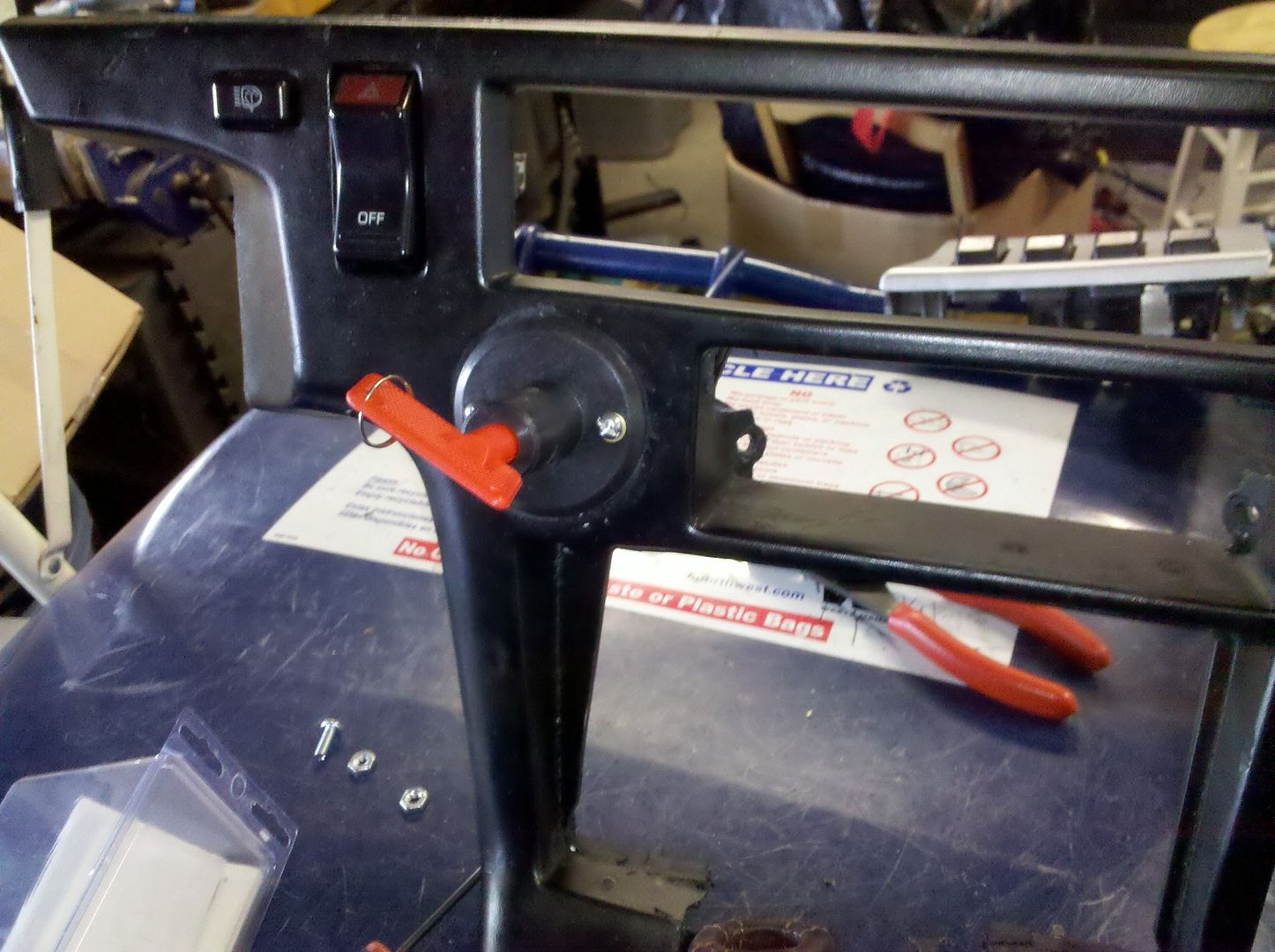

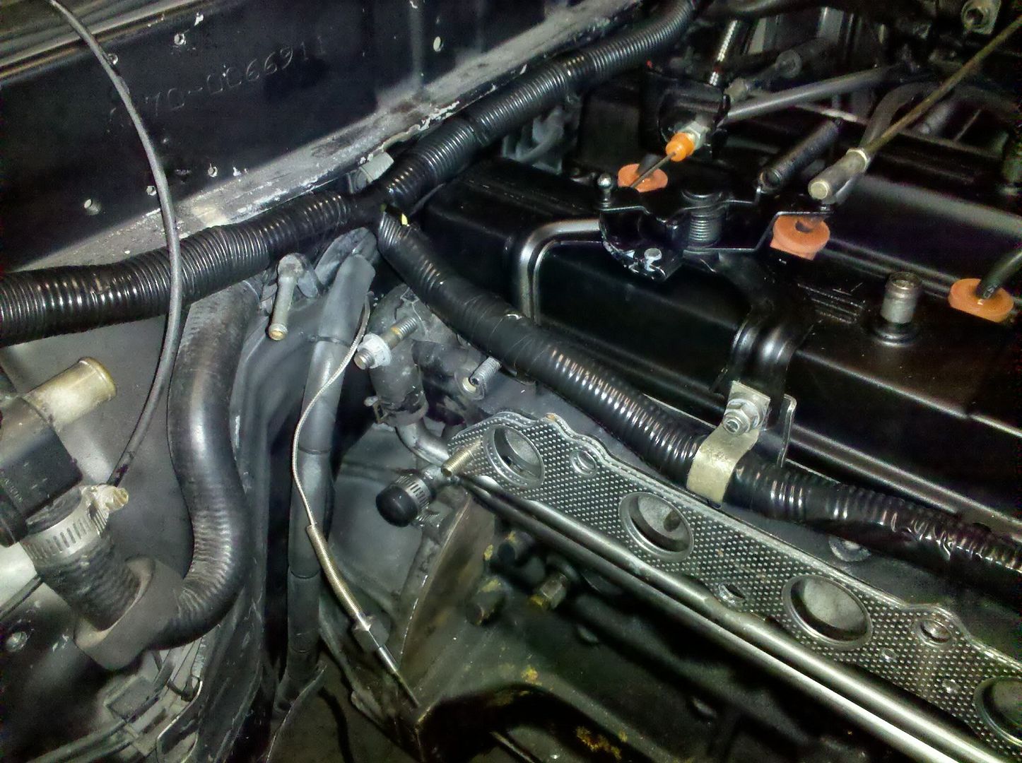

had alot of odd issues today, ECT reading 100c even when the sensor is disconnected, the ls2 coils firing causing either gauges to flicker or the EVC to turn on and off. good news is that the spark plugs all worked lol. I loomed the engine harness, installed the switch for the new fuse box that i installed that does all the aftermarket gear in the car.
PICTURES
tomorrow is get fuel pump and AFR input wired day.

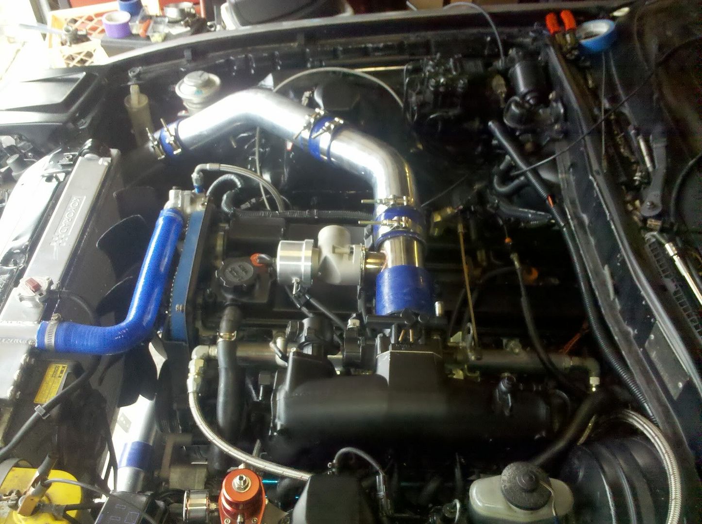

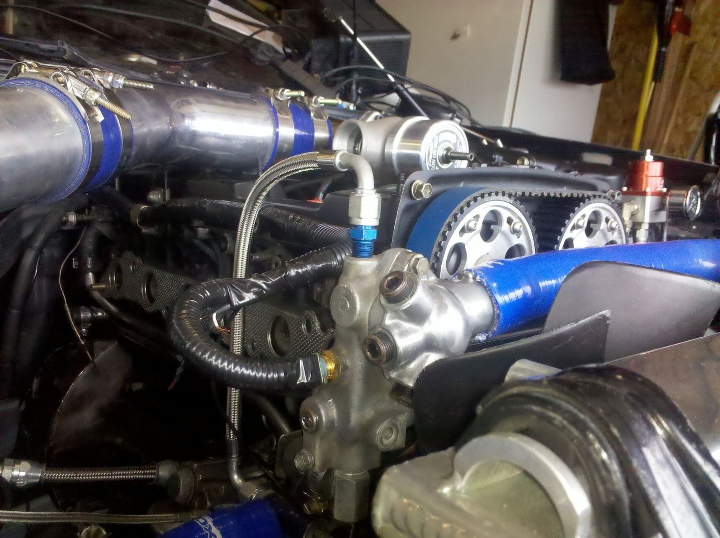

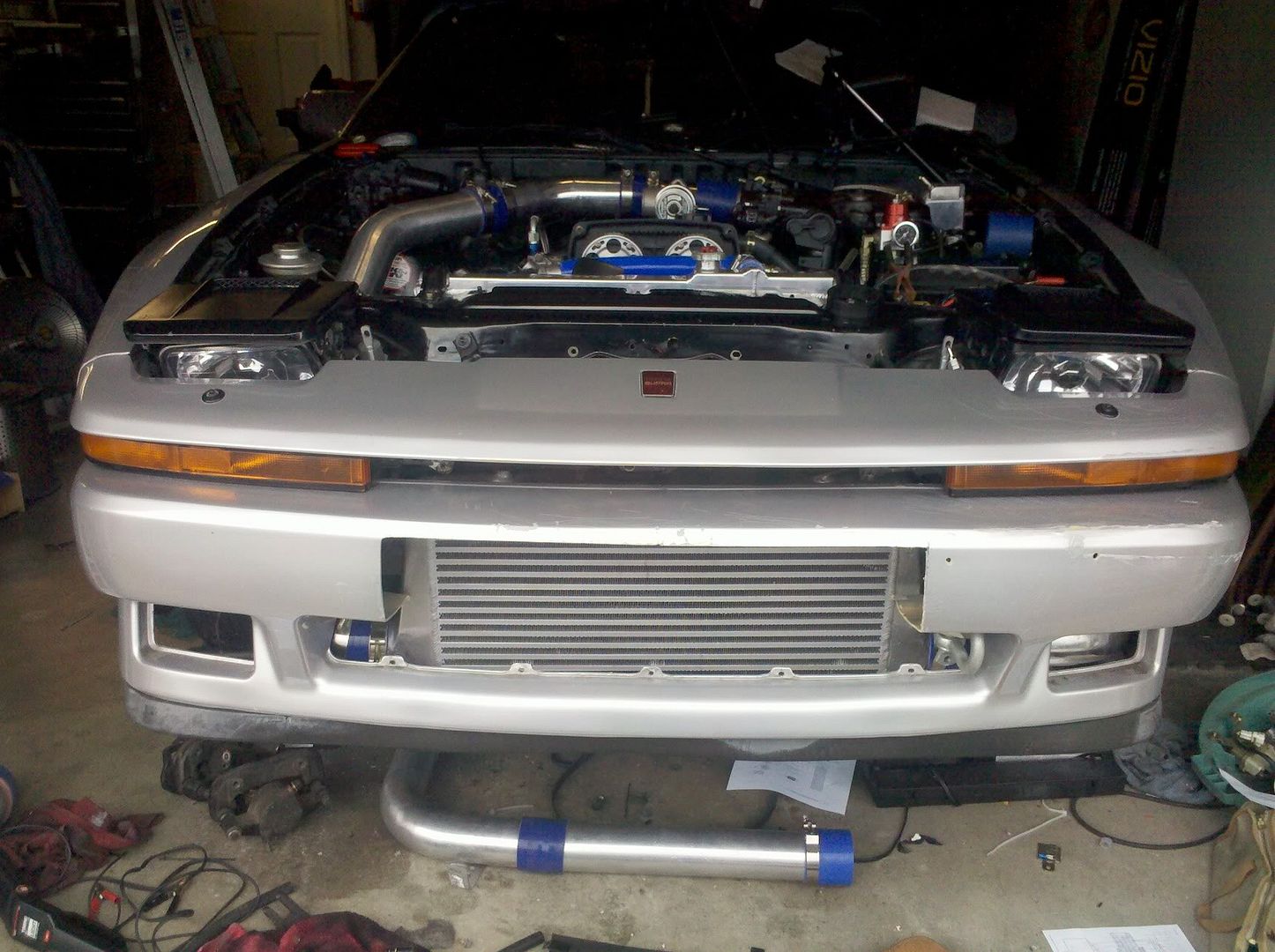

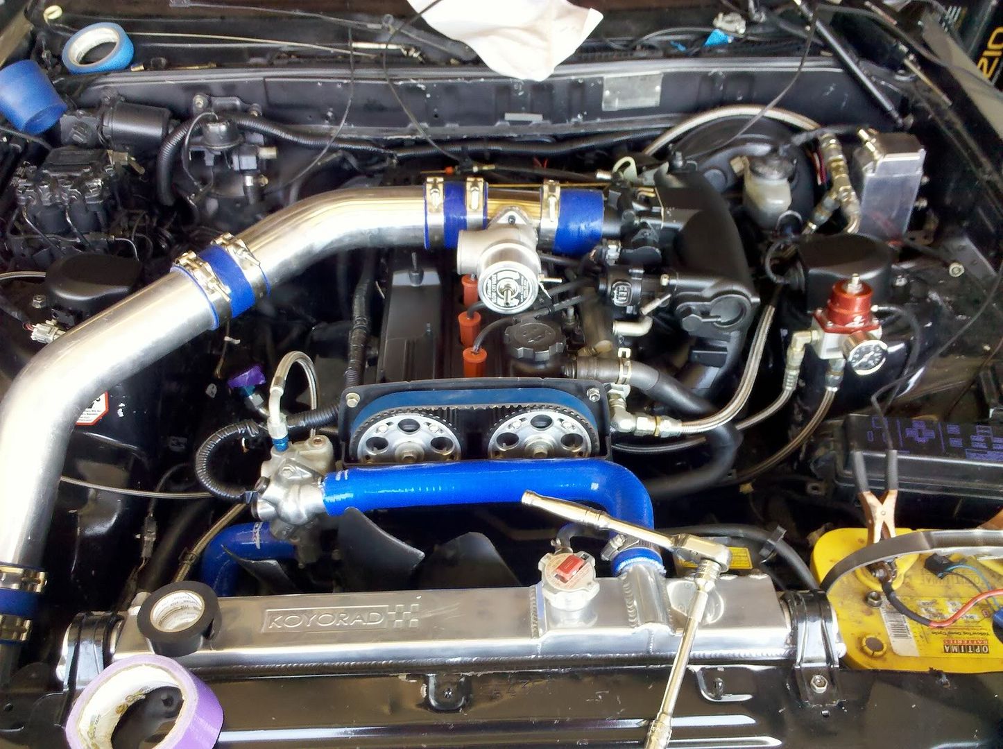

a better picture of the engine during the day
---------- Post added at 02:45 AM ---------- Previous post was at 02:43 AM ----------
the intercooler pipe was just placed in, was doing some aligning of the intercooler, got the fuel pump wired up to the stand alone and it worked great. Now i just gotta figure out these other little problems with the AFR gauge output and ECT issue
