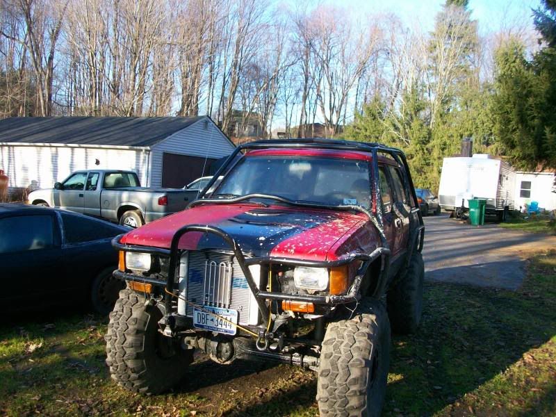

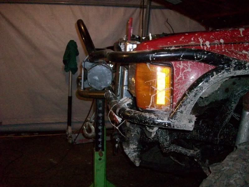

took the truck on a shake down run in our local wheeling compound. started to mount my winch.
back of winch is about 2in from power steering cooler.
