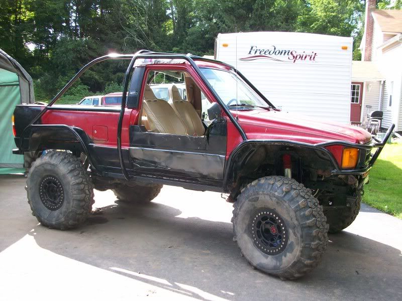

this is what my 7m is going into.
rock crawler i hate mud because i work on my own truck lol 5.29s on 38s with 30 spline longs in front, fully locked and 4.7 Tcase duals with a rear 23spline this winter. it works ok but more power would be nice.

Hot damn! That's a totally badass 'Runner! I'm not a big mud fan either, but I do play around every so often when I find someplace fun. What SAS kit (if any) is that? I'm totally diggin' the exocage too. I don't plan on going any larger than 33x10.5's as the pickup is my wintertime DD. I just picked up a tru-trac rear for it, as I don't want to lock the rear (e-locker or ARB) until I SAS the front- then the tru-trac will go up front for snow driving.

i built all the SAS brackets my self. we mostly go out of state to rausch creek to wheel. your better off with a selectable locker in the front and somthing like a detroit in the rear. my rear is welded and lockright in the front. the lockright limits steering on the dirt alot. in the snow i dont even lock the front hubs unless im aired down to about 3-5psi.
