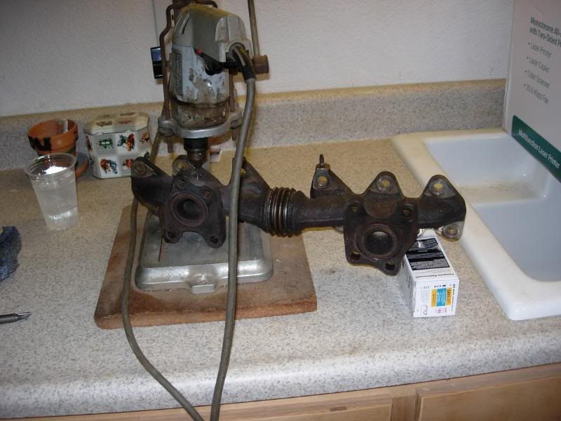

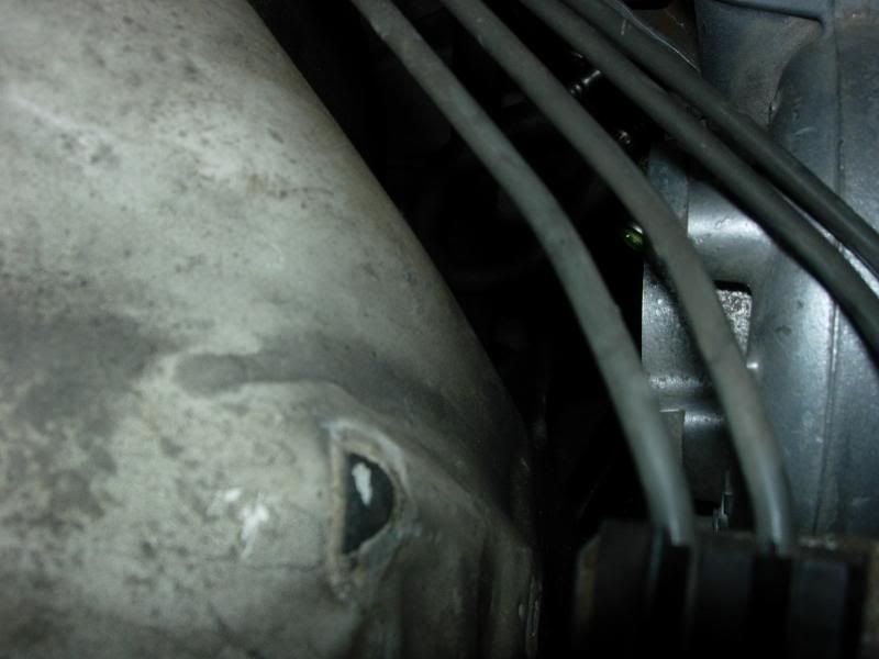

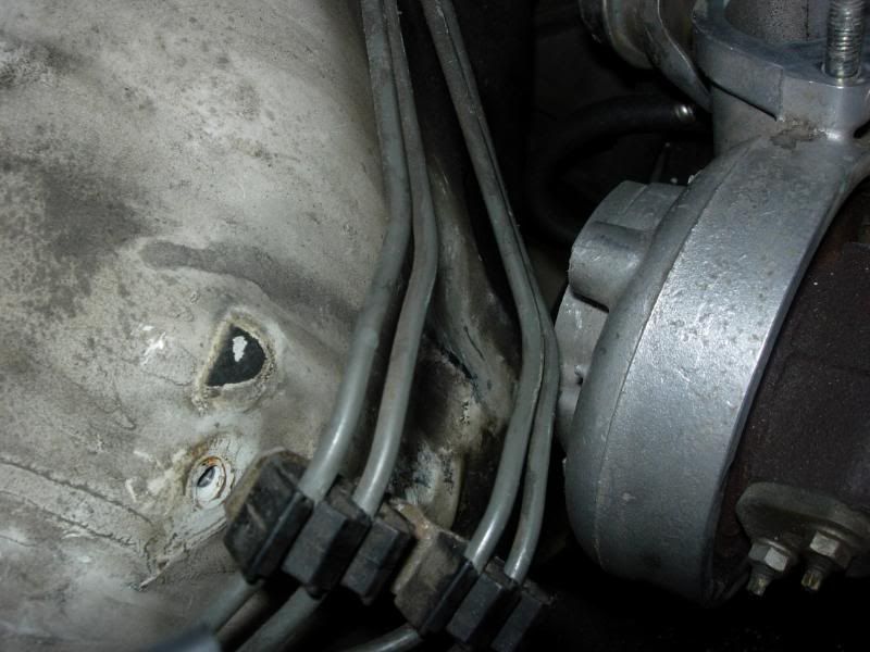

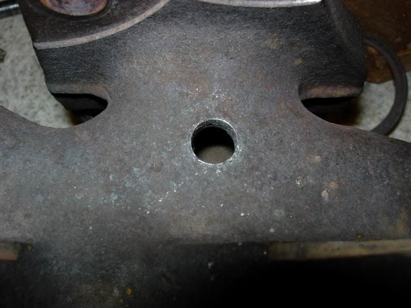

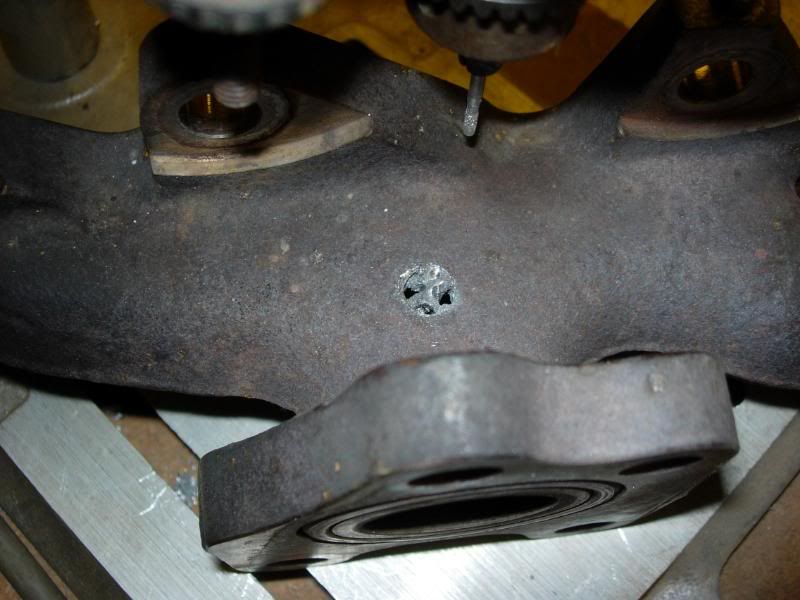

I found a diamond grinder at Sears and after about an hour, no joke, I finally cut the damned thing out. I gave up on tapping it so I cleaned up the hole with a larger bit and used JB weld to put the bung on there. I'll be attempting to begin the turbo swap tomorrow.

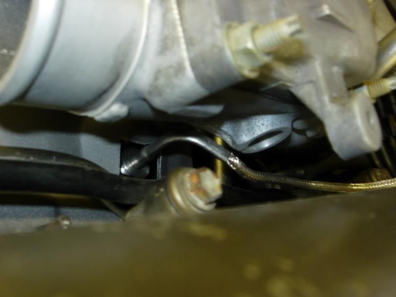

Still working on the plumbing... The clown who pulled these turbos before I bought them seriously jacked up the front turbo oil feed line, and it took literally hours of fussing with test fittings and bending before getting the banjo bolt to line up and thread into the block. Now that I'm past that part, I should be on to the easy stuff.

Pics time!

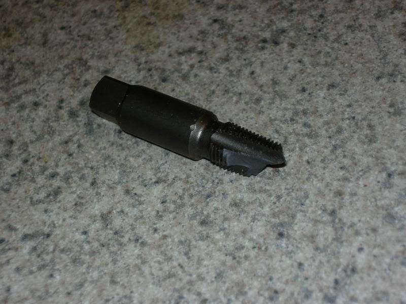

Broke the stupid tap off in the exhaust manifold and spent 2 hours grinding it out... :icon_evil
JB-WELD is awesome!

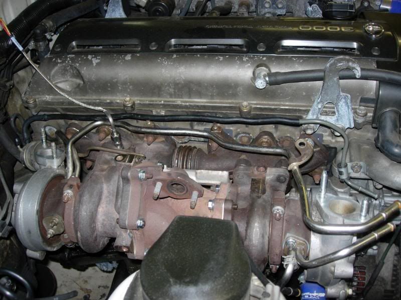

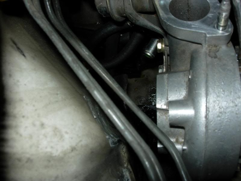

Beginning the swap: T04R still installed.
No more T04R.
It's so dirty! :(
The oil return line was leaking, so I have some extra cleaning to do.

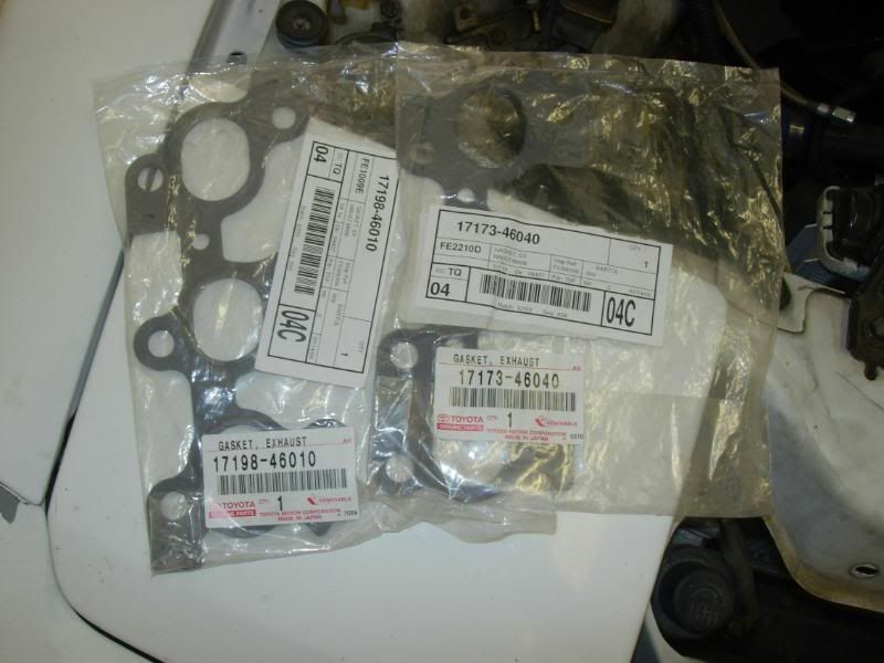

Only the best from Toyota!

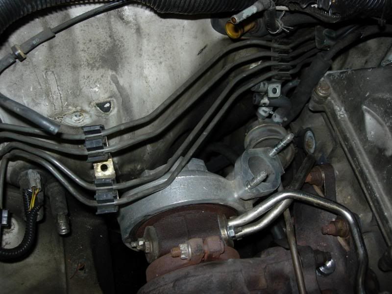

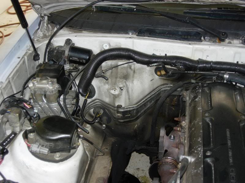

Had to yank the stock chacoal canister as it would interfere with the rear turbo.
Looks like I need to do some pounding... :(
After pounding:

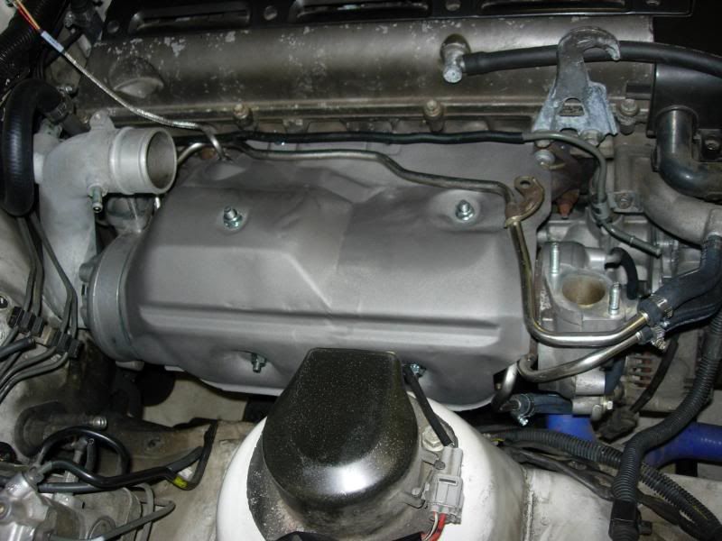

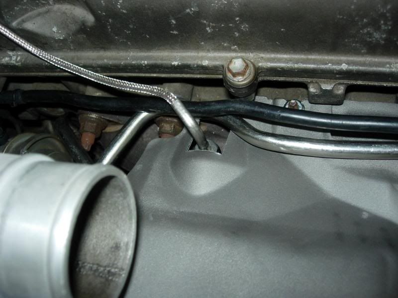

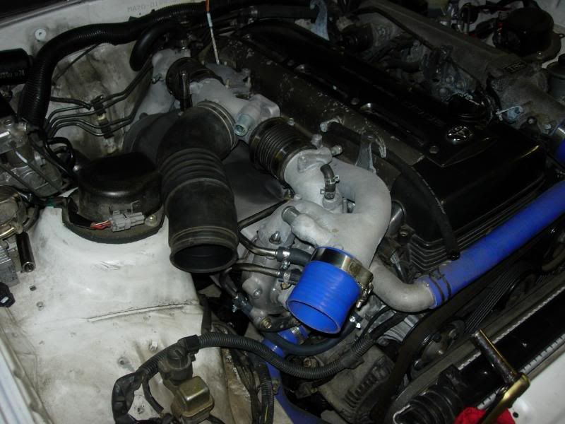

Used a shorter stud laying around that wouldn't interfere with the EGT probe:
Custom hard line to the rear turbo wastegate. It's ugly, but it gets the job done. You won't be able to see it when I'm done anyways.
Heat shield installed, freshly mainted with new hardware that won't rust and seize.
Cutout for the EGT probe.

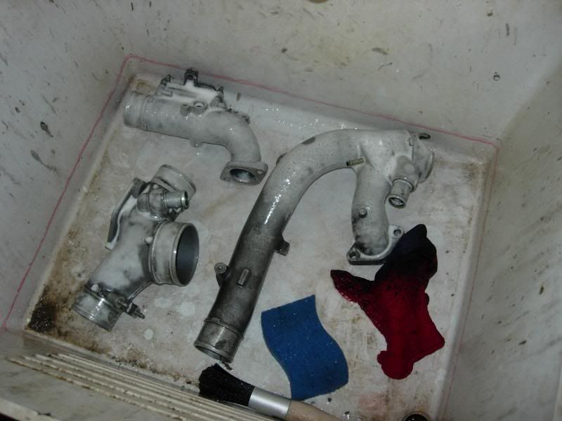

Hmmm, see how clean it is?

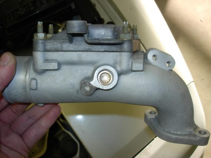

And this is how: Etching mag cleaner. Dissolves the stained outer layer and removes corrosion and oxidation.

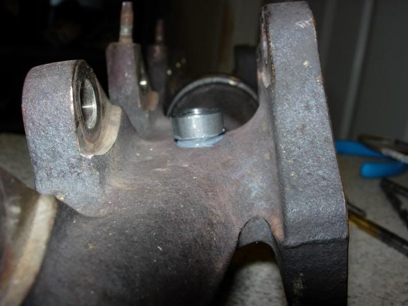

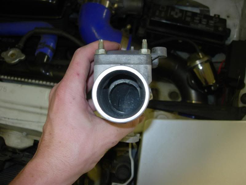

Here's the rear turbo outlet pipe, all clean with the guts removed. I drilled out the hole and plugged it with a 1/2" freeze plug. I don't have pics but I used the same method and the same 1/2" plugs on the exhaust y-pipe.
And this is why I had to do a little grinding:

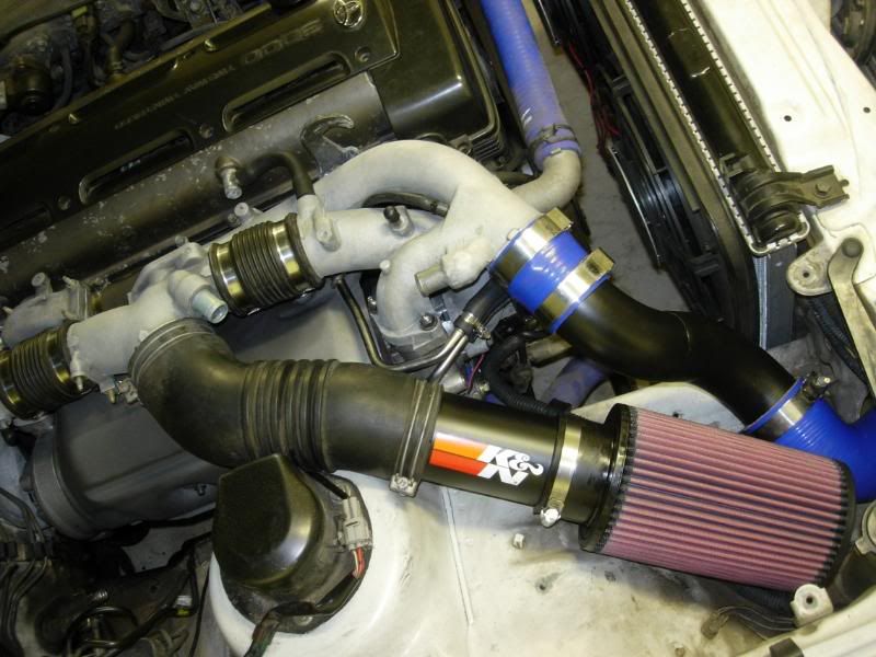

All pipes cleaned and installed. It's coming together!
And there you have it!
It needs caps for the stock bypass valve and an ISC hose and the intake side is done. The downpipe is getting made this evening, and it should be back on the road!

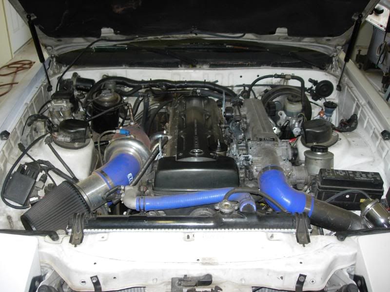

I agree. Twins with all the stock plumbing, heat shields, and other factory stuff look very clean, high-tech, and sophisticated, which is neat because so was the MKIII in it's age. They just seem to fit well together. Single setups seem to always have one or two points that are obviously not stock and, while not neccessarily tacky, definately out of place and awkward. Yeah, my single setup was nice, but the tubular manifold and massive intake pipe were out of place and stuck out like a sore thumb. That being said, I wouldn't mind having this under my hood:
However since I'm obviously not made of money and my goals lead me in a different direction, that won't be happening. Unless of course I win the lottery and can afford a turbo that large that still spools as fast as stock twins. :)
Speaking of spool, I drove the car tonight and at the max of 15psi that I hit tonight, it pulled hard! However, due to a exhaust leak, the rear turbo doesn't really spool until around 5K rpms, so everything is coming back apart! :3d_frown: It's hard to judge because it's so different, but my ass dyno wants to say that it pulled harder than my previous setup at 14psi which isn't bad for these little turbos. Once I've got both turbos spooling and can turn up the boost, it's going to be real fun. I'm looking forward to dynoing it.
