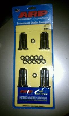

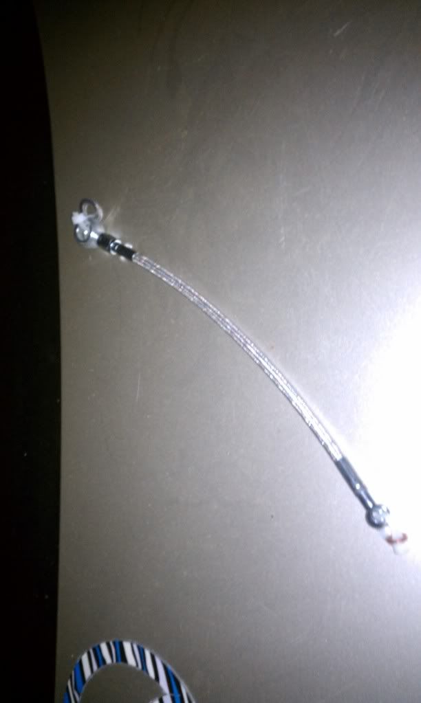

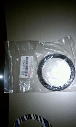

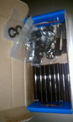

Ok Today I received a order from drift-motion, I ordered ARP Mains, and Rod caps. Figured they would make some of you happy. Also a SS Cold Start Injector Line, and a new rear main seal. Currently my head is also at the machine shop, they offered to take pictures for me while the work was being done. Sometime next week ill be taking my block back to a machine shop to have it re-decked, with ARP hardware. After that, ill be ordering a metal head gasket, after they tell me which one to get. Then I have to order a few more seals, (front main, oil drift-shaft seal). Then it will be all about reassembly and getting it started.
ARP rod bolts
ARP Main bolts, and caps
new rear main seal
New SS CSI Line

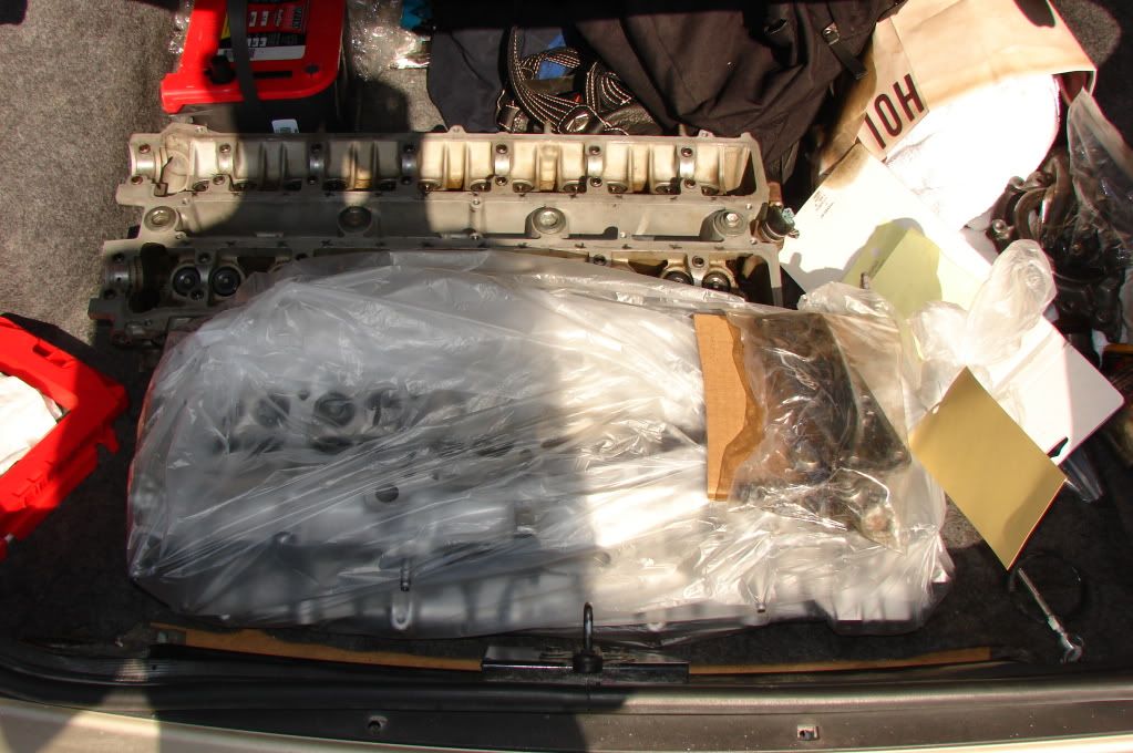

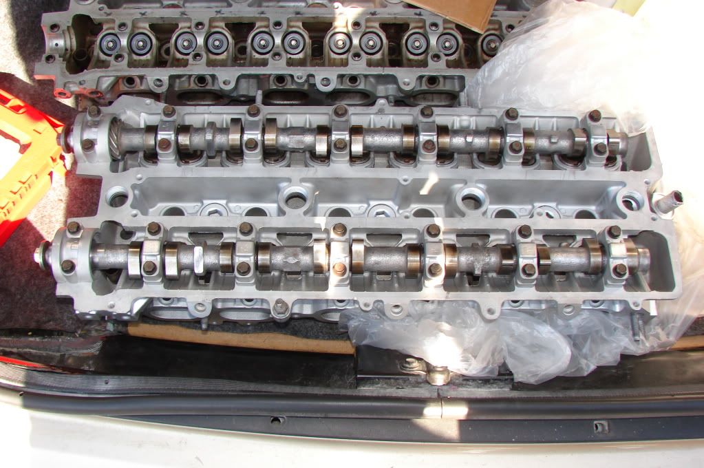

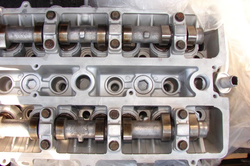

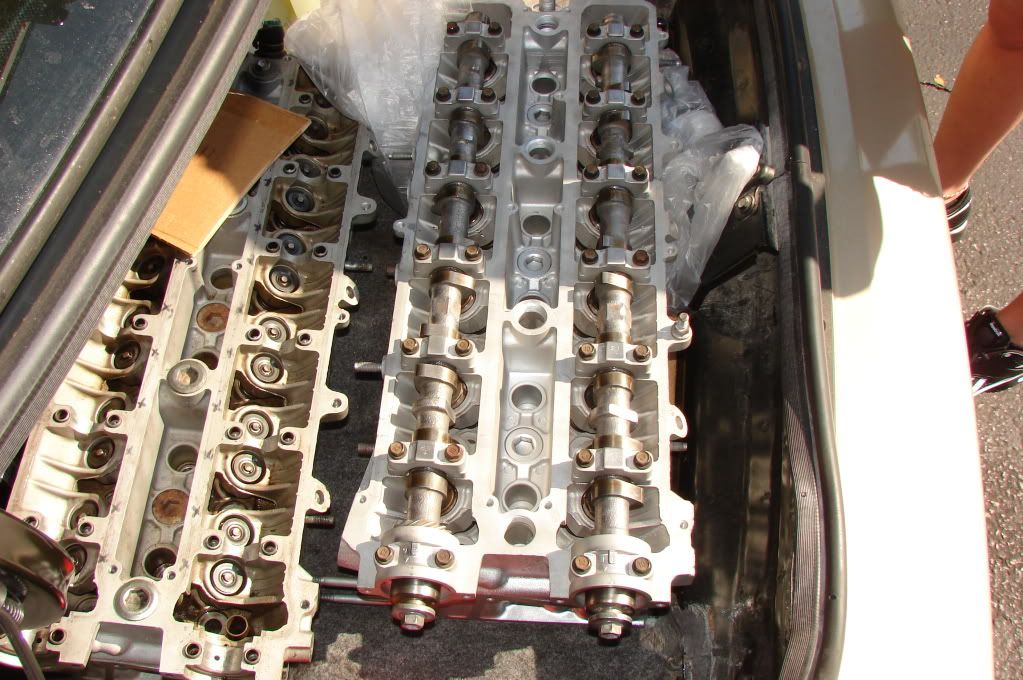

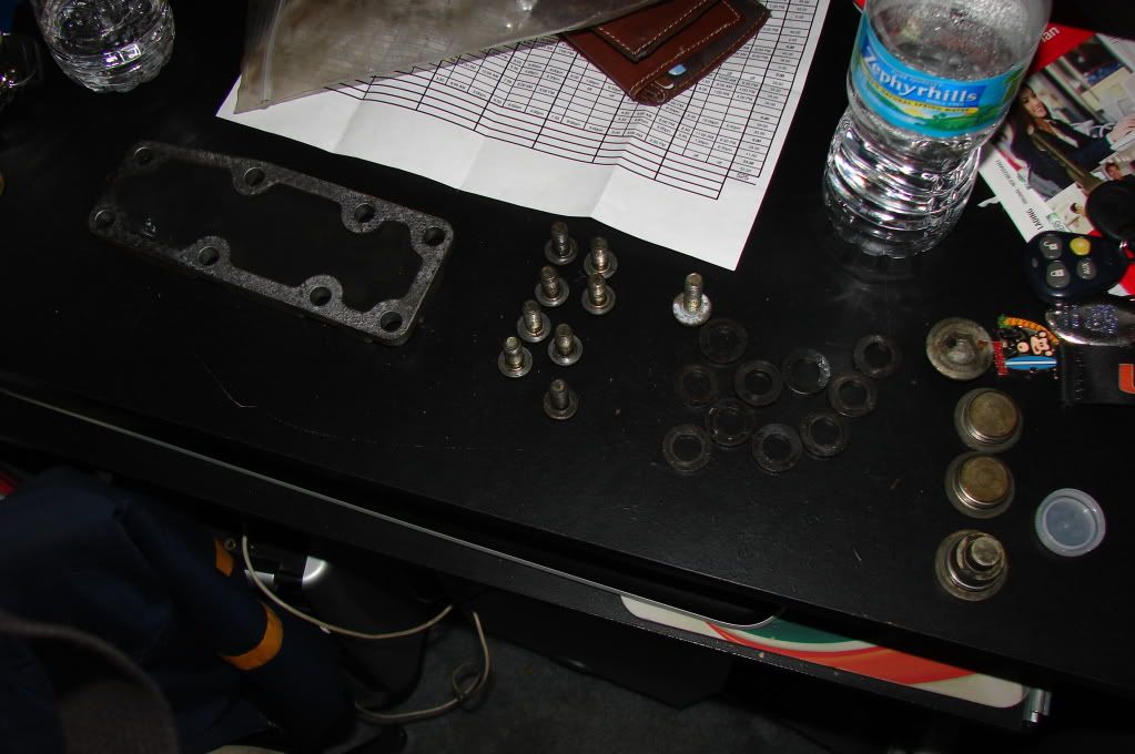

OK I gave them a call, and they informed me that the a-line bore was needed. Which I was probably thinking it was going to be needed, with the new ARP mains. So thats being done currently. I have .020 over NPR pistons & steel rings, clevite bearing set (mains, rods, thrust), in the mail. So the machine shop is currently on hold till I get the pistons in the mail from drift-motion. But I took the head to a machine shop and got it back today. So heres a few pics of the head when I got it, and the hardware they took off to get it all clean. I also had them take pictures of the head while they were working on it. But I wont have those till the get put on a disk for me.
My main head and a spare.
Spare nuts and bolts, and the EGR cooler plate.

IBoughtASupra;1683348 said:
Hope he says there is a box or pieces of wood on the ends....
Well I had folded up pieces of card board on each end while I took the pics so it was sorta floating in the air, then I turned it back over. Its funny cause you can read 7M on all the valves now.
IBoughtASupra
Mar 10, 2009
4,455
Queens, NY
The only way to store any head is to turn it over with the valves facing up. You can store it sitting on the valves side if they are no cams installed.
