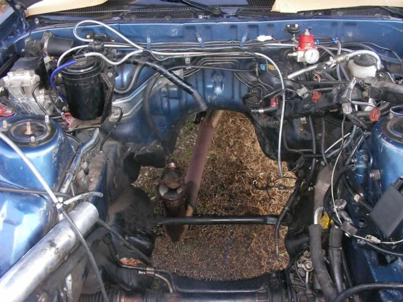

55
We got just about everything out that can come out. We still need to undo the motormounts and tranny mounts, but we don't have a cherry picker. Ricky's brother broke their's earlier today. I've got a trip planned to Harbor freight in the morning, and I think I'm going to go ahead and buy me a welder for two hundred dollars so I can do my own exhaust and maybe even work on my intercooler pipes. It is suppose to weld mild steel, stainless and aluminum. It's a mig welder, but now I have to get 220 volts out to the dungeon somehow. Just one more thing to add to the list of things to do. I really appreciate all of the well wishes and good luck, and Joe is even willing to cross his nuts..........:biglaugh:

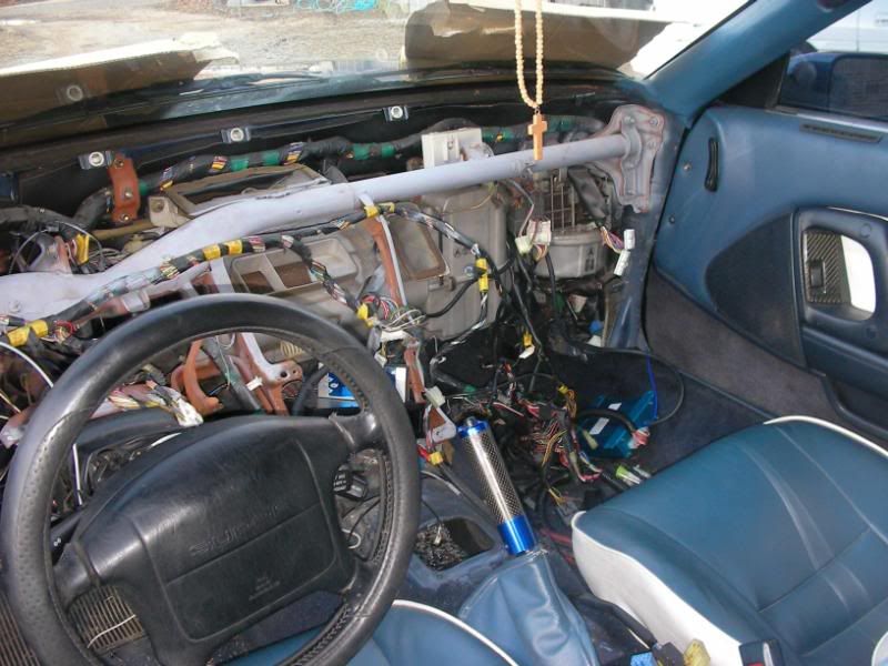

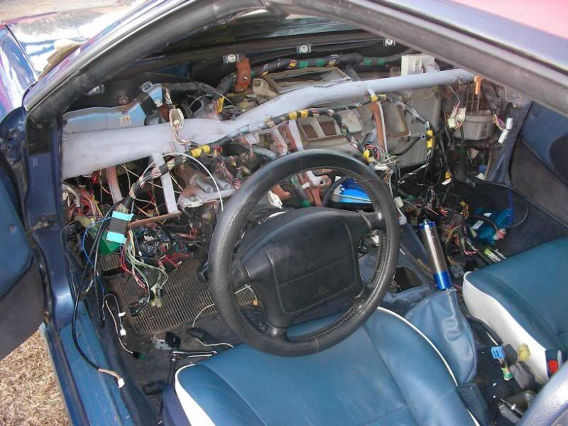

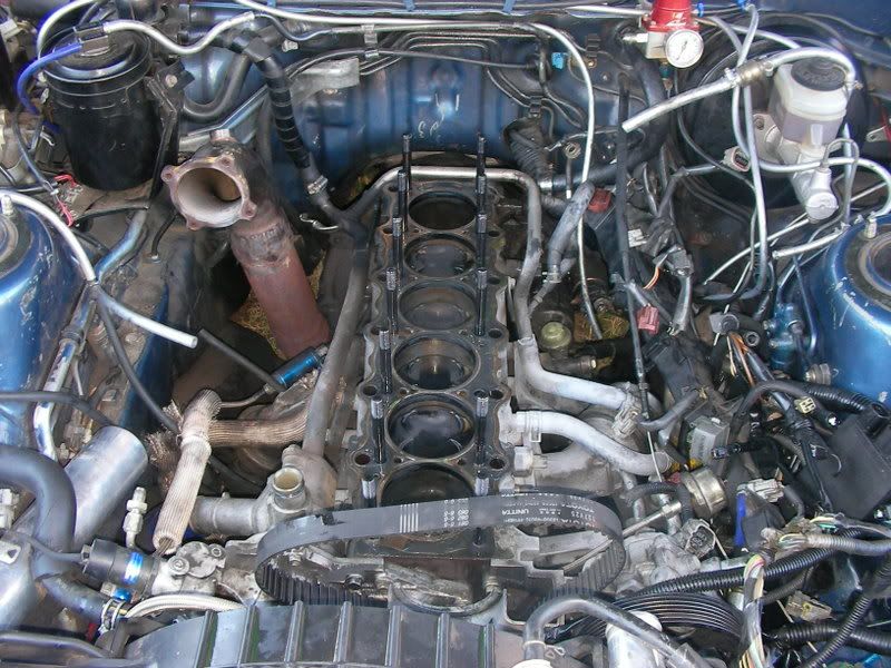

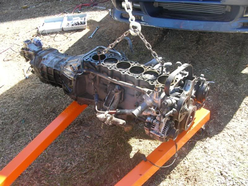

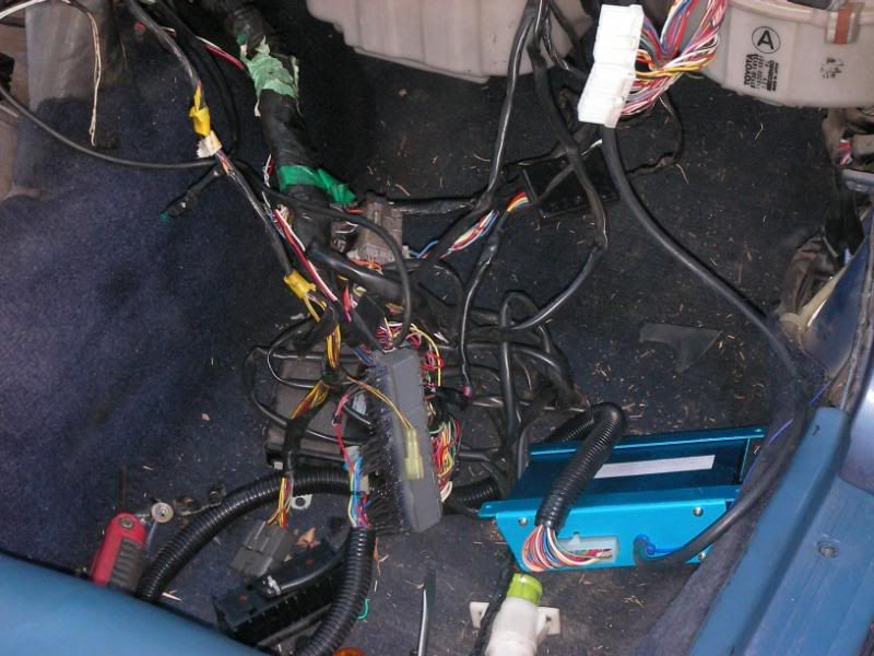

O.K. here are some pictures of the car as she sits right now, but I must warn you it isn't pretty at all. In fact it's kinda scarey to think of all the work ahead of me, but I'm remaining positive that I can get it all done before the beginning of March, That will still give me plenty of time to get it broke in and tuned. On with the pics.
Here is a picture of how the block sat this morning.
Here's how the engine bay looks as of this afternoon.
Here's the block and tranny being held by my new cherry picker.
Here are a few of the inside of the car. This isn't as scary to me as it was the first time around.....:aigo:
That's all the pictures I took today. I was hoping to get the dash back in tonight, but for some reason the dam'd thing keeps spotting and won't paint correctly. I'm going to sand it all down again tomorrow and start over. Hopefully I'll get it looking good and can get it installed. I'll sleep a lot better once the wiring is all hooked back up.

Yay for progress!!!! :boobies: :boobies: :boobies:
Stay positive, and I'm sure you'll get it all done... Maybe even a day or 2 early :)

boy jay it must be hard to pull the motor and trans together without a leveler bolted to it.:crazy1:
