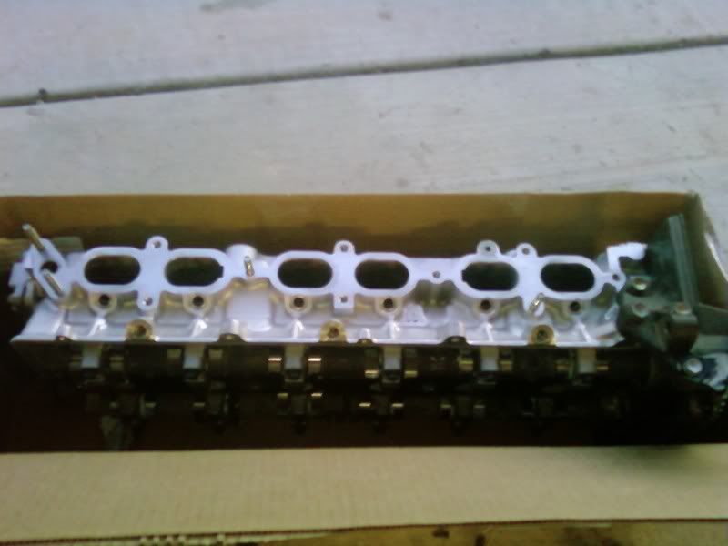

The machine shop called a little while ago.
They pressure tested the head---no cracks
It is warped by 6 thousanths (??) so it will be resurfaced for sure.
They did some kind of vacuum test on the valves and 4 of them did not do so well. I don't know if it's just on one cylinder but they are going to reseat those four valves. He said it could just be the amount of carbon built up on them and that it would actually be just fine the way it is but I told them to fix 'em. He said after that, that this head should be fine for a long time.
They are also going to clean it up real good for me. It should be ready tomorrow afternoon. Hopefully this weekend I can have it all put back together and ready to drop in. Have to wait on some parts from Elmhurst Toyota still though. Curt is very quick at shipping so maybe tomorrow I should have them (hoses).

Today I picked up my head. It's nice and shiny and Poodles, it has new valve stem seals all around. They cleaned it up very nicely.
It's the only picture I've got for now.

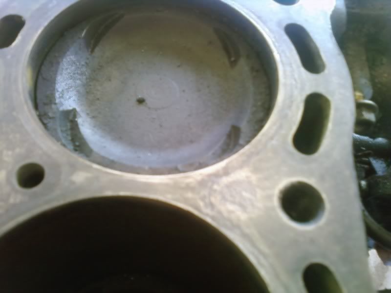

Also today while I was cleaning the block a little more I was able to see the amount of pitting around and between cylinders one and two. To be honest it scares me that with even a stock HG it is not going to seal good. Damn I wished I had more time....and money to have a short block rebuild done on it.
I did put the HG down on it after cleaning some more and it looks like it might be ok. I don't know. I cleaned the deck and pistons good with carb cleaner. I used a 3M pad to help. I've just got to say 'fuck it' and believe it'll be ok.

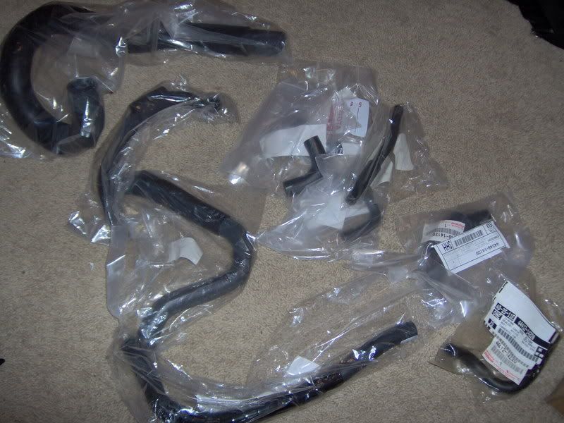

Got home today to find a box of goodies.
$200 worth of OEM hoses.

Damn, should have gone with samco radiator hoses :D

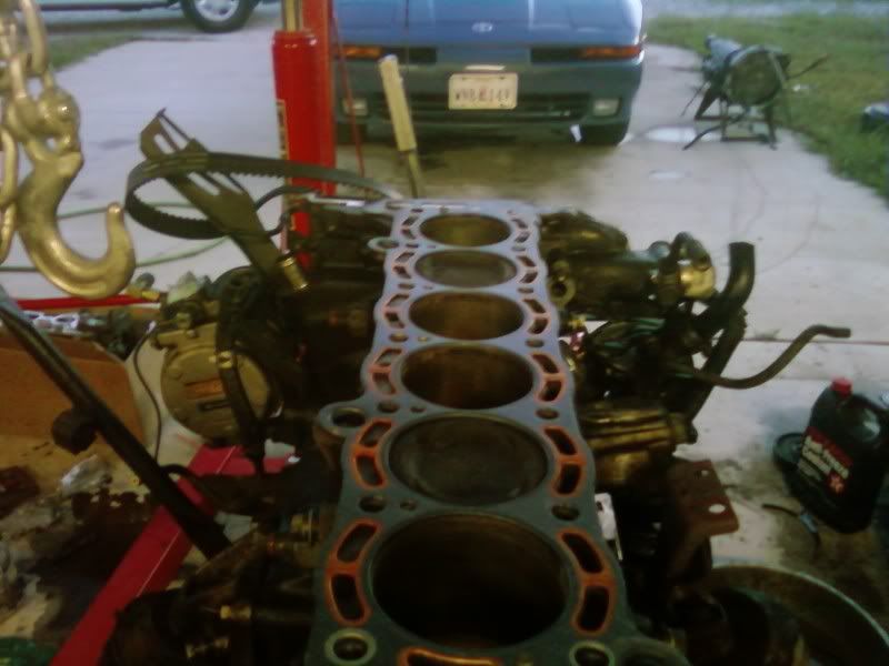

Ken I will assist with both male and female points of view to this picture.
Male-
Sweet Ken I am glad to see it coming together. That is one fancy ass trans stand you have next to your car. Looks like you didnt have all the fluid out of the trans when you pulled the motor. I feal your pain, it seems like you can never get all of that out and you always have some leak out everytime you pull an engine. Wow the cylinders and the deck look great. LOL at your Texaco antifreeze!! Its great to have extra antifreeze around since you do own a 7M supra.:sarcasm: Looks like the machine shop gave you a handy box to keep your head in. I really hate when you get things back from the machine shop and all they give you is your parts in a stupid bag.
Female-
Ken you Dumbass!! We are trying to sell this god damn house and you have you stupid ass car in the driveway with no motor and some stupid part of the car still sitting next to it in the driveway. Cant you at least bring that inside so the neighbors do think we live in Alabama. And whats with that red looking fliud all over the ground in our driveway. That had better come clean you know we are trying to sell this house right. Dont even get me started on the garage!! Why is it never clean?? Ah screw it I cant handle it anymore. And dont think you are getting any tonight cause your not until you get all your Supra crap cleaned up and get serious about our future.
:biglaugh:
gtsfirefighter
SM Expert on White trash
Sep 26, 2006
2,965
55
Male-
Texaco antifreeze jug is full of oil. I did drain all the tranny fluid. What you see in that picture is water from washing off the degreaser on the tranny so it will be pretty and clean. I did spill degreaser all over the floor of the garage, which you can see in the picture of the deck and HG. There is no room anywhere in the garage for the tranny. I have to step over things just to get around in there.:aigo:
