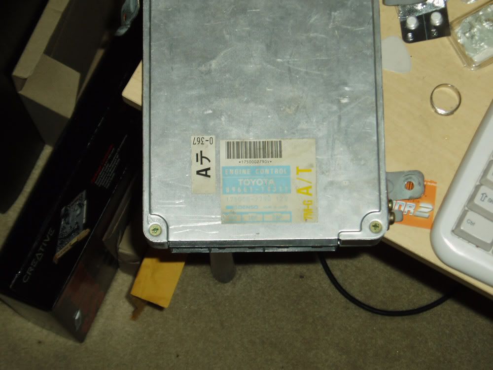

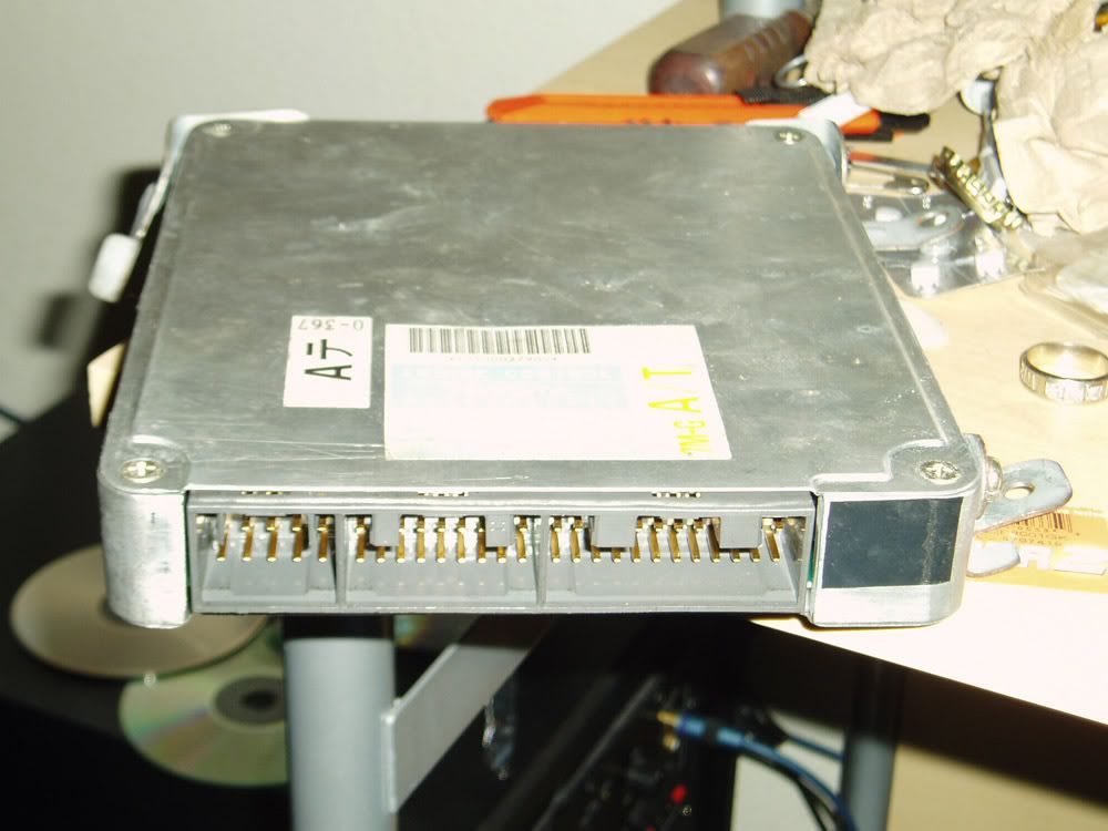

JustAnotherVictim
Violently torn lol.
I think Oklahoma probably sucks haha.
This is it. Pretty sure it should hook up to yours.
Like I said the last time I used it, it was working so It should be fine.
I guess once the temps get up enough to go outside I could double check so you don't pay for a dud. I'm using the 87 manual right now but it was working with the 88 auto last time I used it.
In case you can't read the numbering. Pretty sure the n/a's hook up the same.
89661-14311
175000-2790
10P-18P-24P

Is that the engine ECU or just the Transmission ECU? Nevermind - the "Engine Control" gave it away! I'll have a look at my loom tonight and let you know.
